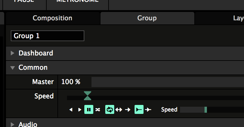

Is your group or composition speed set to be 0 by any chance?
You can reset them to default by right clicking on them.

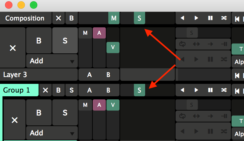

Grimm90 wrote: Thu Mar 07, 2019 22:56 +1 for the feature request list . A disable master & group speeds option.
try this ;)
Speed param animated to timeline, paused, and set the start and end points to 1.
Now you can move the fader on the group anywhere, the clips will play at nominal speed.
