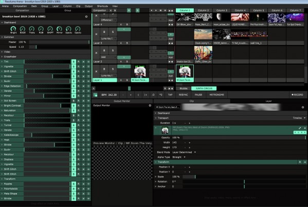

Ever since upgrading to resolume 6, I can no longer use h264 MOV's or PNG files.
They load into the software, with the thumbnail visible, but they will not preview in the preview monitor/output monitor
I have tried loading the same files into Resolume 5 and they work fine. It's nothing to do with layer effects/controls I don't think because other clips in the same layer load fine.
What is going on? This a HUGE HEADACHE

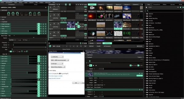

Actually, after I started using resolume again, everything works fine until...
Until I plug in an actual output via hdmi or displayport
I tried multiple different devices (projectors, 1080p TV etc)
When I plug it in the output, preview and advanced window no longer works.
I attached an image of what I am dealing with
