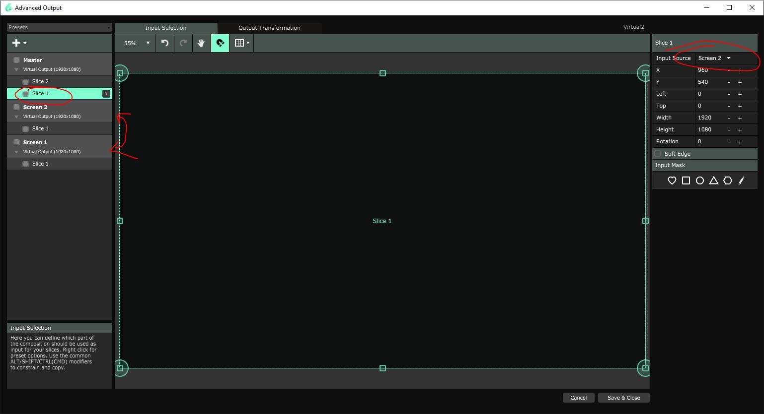

I have a question about understanding the links between the slices and screens in Advanced Output (AO).
I've created a simple project. In AO I have Master Screen with two slices. Each slice's input is connected to Screen 1 and 2 (Slice 1 Input = Screen 1 , Slice 2 Input = Screen 2):

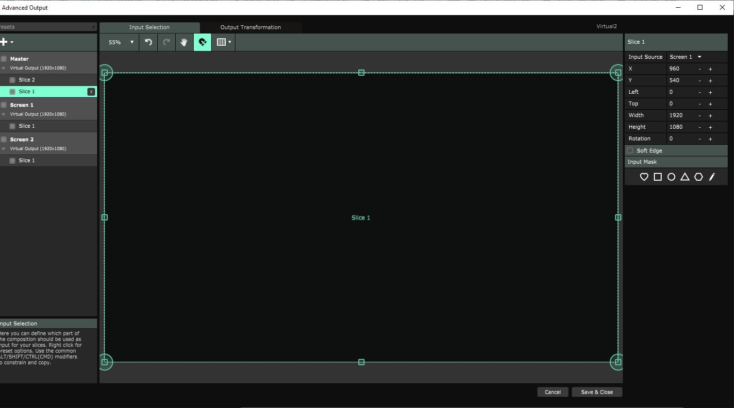

When I change the position of Screens in AO, it changes also the inputs of slices:
Could you explain me why? Thank you in advance!

The slice inputs are based item screen index, and not the name.
That's also how slice inputs work for layers. When you change layer order, the slice input points to the same layer index.
