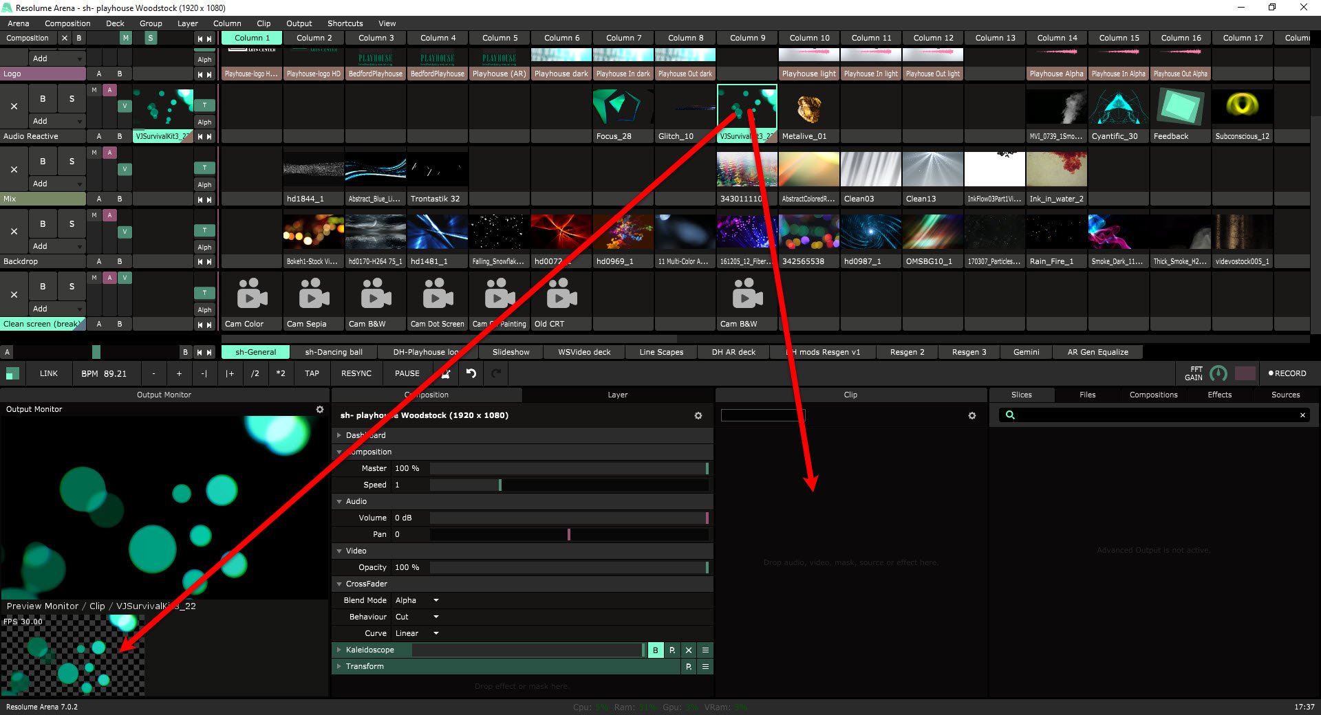

If I play a Persistent clip and then trigger it as a preview, I lose my clip properties column. If I click on the clip to try and get it back, I still get nothing.
I have to trigger any other clip and then go back to the clip I want, to gain clip properties control again. Non persistent clips do not seem to do this.

I get this too.

Looks like Resolume is trying to preview the underlying clip.
We're working on this. (#13137)
To get the clip properties back, click on the name of another clip, then click back to the name of the persistent clip.
