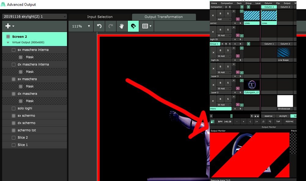

If I use some masks in the advanced output in the preview of the interface I don't see the mask, but the clip without mask... there is a solution I don't know?

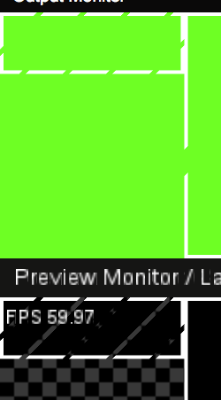

the output is ok, no problem, so I try to have also the preview like the output. in the output there aren't the black lines overlay.

Every slice have his level.
The layer with lines and mask are over all the others

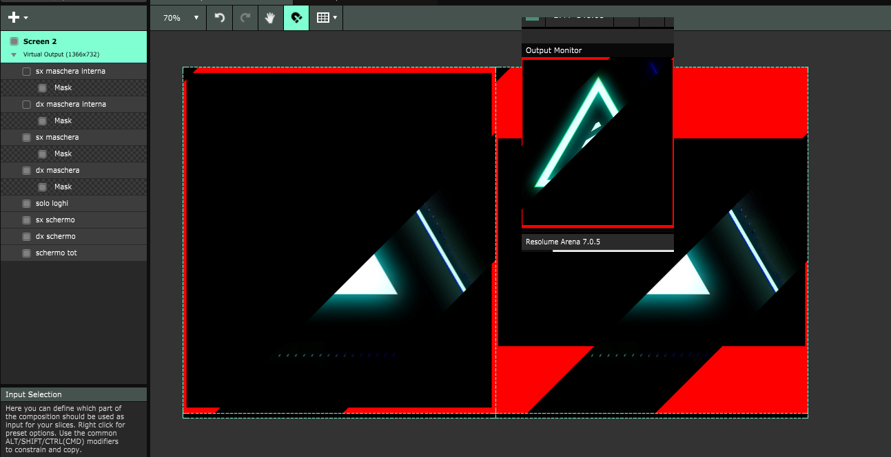

Are you using Slice Transform on your clip, your comp, wich slice and mask working on it?
I think you're trying to use the Advanced Output to mix stacked layers. In that case, try to make all your layer mixes and masking at composition level.
Set a Slice Transform on your clip/layer with the mask/slice you need, and turn it off from advanced out.

hmm, looks like the inverted masks on a slice transform don't handle alpha properly.
If you set the Lines layer to 50% Add blend does it look about right?
