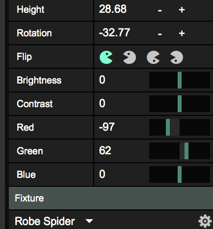

Hello to the resolume family,
ive been trying to control some dmx led spot lights with arena 6 through artnet.
Its all working fine, except that I can not switch the lights off. There is always like a background color mixed into the resolume output somehow. Im using a fixture with r+g+b+a.
Do is miss something in the settings?
greetings, anton
Posts: 7757
Re: DMX LED spot lights
What's the DMX data Resolume outputs when it should be black?
Are these channels going to the correct fixture channels?
Lumiverse and fixture color correction all set to 0?
Képernyőfotó 2020-02-18 - 11.33.01.png (33.78 KiB) Viewed 2870 times
