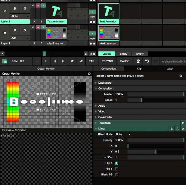

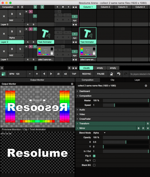

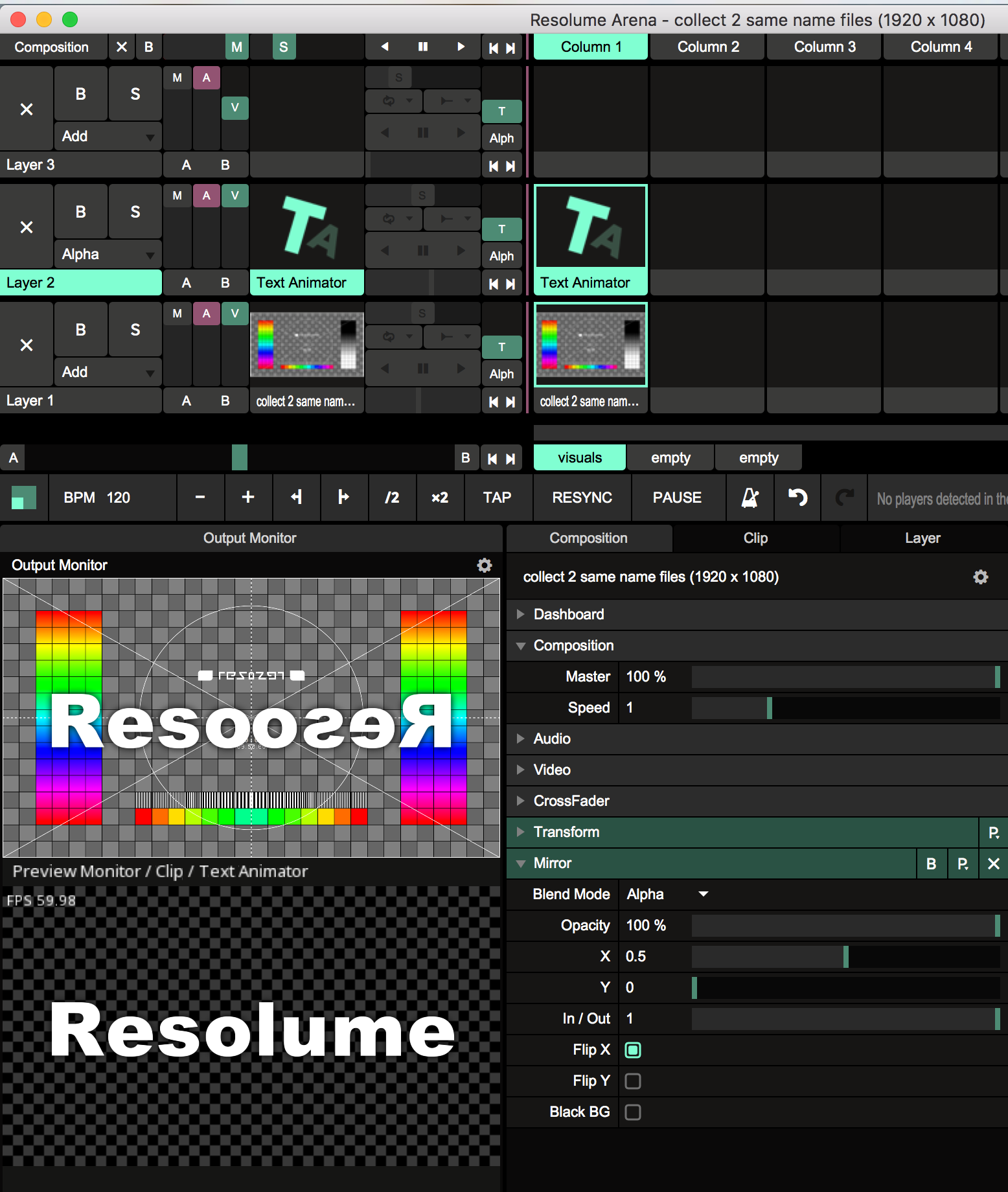

Re: Mirror actually mirroring correctly..
Clear all layers
Load a line source in Layer 1. Set it to 1 line, rotation 135, position 50.
Add the Mirror effect (basic preset)
Effect parameters should be x = .5, y = 0, IN/OUT = 1, Flip X = checked, flip y = not checked.
You should now essentially have turned the line into a V
On the Mirror effect loaded on the clip click the "B" to turn bypass on and off, this should help you better see what it is doing.

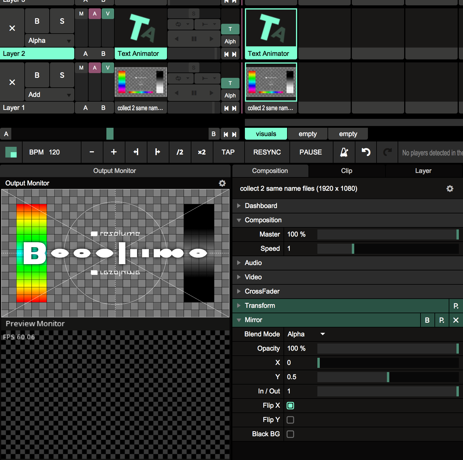

Now on the mirror effect change x to 0, and y to .5
This should make a chevron pointing right. Again toggle the "B" to more easily see what the effect is doing.
If you're still running into issues, do you best to describe them and I'll see what I can do to help.
