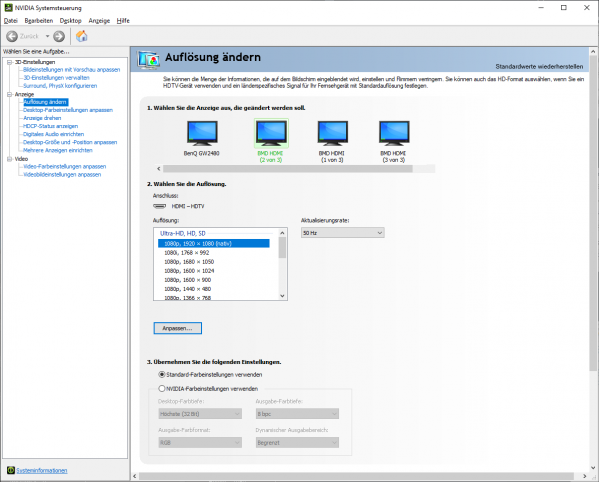

I have been using Micro Converters HDMI to SDI from Blackmagic Design behind my Graphics Card to convert the signals to SDI for delivery to the in house projector and the live stream production folks.

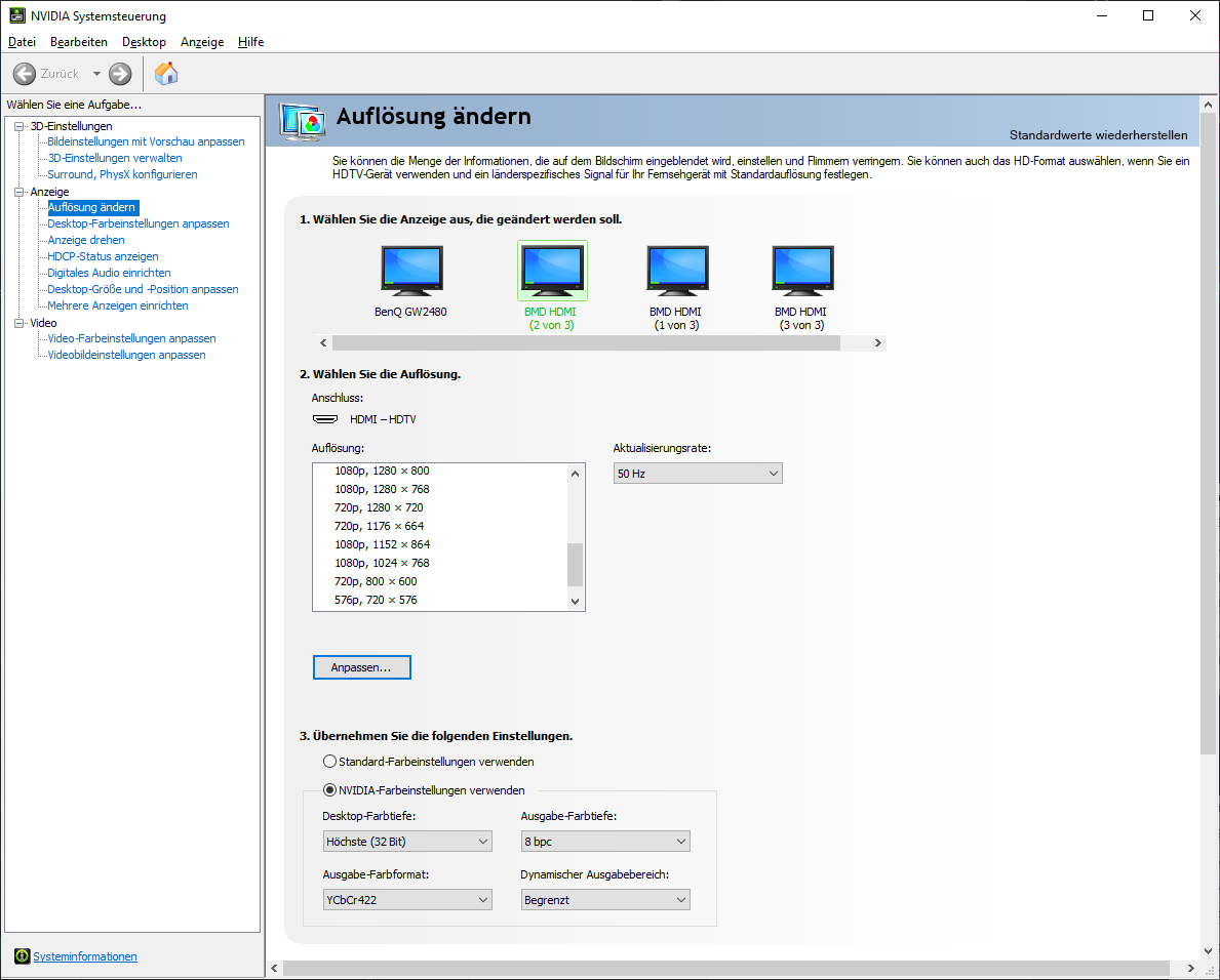

Thus Resolume was actually saying that it outputs a 100% white output (checked in Advanced Ouput Panel) and I could confirm it by checking with a monitor directly behind the graphics card via HDMI I got a about 90% white signal behind the Blackmagic Converter which made my Key signal kinda useless... I know that this is probably a converter thing and already wrote Blackmagic Support about this. They informed me that I need to make sure to output YUV 4:2:2 instead of RGB from my NVIDIA graphics card. I checked all graphics driver settings to be on default and they were. Sadly the default in NVIDIA Settings seems to be RGB which then results in wrong conversion by the BMD Micro Converter. Changing it to YUV 4:2:2 in the NVIDIA Control Panel fixes it.

before
before
after
after
