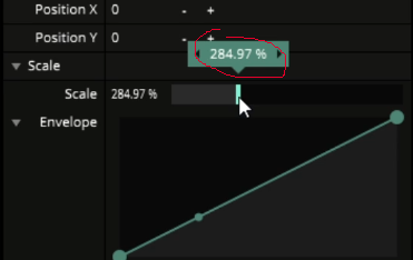

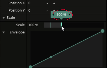

Right clicking a slider resets the real value, but not the slider. This only happens when the envelope feature is active. This issue "might" be linked to my last find in that region?
Video
Arena 7.3.0

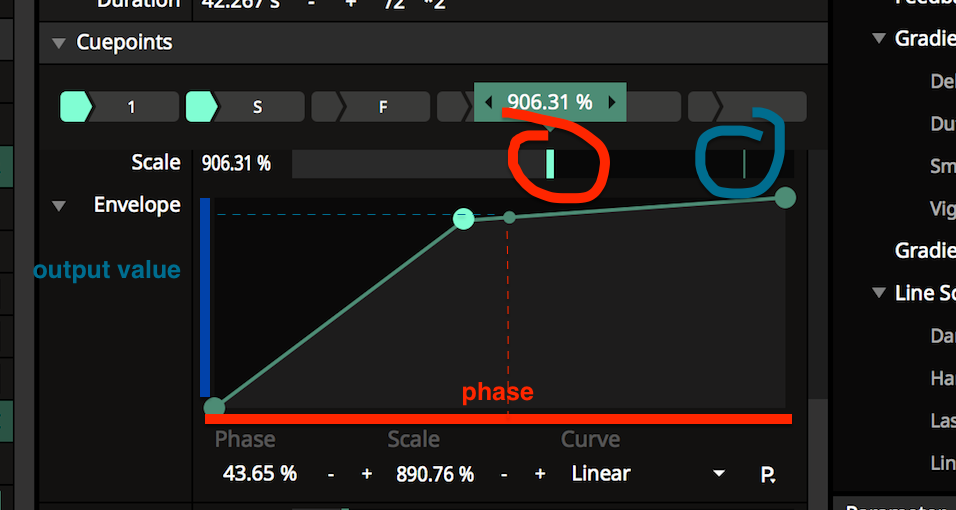

Int he Envelope the horizontal position is the input/phase, the vertical position is the output/param value.
The number you see there in the param thingy is the actual parameter value, but the slider is the phase percentage which controls the X position in the envelope. This can be confusing indeed.
In this shot, the param slider is at 50%, the small dot in the envelope is at 50% horizontal, the envelope says it needs to be at 90% vertical. This vertical position is your output value for the parameter.
There is narrow line for the parameter value on the slider at 90% of the param range:

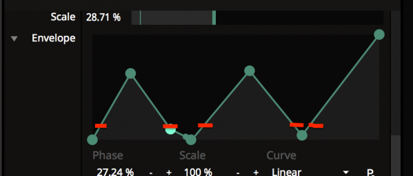

Now, if you have a complex envelope like this one, there are multiple positions where you can get the 100% output value:

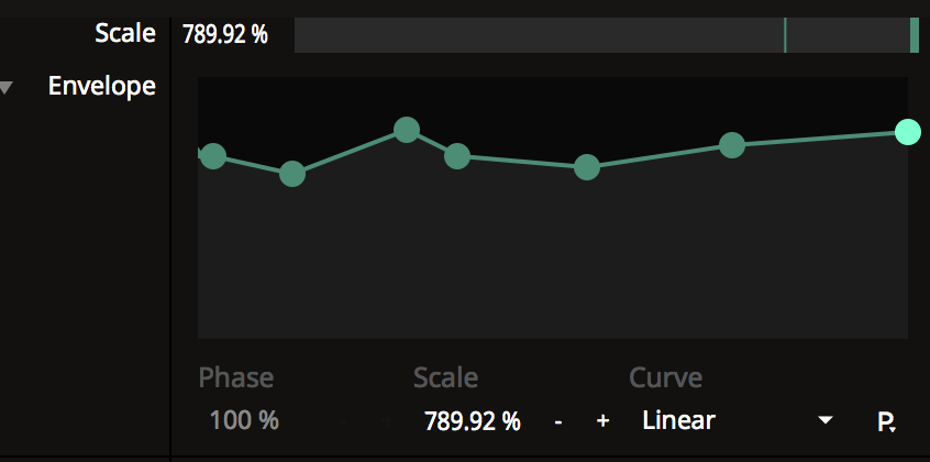

And this one you there is no position where you can get 100% scale as output:
In this case there is no way to reset the slider to a specific position which would represent 100% value position.
