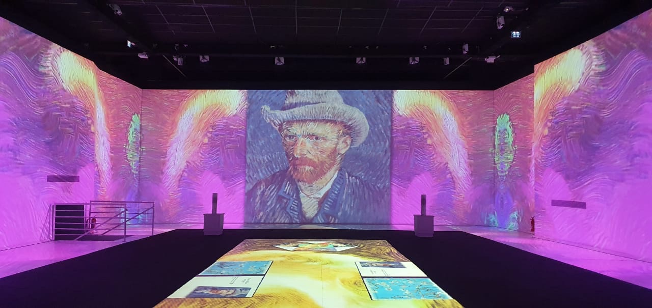

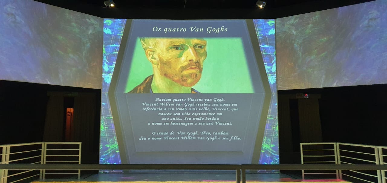

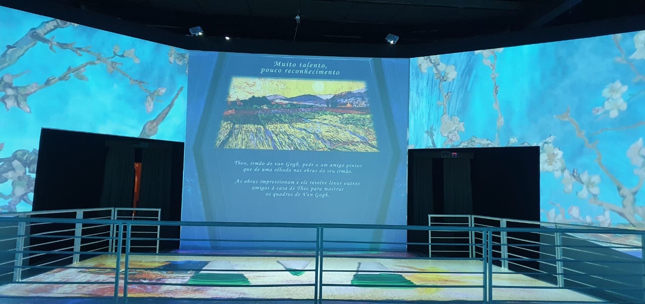

Good afternoon people,
I've been having a problem for a few days and I don't know where to start.
I built an installation with 5 interconnected computers that make an immersion room. Each computer plays part of the video, which with different resolutions but an average of 15000x1200px divided into 10 projectors per computer synchronized by OSC.
I believe it is not the best way to synchronize, but for now it is the one I know how to use. I'm going to start studying the Timecode system, which I imagine would be the perfect one.
Back to the problem. As for the timing of the videos, it works perfectly, but I am facing problems with Audio that often crashes and returns. I don't know the English word to describe exactly what happens, but I think the expression "stuck" describes it well.
I don't know if the problem is in generating the Wav file. I did it as follows: To keep exactly the same time and framerate of the videos, I used the same timeline as the after effects to export the file, that is, they are identical, or if it is in OSC synchronization. I really don't know where to start.
The videos are really great, but everyone is running at 60fps without problems, that is, it would not be a performance problem.
Another point that I believe is worth reporting is that as they are different videos, there is an operator to change them who accesses the machine via Team Viewer to switch between different themes. OSC is not working to sync videos when Auto Pilot is on changing videos in Master Machine. It becomes a mess.
Could Team Viewer cause this problem in Audio?
Please, any help is welcome.
