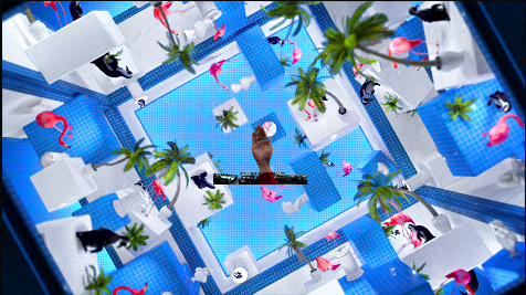

I have a kind of "virtual stage" set up using Arena and OBS. This is what the final output looks like:
Basically the background video is controlled by resolume, then i set up the "stage" using OBS just by duplicating the resolume scene and moving them around in the way you see above.
My beautiful hand is where I would theoretically be standing for my virtual dj stream. That is my camera, and it would be set up as an input in resolume.

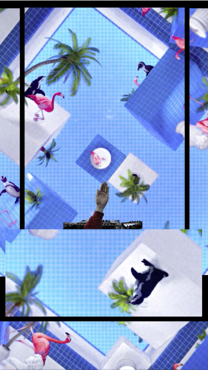

This is what the resolume output looks like:
Here's the thing: I want to be able to use effects on the background image and my camera separately.

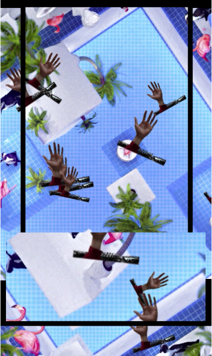

Of course I know i can add an effect to an individual clip, and everything works when i add an effect to the background. I would like, however, for my camera to maybe move around the screen and be its own entity in the screen. If I add an effect to the camera for it to move, it won't work because it'll just look like it's part of the background and not its own clip:
Ideally the hands waterfalling down would be on the foreground on the top of everything else, not as part of the background.

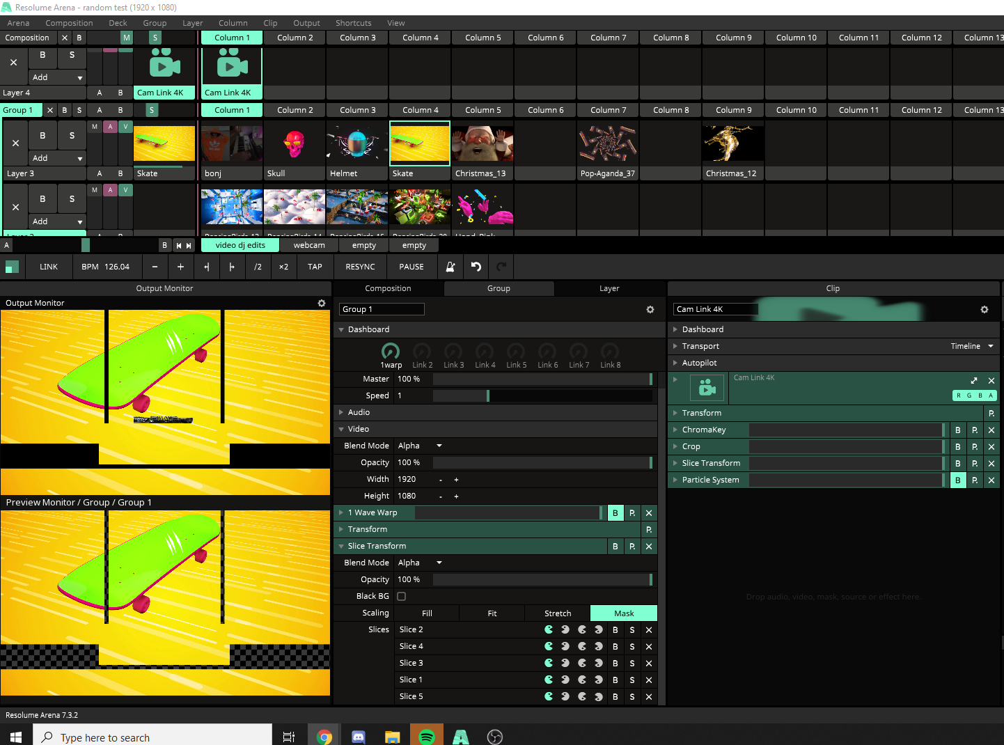

I'm still familiarizing myself with the concept of screens and slices, but I got my 5 slices under one "screen" projecting the actual background image, and then I have another "screen" with a single slice, being my camera. I created a group with the layers that I would use for the background videos, and applied slice transform to that group. On a separate layer i have my cam input, and that one also has a slice transform.

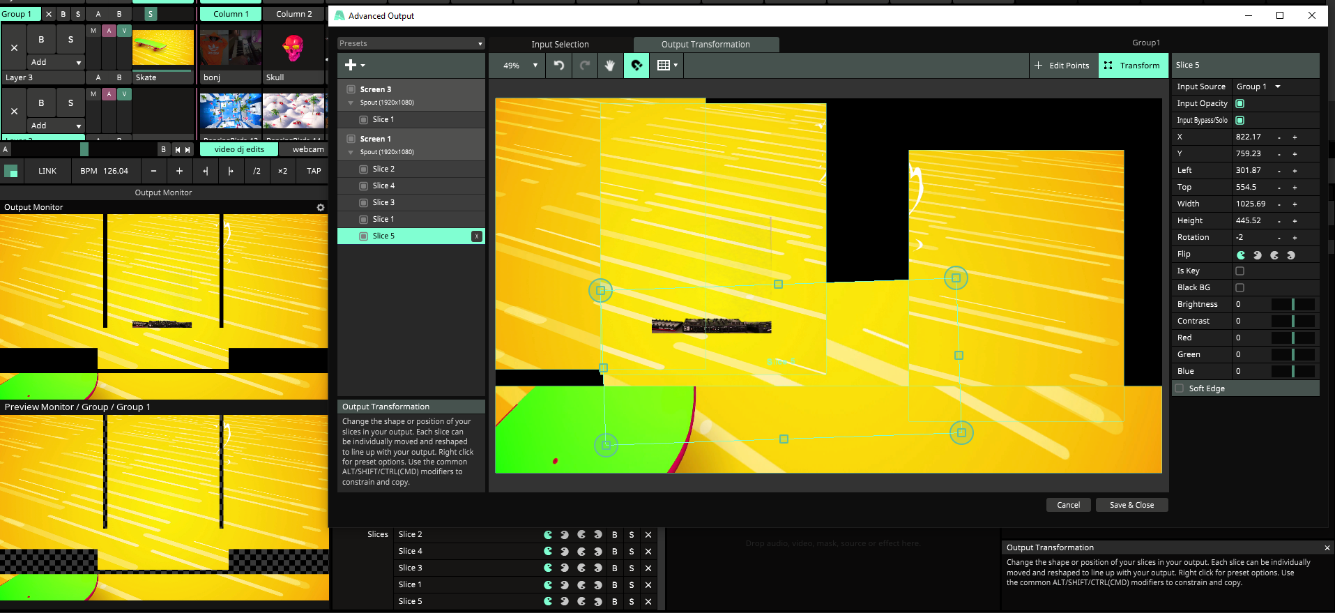

My question now is, slice number 5 is the one directly under my camera. I would like this one to be scaled, so as to not just be flat like the three slices above but to be a bit zoomed in to create a distance effect. I am struggling to figure out how to do this, I'm guessing it has something to do with output transformation settings?

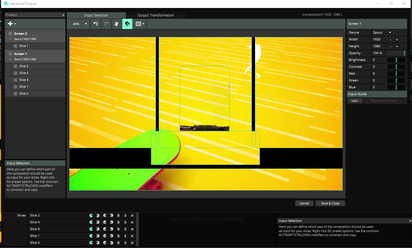

I am lost as to what output transformation even does. I've set up all my screens in input selection:
And that seems to be doing all the work.
In the output transformation tab i've moved everything around and messed it all up, but the output doesn't change:
Any idea as to what I'm doing wrong?

That would need to be done on the Clip or the Layer level transform control. Add the Slice Transform and then adjust the scaling to make it look how you prefer.
