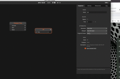

So I can now drag that to the main work window in Wire, and it even shows me a still frame of the shader - but how do I run it? On the transport menu, play is greyed out.
Once I get it running, what next? Export as something? What? Where does the exported/compiled file go, so I can use it in Avenue?

GroovinDJ wrote: Mon Jun 07, 2021 21:27 So I can now drag that to the main work window in Wire, and it even shows me a still frame of the shader - but how do I run it? On the transport menu, play is greyed out.
Place a Transport Time, and connect that to the Time inlet of the ISF, then press play on the patch a the top.
