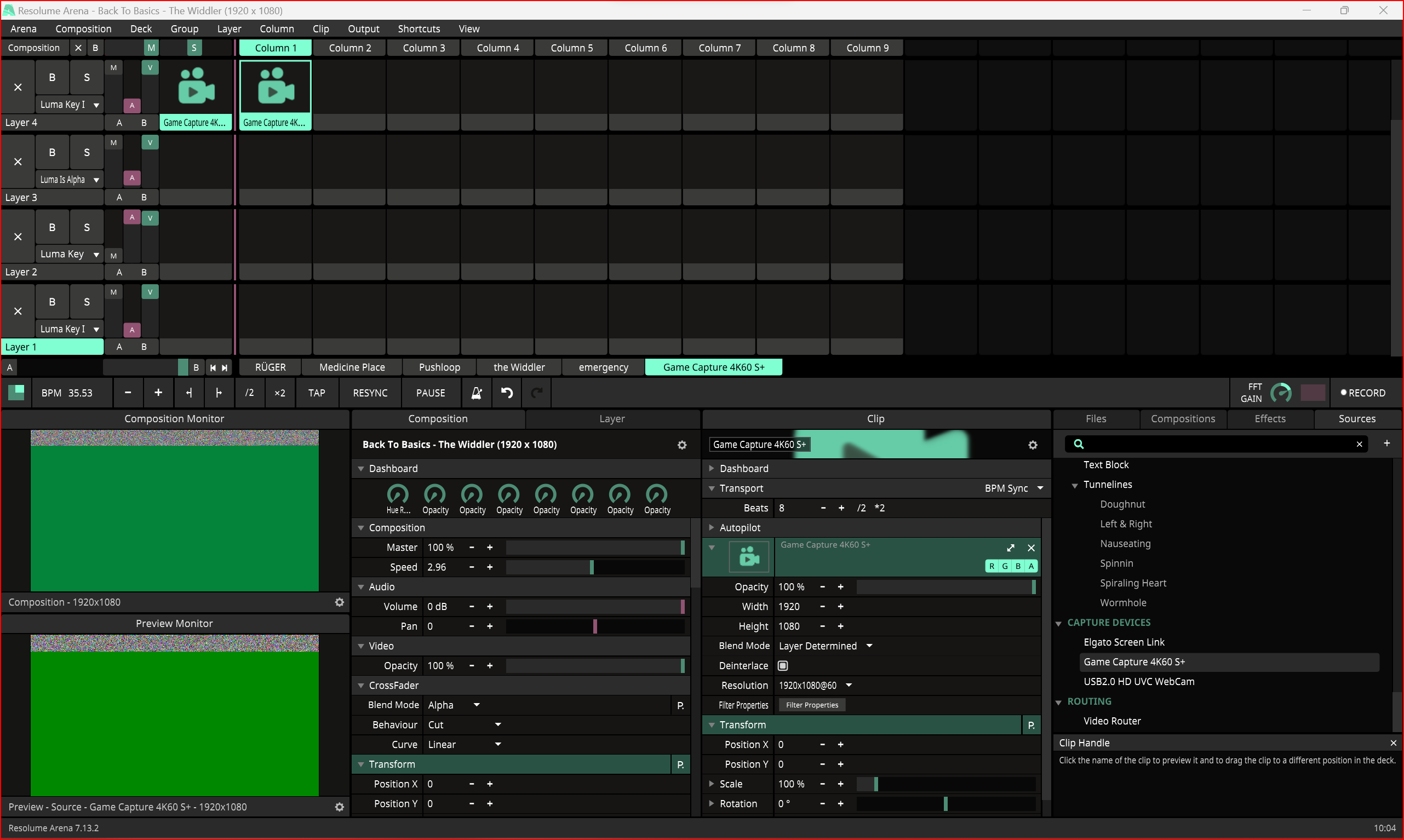

Okay so we recently bought new laptops and decided to go with the elgato 4K60s+ but we seem to be running into support issues with resolume.
When we tried it plug and play the elgato input wouldn't let me set it on the layers and wouldn't let me preview it. I later searched for some drivers and updated them, after that the input was able to be set on the layers and be previewed. But the input was green with static at the top of the image.

Can you post a shot of the issue you see?
Fuzzy-EQ
Posts: 7
Joined: Wed Aug 24, 2022 05:13
Re: Elgato 4k60S+
Post by Fuzzy-EQ »
here you go. thank you guys.
Posts: 7582
Re: Elgato 4k60S+
Thanks, we'll see what we can do.
