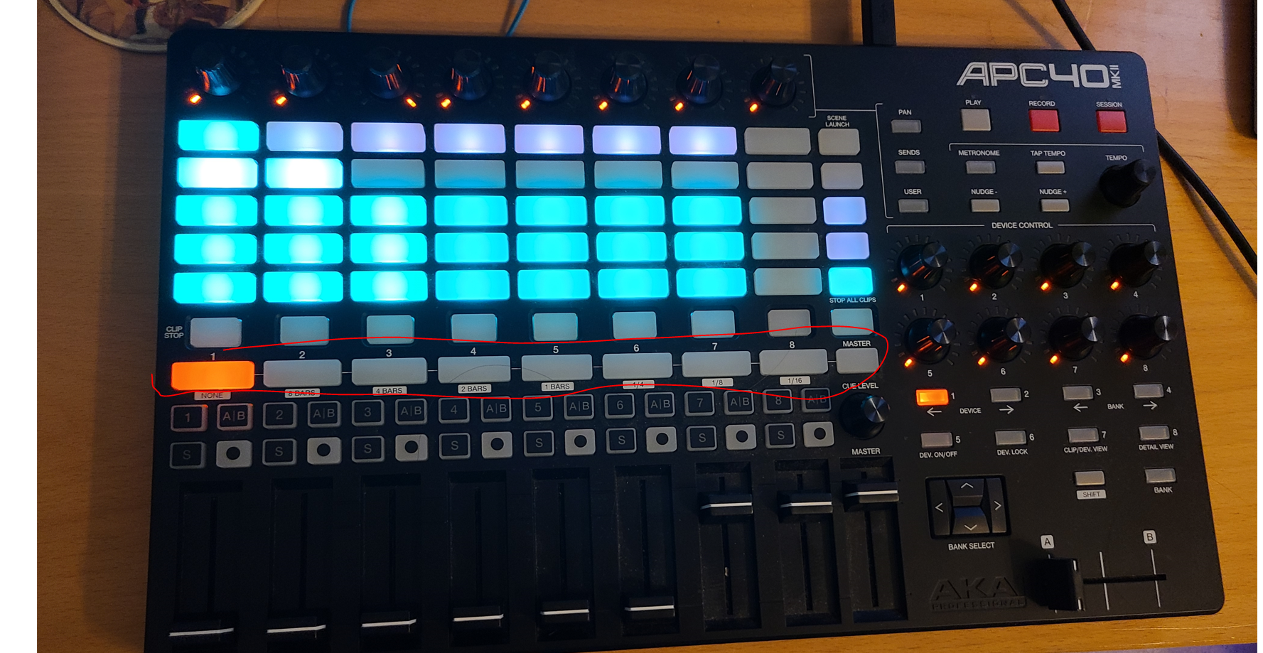

I am using an APC40 MKII. I had set a MIDI map earlier this week, that used 1/A#3 through 1/C#4 (attached is a picture of the buttons I am referring to) to change through decks. But now, those buttons instead change my device's MIDI channel and it has completely messed up my MIDI knob layout. THIS ISSUE HAPPENED AS I WAS PERFORMING ON THE DEVICE, AND WILL NOT CHANGE BACK.
Please look into this bug, I want these buttons to go back to being just buttons without changing the entire layout of my APC.

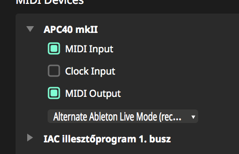

What are the notes that come out of the controller when you push these buttons?
For me they send D#2 on channels 1-8 in the alternate Ableton mode.
