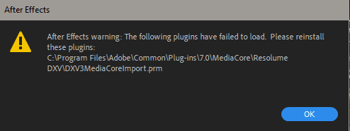

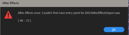

Hi, I had to use this program a while back but I'm not using it anymore, so I unistalled it and After Effects complains about missing a couple of plugins, namely some exporter and DXV3 or something like that.
Is there a solution to this? When I load AE I want to go somewhere else and not stay there clicking two annoying messages. Is there a file I can modify in the AE folder manually so I don't get this messages?

Could you upload a screenshot of the error message you get in AE?

There you go

Posts: 7710
Re: Problem with after effects after unistalling
Thanks,
So if you'd like to remove the DXV plugin completely, you can delete the folder c:\Program Files\Adobe\Common\Plug-ins\7.0\MediaCore\Resolume DXV
Make sure Adobe apps are closed before.

Thanks, that worked perfectly!
