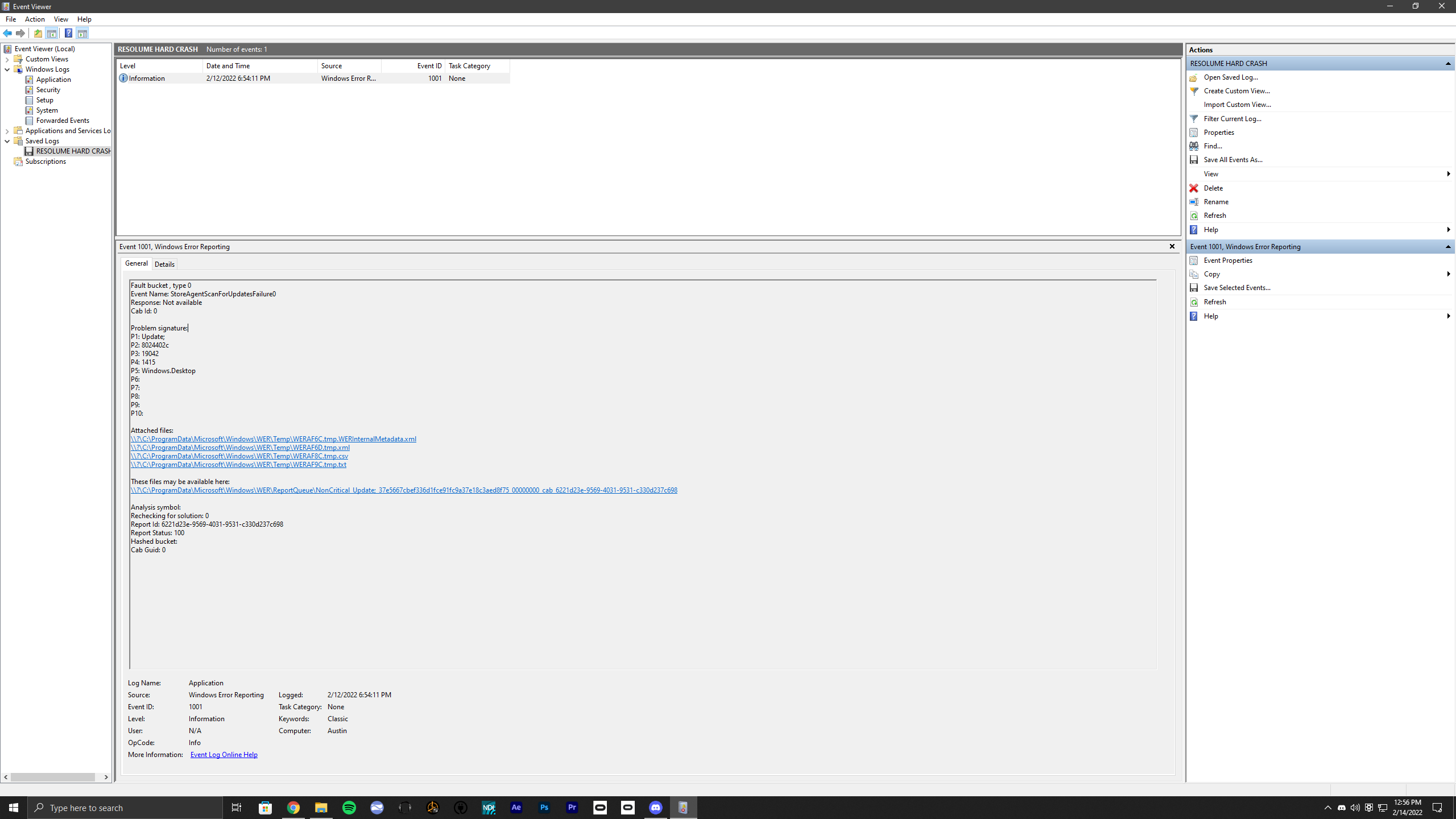

Hey all!
Using Arena 7.9 with latest nvidia studio drivers, and I keep getting crashes at random times. I've done everything I can think to make sure it's not a specific deck/layer/file, or even time interval on when it happens. The only thing I know for sure is that it only happens when changing decks *sometimes* (and fortunately in non-critical parts of the show :shock: )
If it helps - during the crash Arena will still pass blackmagic SDI inputs through to the video processor (thankfully) but the program itself becomes unresponsive. As since I haven't been able to re-create it reliably, and it's only happened during shows, I haven't had time to wait for a crash dialogue, and only have windows events to go by.
To the best of what I can gather it seems to have coincided with microsoft store updater, since that's the only error that occurred during the timeframe of the crash. I'll attach a screenshot of the eventviewer file that I exported to examine at home!
Any ideas would be greatly appreciated!

What windows version (winver) are you on?
If you remove BMD from the equation (new comp with just DXV clips) does the problem still occur?

Posts: 7771
Re: Crash on windows store background updater?
Your last crash report is about decklink capture, refreshing the USB bus might have dropped the Shuttle unexpectedly, and that causing a crash.
