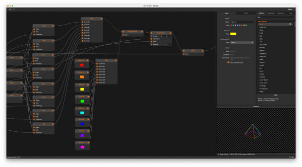

Hey Folks,
the last days I've dived a bit into Wire.
To give myself a goal I wanted to create a patch which a. generates the graphics b. animates them and c. let me manipulate them in a certain way.
Some of you guys will know to which visual artist this graphic style is a tribute to ?! ;)
I am pretty sure I've did many things inside the patch a bit to complicated.... so I am very open to hear where I can optimize stuff. - Hope you like it.
--begin-wire-patch--
13661.3oc68k1bibbjn+UXLelc8p7ntzGTD3fvgeqjsVI68sanc9.HI3LHLIwr7vRZcL+2eY0MNZ.T8AHAH.3.J6QT8jc0cWYV48w+5CWM496Gc0Simb+ie3690+0Gt4gI2I+B3O+CSd9ou77Se3im+gmlDuDI+xCCu+waGFA+Ce7qmOGb1b9G9xvmdZzC2OGdtF3ovZKuQe9GFee9UJAX7pq.XbcWGv3UWcE4o.pWdIS.oI0RZ4j.V02jytF3NYEdXxSIf0sFrdcx2VmuZHgkfzqS97q70MjD7GuZ3siVd+xT8N6xuAl4aX5kVy02ZAcZ5qDPBq+YAZ4c+2Fe8SedEPgzf94Qi+zmWcYW+yO+Q83naKNNrL3XhMWa0Pu9KRb6tJnw0g1sQP6qBZ25u11z3NqsZH0q7Fr9AHaM6EqeJxUy9rIAZApDbcBrHZSRGgtDqLV4JCX5Ud8yG.lhVtlOwDuyT0ehTB5eBSiYHnFXgUfshOvp3Wj+Wt5oafhrL97vurxVBk38vlBR1mZQSxN1kf6R71S734v5hi.tFd2fIwNmASRHYvDuxwm3ii+eW88HA0rIMaNiOMnU+F6ReCIHPsIHgLUygYg.xRefQAwI1osIvzUw2vZpA1UnNSvNZAr3JvxoPHIog.aEayIkRCFNwaQkLaAahS1tjp0.KXLW5cNx0OErIvz4hSVGcDkDrFge79qjLJgVCfGR9d3gDuy9zGR7I3t3SyqvSIdmi2e0uyI1P79zuGo3u3CogMA5K.IemC5TuygZdmWntU4WDSZpeOWGvqP9GRgVBoQKgDDzw0cxWFd03m9CZEns0B8puGtZgdkOwPhChw2tJNZERgapToCTuN6bTmVPX90Wao0IXmiZJwpVsj6.ldCI+kXksZuIwRmjEFlP04bPqhzCA25DHHjTubLgZw42eB94HlfvCwj76vDZsle+IWWcBXozKKk5UHsLELgdZXTqvKG8owqrkkPGsbPGc+0q.nMAflJoKSnda92Pk3tjquu50OE3gpAec1AHkFABI.EqPfLkPSQjSutLlVUw6FJLWGO71UfNAoQZ0zPSEf9ogqhrSHkGSqkFlT0n3Axm973q9G2O5wGWA93e0Ci+zmF8Po01ldsSwsM8IjnBcqurgzKan5kckCH104ZFUvNMpvl3DcTav02eSnKGZ8I4ChozOKZNvUStcxCqPkk3rjKMsfqh20TfRoW0Gl778WuNB1k5kfSsKjv8P4VOkb2M+uYsiPo0ODSneHl1sKXBm9f9zGL85TuAB54lGF8+77n6u5OVA9D6w9JENh9DRnieHI137oW3TGL7lDGL7o2K7IzExTwANuK05l9br2Vy5txINeJyQzUQTXRgRRqLKFRv9KB556u5DV.Dpz5PLPI1JBo2hCoPGgzaaITMMWUmTniDJlt.1UUuyjXSK3S+Nj3jTDz02zBUXqPRDGkZK1yUBMj1duJfdcFVjtR+ZQIz1MeKJoAvXBmlQ5jlwke4pUEiVAXah00jXilzIPIP0acIfF0UBsO8WWZAdIbDGoSd3izIL1iRqNOkv+1Dj1+dTBGbu.VXEXSbNM+gk5cHIrPZXwzaCUFpmDgRhfz6aPp8s3KWZYNDlv5dLJ5b3ch35UV7D5zmu.IdORbjhRGzEj3ZfEWYYSv+NMBIgibyu66F+6M8ll+FkZISf2nzjNI+9So5LkPGrHWv00VinDbRnJ18SfUonMAUPEjvn.hpznGhroAO0AtDwoL2Fj02I3DXL1kjSYhPURocjMwInt3PZPWGUPocZKwI1ALIczEkJjdzbCXVY2xXpC3UHxRXtS9l3plXmFPps.ZRAXJBLqthOpPc.uxGUBOsm+JrtKFRCpMwaaBWrS1zxfS3gcxZSSCjvoPDOSVheEf80AraEfC0ArckcWcc.aVAXnNf4U1K35.dE8Qr15.dE131DrxroO+ZqciaEhmTwDfrUvYxA0AbKHKstTzZgz.lh9MEnl1tloN+5RDXMxwU78S0A7p6rb520DeVo.MxEd82VNM+qTqoMsrgzZklDZ+FAcXSftR6MSCMrIPa4MBZ6FAc06IINfZRqUTRPMsGTe6AMzZPSGyvzfBsGTr8fRoAMgl7wauB8xR3rIxWwmVJPS+okxuTjuBClRExxE.uBWhDdvJmQUhSzo.MJ7tsfxsGzJdARnTPZ+bQoBlXNS8z9rtB3MaH7zlAebyaifeCeeh63aD7a56OTM7INfE8QXBOcxUahFthexopAcEWpmHr1yAkWIVA0XinYEGf4qFzUzwSapFzUzczaqFzU0IMw6Z5j.fRkD.TZu2Ro1sBoYZERwIJj1yzM.7JbhBP5us0ysGJjROnPEJMkvGq4qa0ooqotUe025DD5gzRRRQ8DRJ1M0VAURRlbw6mb8nG+v28u9fN9GCe5oGFe4yOUbow2+3SCu+ph+im9CQ+7u6C2+7cWN5gOb9G9mCu8Y4BvW+pviMFembnllsneWjabQRl9c4IK2u+guygnSAfGrr1Fik6e7guKDXknx.nQifjkqJK1U2N7whG+0xyy4rAGZMYcu3hNYbexm4u3BSl9htc3dc6q6bwEw2lQO7XDA7c57UXxU+C4d+miudzjOLyiJe2GtQ9wNTqyuT921SS+NiaGK9FeZzu+zyOLBudwm48Oe6swuzOO95qGIOleMt0M7tHz+sBnO6uJqg.An8a0cRH5t2YakQzbbqT1zDSC7NRyVuqXuLywjxJLqsZlCHHWu5cydltPFa6ax7Cjey1QzRtC63t8F7Z2MyC1WouyatcxvmV7YFWx7rCoZHTjN+G.BnNH7fsesr.hZtQPO8N4fb2V.q.m06gIxBkisB6brk0pUZ4fuO3DbSflhu.M3UrC.RKZhle8pwW70WZyXiix7CG5xXjr3kWI3YBds3qYu5UuqlerLIZkW.1upOO+eD9Oy1.pYEgP9Odu1EzNnBzzOO5J407SBa6HpBRvh5pgONJq3or33a7eM+gM8gKKf7K+1xuT+VIvdb7mtWrE5qm2RzeIWj1vKv36eZTL3.qS3u5pZqfnJZ6vJDUDZjC6VgaiHOfmQSITXJlMFisfIa0DTVeHjwcB8x7XmtYAgRRHNIg8gdqvNUuomumJTrx6BTnsflQtEqADsv+5b06p4YocS4IHZcoQBwuNWSuZtKY+nL8ol+5bk9p7trJawyxYwfbd2PvWmq+2lbXnr22WbeyHilemTEmZ9kea7SW84hiLvoiLqdjAKKzD.if1LjwxQ70A6IFanB5Qn1yYETwAVD+HeiFrEmX.ETbWNKX7.KmPa0IF+zyYry5E4YFeKNwHmNMSOc5Xi13011chwrMOifu2OiPsWWkjmQHJnDa6XMiAaspUtGOi.s6DQURdpUFhcpDDxyf23BaUVzIT.U9lGmM71wCKSqb4jI2tXkuY3sONZCnpd99weYxsCengELMgRL54qZBBHzIfUjtNWYioZfPJu1apWc1AAyfLF5KFyMnGm0efteOi8BPad0pyN7tub63md95ZLvf9ZY2tVm4DS4NYBhMUhDhHOsI2byiidp9E+KeNx+nIHiecOLR.IKG9xmzmlNIUa94R2XI5pg+VNQEpONIpznxHDIhtcvLtOnGjSsBSDM5H9.lpBTlVSWslYpMSWUr76eJK3njxJHp44s.HZYHWhfobqbnSo0APTM5vl3p8rr7S0mBLnw3H2QCKK7HkvJRA4.Vr0hDdUSIrLnnaqXFn2mesSRB2ajUzwp5UhIQhYoh8dfVLRcJcEai5m2BGFtmkE1V5JSaj7cPPGwuqnirfWY.KYbbCQJ3nQoJzbDoEk43jZBUQAcn2vZcQ.6V3EMBN70Qm1kZneXHuylJdVe44mZvaRe4gIWM55meXC8UULl5syQYslHCf.o7.3rNiatBUByKVE.x.D3oFbuP.QSlPhFxB8w9YlA9f+h.2qGQuZhr6u5ySdXUTKtbbv93LuJUBtRavKibKU9P0Gzz77WnVojkSEgZdCyzJGV3QKwlHMhANbtvYTW3sXQAOBMVO+wph3c7wbyjGtqfhycDyKSqsbAQybdYD4TgfwyA6gsNVea3ugWb1TrSTlBsda.0f0VRYp31pxY3hX9Um0dWzOzMi6dQurtTeNioN8zrifdc67MjzOEtRHY4c.8y36KxZ.LbPQ.QnUaMZKwtR7brFuh8.eh9YOwsYF0BsUyFHy5AgFYPEbFj3f2HZyLmFHO8sBANFBMFZH6MziLCy3Ku45rKAxlMhuw5+I5pqDI2a6jgqF8VZo5FBuQtfdHXHq7YB1ySjMGUoswON4eNE2bJ+eVNPsrQzfYYAQhcX5.3NfCSqxUnkobD.rXLfpsHvsYEZizTjZyzK.q1jUXJ83RtyrojUHKcbfaJaERor8VL7wzoL7ooCEV1o7FSv3zGtY3SaNDTCAX8ou.LUZLIVl.rqcmQvolCJe9D6CZWaNi.B6m7GFIlQ4EzvhayTqsFqZ6417HRhHKssI6m0OCW.0Uedx3qV5HGjcC7glSW9YYMLypxQTRDQhhNhzzz8rFcD6wQmezmx5dQWaVOquKauvq0KqiHtmnh0Ufv9ogxqRN5JUDatUvH2M59mpaC9GFcSAKsw2dakZr+zCOG85vMSt+orFX7.Q9zwZAXkRCnzirabC7rOKu5id3+99JPtFRQZWXNpaApFBJvIhDbZidpqtDLOGTByKQw4EIAgb7S48ySKqpQ9TOneFac8y53PLSOnmwZMjmbb6Ygcs9J4guBxuhDoexc4nkbDWEgHQPdON99Okc83GV677ZHw+78w05xwOc8nurTNjuFj+zP4.9YcG+zY8yA8qKpnU4QIuUOVzW9muBkt3BkS+XgwDSt84ldyJdd+Rjl4qSqW8M54zVKDf.5UBu8fwpMkxBOM3TFF0Fwf4B+UUCOfNnMic8sYhUFcx5x8M86Q.2cfqLY.7hb.ZNFcXDkV8obtD1nthF.NO+e93rcz1X3wR1yszqSI1+wE6redz8WWniAPlcV8MMGu43XNlrTANQVwRGVLuGaP2iKbtAYrwK5d3G3xbPuvEfYfoa+vqU2iK+iuL7wlcD6zkooB7.R4b6ppXppL6ur4ghNaE5mPdXluXOGooNIZQtziKaf3rOqE379OL4KmIH9qmT35PxdhezVfejyZEMHsrYtLpn2JrFipET0GK7gDiz7ZJffM2xzPr4iJT6JmUj55DSDcNPDSK7heC3UwuPdUlViSshNFdqX8qsvUAEYZIXvXgFvhY4gCZ+O8qw81yS7Ger8dkJONcmWwe1nun3DdUV9xd9t6qGA0dCteXxusc73HQFE5QQqBdYzsbAwtKjqxaijnnQgcwDIJURFVrnnuOyQ85ewEhEdtdtWK1NUkftruCEFN5pPG+oGFe8Y+zTSuhnEi9DK+JeNlMPGTHHzFjwKFcTJUrQPq3PvYLMkf+GQJfpUQSsDN7ZK.xoAlScoVy1uFdSuHgAF3vI9UYfWqBDXgnicJxbrBJCFYkiZJYW2uguJc0+r8xsrztma+GSKyqv+WwFIQ1cC+8Mjc17aqsdgNG9w2+hdLiuusOlhDgZydFsI4ol+.d7eL521v0O+VZ4x+zjW.tX5MsAOhMFOL8ldE4AVrCisByFlEYMHwZs24Wjqg4rZ7ncVFXTSVfEPQsEMyYdreur93E59jt+.m+U2wPlQeWaAwljYSAA6KpDEaH8vD5nZqzVhYebsy6Z.ZmaNowlFnrBr8l6g2eb3WJ3GQuUonnYGkhhAw7ImEByLTZp1Q5fHbz6PcSAZZulehMX3y4udKvZNeFE85E05W9++wlywweETbQyRv3zh4LFiKlJAa0qsQlPpD8exD0C7EQuBjUf3fih6luo+csKUMMGmEwPLiLEl8da.V3YUQIKA64ctPSEk99MMMwspNl3gPNYZbu2y4.t8DmhlHJzYcAloh7Ruf7zpcpnSCYwbf5CX6dswh3JT2.BZGwdKQspU7P1Jxnf5yCgh6Bsnr6vjqEogPBFzsMy.zMmY.F+lZYzn+4znct+RLf75i.cfC8kRePjMFkGnVn8w9LAATKHUpOSWVSDWSoMf83rkGvnxFScbQLlCK2d3jiHdEJH6lxEziDwaLEVpsBAGKR6ra2bBNUW2QL004LBBWGC1Tg+3KHBzjQk2umZriNN7Z2vL9FFx7WacYVlt7FNbCNZH+pCfbdKTt9BJZsT997Do4eT25Qq2EAWo5oVes9Xa6+i5ooQVP1VXOZ7Uv03Gl4aLKWgsn5WhahfWxMga3Mc2jkNOtl3jeNuQM9x6JTUn.NZBQQ2dSobRAEQ+JLHRnaf37ZwX4LFu7lrKsv0Y7Uggtqu5Z6U3vstJN0jv5qI2oIXw1A6i2MYhPeVW7HpRaj+98wu7bRQyaAeFuwZD1KtPzM9K3yHhOE0yL5l5Bu6YtLSStTgqnS3TJFDVE2hCLtL1cOp0H5QfA1JlCuLpMFlWjb5YYS1gIxMGi3WQEgCPLo63I4T67PLGB1dokpWAwtzMEry6h2EYlXvRpPKJ6j8YxoZ8u28YAtAoVdPr62hVwl5RMOXgSApzLx9lxx38pGKZiAjvVzIA1ceGBWvGTrsjwjFJ2zCHwJe4uYVshdf1dv0ZdV2o0iLfgsd2BesxEtMsKbm9XuSXfwt2iwaH4W3EmSEphPdas19MXivPAS6V1NBbNQpSXq1ZLzUmrYKGJEm6kwUv25bvRPtw5A1LGMOE4ifpw9LvgZ9YtiRWyWPBb57ujD3D1dIvY6IDrHoXcPXoOKVWSoDbnxPVKVQuf6fH+Mi4Pso04uoKbJ+Mq7432f72TGcLCQ540JzLlGQdJ.1T2C78Z8C0dFSunb07XLbRryIV6wgEQRun.OLAarWLOUwiC0nIsZik3ENHQZH1Rd8agI.xaRzENhkYkJ6WxXkirsn.x1yl.LMa2HmnYVvBGFl.3gieS.hSVCSoNT8LpBqhAv1Hm7SV.rqr.viuLlBtMvBfXA5HXX+JbDrpVj9qG91.rKT+uQE+8zdVwe2Fo3eT8MMv1x1+aIspj0.GrJ9aWcPB0Z6.7mZk.U+bbanc.Zg.ZYO8lyBw4ihSaJ4I+F1RfWpQ.Ihi6KjHrPWkqDL8S0FH+1qixlSe15luDDCq.psqz3dI15TVeLJOMUUwcDscx39VcV.fdYc79tP2KrjM7pKOrV1CDVy1gparAqke.M.J0JPWI4NVKdEPdZS8kgWM9o+ng3eLEJrUPUWJXlrsKL8Ucw4f+iHl3reb7uO6XfamayTF4ik1borfjXznzzh1S9gp8R7TSPiukN1r0CYBwqjnDsydI+wt8RYfkTF1rjztHQAKLjl0RkNYsz1zZoXuaaoV9FzR6mdgwUk2.6mDsbXRyyRPsYjCfRNVzDsvAn8SudClZz7nfdOadDuAlGIGqsdTuRDx3nTgXtPUQVIdnXdThzisklGEfSlGU4yg2HyiBw7W06Vpa6kygvFzvrjc8j4QuB6gBI7S1ZZHsFCEsWuIpRHZwVaRQ+WDoNwSGixyL5UUeZ8jqC0av.Kgh4igUas9oAleFUjnJRiCh8N5nxnxo+Le3hNYlNc5Y5p61yeA9pM5YxSOM4t5kyuIFF0Ricj24mZbAuMlOj0UtHBCcuI1+2.4jkn4Rj6QSpUaXfXJHp658hd0VJuZ0+RayJ6E11L8inTpD9vjhhWOvmxivEUhF3UAs2CKMMCn.XTjKz73v3PebQuEyhvf8DcyJzMA8bsvKlsgh.WUilncvm6oaUpl28UZ8qmpIdYp4QN92R7Z7G9kBapF9iyq7wQxEwPo9TXt3DGqcM10ik+RQYbu7G49OVzc2z4Ba2Axs8lzdw1oyiK8FNOt9xyxleViNJzAwehy.aTGhYTvNnPZ+edd3CS8tP3nkxjcHnsgx83AV6AUIseN5oLg8GcHE+AEU8sTvHa07tjND0GAMKfjzgNEBdq2GJmP.LZhi42lyUuiFFjo5cZ6IBS1K+DhMgNqlMH51sDlu6GmOsWgOLNhNk+CqyOcbmWnO.HT6FFwY4I4ApsBXqLVH4rPbKoHHpONm7MQ+5Gbhr.OUNLdTN2OP3147GrM3lsvDvA0zQozICqDN0VqaVAjN83J6iWuMMBqiEwSl8m3HDCfMl7.rIDaBp1cq3HyKKg.V3d3cQ9.faRBTywlqyRcVo7LRBM5PSZseHlM.U638WwTDGWNPQaPXlcDo3XtlLeLBbdFF6r.tPn7g9VkR.n9Xr.ZDQRNkMTJvOt3DD2ibCMEm8nXp0QasoqrkBw1jrL.OdZXF8GO7SSD0eN6wq97Cijuos2LcyYUZv5EUWWpAJQZBxGNGyRXoCxlmgXM9VKkVinp5tkN4AxdmlQqBSvm9iaquGZM5SOG0Lp8J+XQTEHA8pskF+WhwiAkY9rRnFdA3E8x3AfXjhF5j06hA8XG2m5oe0ohRpSaqmWou7PA+nPUb+mJs482hmphg3c78iZPel7.su4IvPyouVLg.Rj2D0VnOqOQwheIkRkADb6Z6oZ8P8IXTVi1ydZoQzBG.sx1lVFhtC.Y7EAQMGimkeq2EZm120S7V213Va65edFCmi.+DmPYSqQoEaevvBmws.qvwYKVCrADQq5Xu7rWVm.0OKLfB.0w4GbQ22.KfZs8OolJ.MYiylYMzV1jl+lvcYVVNin9jzrFklQwbT2r7n2P9O0wISZyJqbRb1wf3LDNbDmAJMJDZAueQktJJPGGxjtl8bzAsvLDOVElA5nPLfVJZSFsMH5dfdpoVRvQhzrTdf+HRZFcr6hN.sjPPEi76xzYNQU141ScxMcuF2zAp7h.pbef87fscdkC2dV+ebUPql3zNzKJ4BkG7L41zGryG+Bmpm0uEpmUgGyKOx736todSfsJigIDJOBzh8nl3vvo45l4MOx7K0HwsfxjW9shQIyZFZk3iC0yvOKD9Xky6lxfJh0z07Xn5tWCEGE2hFTD38yxtdQK47RsDLnYlkYebKlu.n83b9fEcFlisHLqMYMkZLNZlZiFDGIiPEvr4tc4PXDpf3tuW.DXHt+rr+JLZRNnKrUZxRk8ZmuuXzZTt.pi8zdSQYaaYL1xWoV0K7E1Mjt3tXmnOM3hSKP.KVJCRfE87tq83in+jPxRVPGU6V6QKCS6VWyHKQUKxl88pHxDlEW0jVnExLSNdfVaXdzNopxh4JtSiblNOSXpjJuY4rwuyhUSNtD6HjjopSeaMorgSGRZ9PhkLJGXoCuB6YEVttoM+dD.erHf2tGShGDsEyEExKWCrAtcmShiKGKGJDrDG2Chl5upCJwSH4LDx8gfHpsxUaacRg1t8c0TEUV.iwK0UN+c3fPR1T3Suv4DUFMdgpyOvk4fdgK.y.S29g2Ha6mtLspeA0d2SkVKwk77j9bqZ0NnK1TrG5+vjub1u74gWOoPkPBNdxKnb+UsMSFHebrNvhZrbo9E.GSaLsicMN.O2moBDwaWU4S32s3bPT4btYAXHe2wqkMMzKZILanqW89SWQmfnDgNhvfKbYc4KzC53b88cF7paJG2shuKSXDUKO+9ogO+3iiGVayaxRx2CFaoxBEjWrGciNKK52Wa9NyVQlhWq8vzd1mbOBd6OKz54dT9w5XeyqqEv5u9x56D4iwNXJD6zY4FdH1J94I2d8l1UFVPO181ISJbMMucEPjpEwDytSsnLARkhLYl0XTV.JMBkplbrOMnSFGfNY9K5ShnBTilA9AjGdiDU7ogiuuEkmbKHppGwLX30id3rGe5gIWVXOHi6kHLWVPeTky7FCmN3UdRPIfsT0EmIZFIZ1X7l401YM8LPQHeFOvIrX3A5LCCltNftnCrAAzDu9JvOroVB15RyiMrUJfwrHRT1JHVied9z0fMxWl1Hp6FDUyxiKzRXohUdARBUvY8xeahXHi9vBCYDIBKMyJxhcAaHpec.ZpkWKpjDS6De2Le2P+Lxx198r9NcrgsM9Ig9F0tq+8e+226m+q+xuTroi6b1VBucknOhv9hVhsEpDt8rNpyV8oh12Zbslb+Y+2+eNST+s.CQu7iE27vj6xta3uug8Fs42VaK0yb3Ge+K5wL9919XJBY6KXtF21Gvi+iQ+1Ft942RKW9ml7BvESuoM3Qrw3go2zqn8mlHu8xLNTIFV3QmkJkVvYQuoDUWYwrDnNtnnXdgl4LO1uWVe7BceR2efyewq8j+LZ75OVOiDsEkYYCYQgPmzTE5Ufp2zt0QA1aa367eb3WJ33vubNNed3iq7Qjzb3bvV5sNIXs0sgK+DSBwROrUgPuQpFDDalCnlgRNILFnFwFIg3FMM0um6ijn.WGamrtVKjowNcuvX54vAC1I5tUo4LqqOFdV2ISd5OJHCRDB1qG+Xw+YCY4xe+9wyRZm1hCe4reRUIbLDKba+J9SKyDbwF3CFLbipvYDybyh8ZkLuABY5K82Ljt15uju9UGJ1G9zyQ+XTaItIq6L3v5ip5ZJejLJom+gu7vnqF+XCco404VD8h5nqauCTK.u7iqTW9d38WO0hYie65+lT4yWrKcEDKjACrjPn7QJFo8sXT.LnezbKmdPVHZt0E88hYAhcad8qVFzn6Gd4sKsyl12gsnc4jK.IOz2aVzxKR.tRx.FIlLe+j6JLZ1DNlYAvJSv3c5faY6rEFCJRH+r1lKClSLA1sLAr52.l.hI7rnUiyNq5GmRGXLJubNFzMKy9nfKfV4KxKGj7L3Mt.rK3JXgCGG0HRwiNn2EYyWpuJXCJzxr0zbB2re8jFBx6syybf8Nq2hmGS4lnZjAFnXiGFQhBM5JMZIWoYOfb1YZLDJXHuvht4PnbX6Ist+ves2+VwdNsq8jFxhVK9RJsLkVOxESaZwDz5aLGoUfVrmLlstCmQmJvKOnWMPr49PZbVup4HzTVRLksTL9s9cMCw12OWxpqqtjbRB4YRw.5f7M84U+g1nzNfWDFoi39PVUoQTBXnWQ+Lyg67z+UN0DKUzUm24VqnTs1ogPrp7qGa06BOJJaBbVLeGyjUl5GFzoqqS3srZc1lCYg7QJVSI4aLq0Dcr0hh0DHxoflCreDhI27TSqbnHKJcdCiD5791NsE9OD1.ijy0ETOzIYI0IKAU1.3VtEmYiY0lIXajE0dTThxzjvD5rkID32.c87JhWY9wIawXjVlcMkx1eKppmyb.Y0Sr42Xgkc+bLM6TdgCG2beq3v1rme9hd+sN+k+zObQwFu8Paimcyl4ZEa7wYwnF8KxcpCS+ALuUbT69Oujs9N2NmWjvPW3r6cTolopXVuSEDl5NyICOSxM53bzWH1R3TFmKlVWKFcxx+lUrIOwOapdZONZctsohE2QMNWyNsQ45BmTRsdwCBMbv3VjP2.QAELuneNDUQEZRh.c1uj8KeYTwPED85S4L1obF63Kmw7LpvUhTfb5LuHUZVxyorEaUAbMkaXvrRqkcVO4hMsfFxML+Q5TAIW.0FTKdBMWbdT4gRsPW.LFEoItYmYbfOh2fJpLxJzbr9RizeHErwTh2QivUQTC02XWhaeYy856zIDwim8KKJmEOe7lYNBqcwDcxuXtrVDRXlMwp4rEwDdOmUNEYaUKxKGPYNZyLGuYmmYNxGfRXK5kujxsauMfP3HIsb1IImm+HN+bir.bZufofPI+zgFFTANNXGzMnr2dlEfV4mdLzJZMALpCsikP5a7HkEg6MgEgQaj8phFu6zjGRSJLlaTuWxaOgDd4tXvNggg+vQQsXUTXEchYp7PHAEUrUfOXCMFfq8aZ6UjzdDXiMJZzIZvDavEM43dyRNt2G14NtWSw7fzUxQtnNNfNMlFaDceK5x9vAUEHm7.hVG6LGdcKx1uC6HH14m+4+5+uhZPNP69b.2xx1IGB5RhQHmXkuX9gqzjm5HO8uKzsH1AAXeT73tPLR3H1zSv6cJXdiaYwPRyEVTc.GrJc5YW6TxTHCNZUpLXdi3Ff.aVtpA7AdoNUvwO+fDCu5sO+fiX6PiczXQcH6BY.KnD7Aiy.EouyAKKAqEUw19Wr4FMWgfVvgv.9iWNDtCHGNSVknkVXodxjnhAFMigMGn9atUZnM3h+Ruh76J324VpH6IJOY3xYsEIFqnJziowRp+aQqUBGRGCbwddsyX8EctpBDnwBJTvcM2ieN7y5N6Li2OqSbGjzGPFKF4B4XCWpuOlWyAd4PkeVJndbu4iS276Vr4eHUBpo27EKJTAucVDjOt28oo698J18wuMRB.iM1YvCK2vEElZVUvvDaZp6ntGyBfXq7ukEd01JQ.HMcXcnTSlEMnmbU5wXE.cn149ZQR.XU7Y+sw29Tw1MmNAiGdqn678eJ65wOrFdcMCv9y2GWqW3LzZ1zkbCycrWzjE8yC+xnM54z59SHZhCQPVGGYPKlSth0e0TNkcPqXzWeaVva5H7s6a52i.t6.2qts9VfAG9Xhgr4xs71Mc1dF2AKA6WdXxUit94GFdac5etzqSoS8wEqz.7jzlctIBrSq.AAsxf4LPJhZQe74aPSDH8AUg4HhMYS.mMs5l1g6iwixF7XS9d8v1X4+xe+G6dwO+KE65GR9mP10cZMTpJzLZ1nZxf58b3Ui8QXJf1.yNBst3LZwi4cEERrjjI4HeKB3paUa1Nfh.dDyXMZMtjmGkiFrRHsOrC.d6LavspQagi84CKh5n69JMC8ldfBT7hFB4o4C6qX9vlI6pJMtjKsOOSTbWocwFn.MUPQqFXrDnOhiMgwiJslJME4fXhQBgC9Dj0q0sLPkZ8wZXHH.Npos.UXkw9hAMNk22jqZ2yzVD2RZKxdDSasw0Twn+4z4hy1tcEsINLCQkCbK2YjiimKUa7V1drGEkRnSK7dVBwRMz.hH3MHWmHfUZRW1cFFRdSshZ0PSUtzQRlMrSRsIBdE1G7sPsSSJDrLMaLFOSpgn8qmZVvwAayhyEKe5YEOMAuh3pdp3oOU7z6ohmN1xaA1EGPaK2MGYqSIZrHps0vLk5T8SuTFR0pYqAZpufoIzehaxItIGcbSLNTNlnWT3HdJlngVbdoZdhORamZOh0A1X8c4CAf8AFZCmklXqbpK+TolpVsET97tYQot.fn3pxPnCZh78.tQTBJ3r4ibTJgojuv.4Wvl8pUFnrqgiza.5dyCxe5.ACqyaJlRnpkwtVNl49ZxK+QASqpwucPmNi6a0EMnrNdeWn6EVxF57V1ccgV1dcifpaOrX6AkZOnb6A0zdPssGTW6A02dPCsBz6lrTGmaMO7k2mhm7kgWM9o+ngltxLnzsBLrUPQsBJtUPYZET1VAkqUP4aETgV2Zzl2JmywZkajyxQ3y9ww+9zTifzUDLR3knhJrYgvLdN8k7XvM4wb23e+0mvTo5v4VimTVQCwR82bKfwbkz6AhcMD4ZW2NcxXOzMyOvILfIbfse2K.C32JoEIrs4VJ6jatlZ8dXxiOd1hbwgNXRY4XkuEmTPScHvhNjqH3jD89cGwsIou+6+9+zO7W614GNav+Yw19Ne.GyHGmHj7RcxDfiwRiEcMadJm9sXloQGL4JLEDzmfKrKMepkiCZERNqSej2ptOq6epXG+fo6nSNuVwr04JEgJYCmUZbAZ3.M2zhYhFSQ9jFqV9eByRJds71Ah7wPXr472bxQ4ilx8mVzNPHxdT1unMwrxUa8vRcnG4PfXBtk.SyQb7TCidu1vnIxcxURMLgrHVOaPBNazQpiy3GM2ltFwAaaiFUb41FMQmhUwoXUbD11nESQiCrN+xy5aVDAAnsrroSwrXO16nIJ7sPYi5IYmg0V8R1WmSMpASaFSmeC07noT0v3sBlLlam0E3feXzMEzDiu81FSnrI2+T1JyQt0nGhMLonQsqXiaoG4+1Cid9+spvTj2vZ0hJBdy7YL8LBCjTrOe5yYKMOnxKm.UjNwuniCUPq3Yw5.ugV.d0DKTOPXbYc8y53PLSOnmwZMwBhiaOwx05q.vsBwREt0Zxc2MMSSEshNjFyvozSyH6jA4vHfti49kGFSPs4M+ahgsaRjBIRhTCFTw1FEXskRlWabN.07fRY30tgY7MLj4u15xrLc4Mb3FbzP9U6QqQeZb8EPRTy7bQSfCxGAawpGCMQ0OFc+00VgLhkrS6XVbPCfP1H2JO8ZlfUyVl84Jx74wW8OZZpSFWl7ehCjrn9IUvO7GFe+TDK9FGRW+aeDcYvsdcUAwoD4xSaAabZWKn.6zRs58T.cOEjV+dJxqeyGR0WTvR4sbUKjHnh4Bbrd8hVzQAW.xaUny1XCjZOKxALqHj3b4hzpsewiBYP7aAtNVnYdRaJWIAVCHJ5LWA52+355TUYGgbM6MjqM1h3ZQzz1mH23l+4INAdTbt0t2PsNarUFLq+47s.O5pIS1QHW2od8z1nWO4AixPDglxcDEg0TLgXnlZMXGMs8IsJNUlYgnV9eBkNXmOfJ10MBJ1ehRcGRoxV7cFkZrudY7djbZ1Ieq74PTIHgkZr2rKl9asVsnXzaAsa3Ds6Nj10XzuqncizoZa9ONQhNIZUfd4Zxmu0aQugicPdunH0a.sqQeh1cGR6ZI+6L9tfndfST+zochPEBx45hN1nCdHVwZdBbuMMORCbh1cGR6JTluy369F0TSM7o7g5T9PcfmOTz5CW0.p.qypmM2LJXCnYRomMviNkITsKSnR3h1V0WHVy2PMjaTFyIVMmX07dgUCh1SrZ17FEA1tdNyZAUnIdK67t.9NoaBhwoCOFHDJOsFsFxpLMSasG6lf5VM3MZnQAZNkK9mDH7tQf.qCmDHr4BDVWKxsROIybpCGdh2x6FdKl.dh2xlyaYcsH2E10Z0umz8zJW9a.cOsa6z8zjNcOMAmy4KWvF1Xq8xIW2dPWfAayL.jbqTFcEioicSdDYOMy31kQZwCu2xinhPY6LZKGXChwnDxECmIgTUN3xVxlG4v7gyDPDiry3CuEwmwZdK3S4kiYZZNSobLsbl0JRPm1BBe2UHTu4rkrmXKsCYKEzu2RZrhTWPj+hVHNPHs4IMVHmWkvlxazDC92DdPt2FdPngMKWKlNA+pNzKEyJXibvkf01Sos5NkCT38Up+IhVcxIxflMZuIDGfoQYqSY+H+Mn70yg2lTt1FdOYisypOvswNEassgY2N8I2xdxsrG3tk0zV2x5hiTsStkcmjC.I4.UuiXcvIlKmXt7dg4hvV4Dyk2n3I2DiE7DikSLVdmvXwEmv1mXrr4IIcJChZgVLqka0MvqgNwq4Dul2K7ZH5jRLatRLamTfywG99LiZsOy7N7ag7RwsySj812uQ0NuJDHeX53vbZtnI1kDK5ano1159bFVDCUFLMTYlXy7wIbWhgOKukgHBvC.g1fbslFhEAETZBV3bG9SvBLr976Q6hobje41GtUzjQ0buZdPvLHig99L+fdbV+A598L1K.s4UO6d1lCuBXGL7J11Sjhg+VAUzqnvGd+ONJRy1wZPkmLLGNVGEEAEd1OO4og4AxLmL3z.tciICbBYfE71Fm1A6wQbaSjAzY+eG8Pg3d+o3gcxZuiOq8pPeBKYZg9DmL1aEODMcHinwfWiDhb6brzZYncC1C5OEdrS7Zd2vqwiwNnGxdg1+D6lMH.Y1hrFz60tf1A5VxsYsR+nItM3wXFaYCQKhCL44RoBu0F.UyUrywtum7zI6Q1T6Q7h8Hr01z..cOZMhRSlkCIdS1mvm06yOe4k+QAQwoFD1IsFN9FXho0ZvIZKeRqgWhVCwr.uHL1dOPAhaULpzZdl1FdjALzjRClimYkG0+re5OdX3ciu9+99pFYdjn1jK3IJLUjwLpTHDGTDH5zFQtxrgkGnE0LDoKZuQ6EEtbymWdVzBJmGQrAcP1myJO+1c7Lj3TM5ksTFEkK8kBhgQYiUiPCRfoAcx3.zIyegnglCPMZF3GDMK9sYBZ8og0NqQSbZtpoFUpAbzBTxfgypZBu6PJXhBIuOVKaESNxhN8NqD9JMFIwC3wV32+8e+O8e8yc9w+b+hcbepi.MqCvBL8lLbWuZ3ssZxxhen8gJD4fQYzkyDURaEdOZ2TbWM3IDiF.oCYg9h3S43UveQf60inWcjBuW34+PsETWQY201yPm+gGlEKl5EeF2jq64NsM89zCCu+waStfq8VllU5eKtB2L4g6JnjNEbnFLFK5GBboAolvGQ4rsX.LsOMGqdGojvbLyY+RNMXjpH7xjvFZ+.PxoUNsnvRvZ7k5ZI.vhFKh0tyalI0j3GWeoMiMNJyObnKSjWawKuh4.8pE0N6Mups2eMZtagJmAPaBj7ob9A90xKw0HtotDZIx3H9Oe77s7uEe5SIApYS0NMBEjmAuwEh4WyA80phI6OO5JgX5SyNNcJ7qmbtwwmyMxXebtAikTJap6MXTrEBZbRhdx6Fkgh1BkHT.NFC2QFxTrtFbL5VdnzJ5.3UENf38a.OBmp0hSr+OJY+6DqeDyxokBFUd0VHL+Q5f161FstUR.xJ.7sRHfV2l5tHKGtFjEbDT3Ev5EdAKF9YYbl0yEjThApp.qCPSQ37nWVvooSxIYAGkxBLJuI1O3rLWJRmFPqzdu+f1Tf2+hBbuu7haAdnd+3lir1LW4xSqquoldXnXnhlU+eGhtwUdsaLM+sm8SSd7r+yB5f2YU7ytiNH1ycK42YGvNEKpT0PHB2ejBroIBAWNgv+UDWxzV0A9IZOgVMDsa2BzhXjGcdu1FDKFZNFd5QlgY7k2bc1khoDYi3ar9eht5J19pig2pajoZQf+ZL3bm2x+XCh61uN2q2aveVkSj+wI+yb+GylWih9Wc6yWOpMmraHWUxSUkWdPfS3VHGnXCZ.tr0kH4UfIzbtN1g8ckihCBY9fSLLHZmZWM45y8dsc3xDhsWN3pYvrpoXdW5Huipd23FhJaVxVwZ0cT0g4YXAepkpV8yIrA8TUGEY9iy8jMYioUKpCNnQ5sinNpJBhhNNOyA16hkmddOc1NsuxGHuAQh1fFK+Fxt7kz6USM002thrHjU.40ATyPot+L.nxydQwvfuHiu9lTrUhfad9Q90aRvpYaOcVRlmCjyIrWzKY2LQrx6CPiMc78XRNjthAaLEBlEw+lC3e6q1mkBmdpYIdgu61LoFy7l2l5in5USBaOsQfQkQ3G6JkdtaH+nv0WpyX6vgYAlwLKc40iHq8RKo2J7izaaFRq4.0Jaf2xN8cSl7zmqUlXUNF4Wd9Rg02U4dQyrcmsIUHYQX6PwV9hyr.SRjXjjPX6bMzEA1yhUlte21bKT3nUjZQFj.K5YLpWKWbQu74Jp0JlR2D2W6QP7KV2nECaTruDu6bLMasJxKXdG0zQ18YDLVGy0hXZjB21PXNRMEZtJ1MbZaHH1xjAON51BCjZ3EX78OM5SE5i9xXymffgzFQNGpElDNsagKmXqQMqK1UM0h0GBhUtgdYdrSWgKefXqVTef29L32VTKDTbaxc3DoRVpLFnzcNa2tYt4+1XwBwHVIUi8+8EgE0d8GDpJAEIp5pMFqkWjI8PPYCFutoDq4Xj3RTFs3GRLlkc4RUyuMbC4f0RZRrYZR53oZxh9T5r+8mGd8CCe5r6F+zYWb0+XT0EVlIVF+QdWBQFO0sIyHBQRjCJaoNukVT8iwZhzohSRVPtuxp0RZk76MqR6drzxb7KqrZJoSUK4cD1j5pop3zFiowZYWA5UQ+9XK2UKiNl25zsn701qkVyKz44muabcRy0syulpeUb9QxE+XUEcTouOT4JprVjDpGsgsgyOvu1l3zqXWylK7ZD4ANdDvkaIypyyYgT6Dr6RXaUsp4d2aTAsY9NhvHaaW4NgsHaULp3PVsuTCNilyptVoi25dSb6oim68NsmsBZOWhvnAAVAFZ4pBgDkLPCPbyt6ZOR.lHvsswtCPnay6LEPPKechJuT6nIWiA3raip6PBaJpdOK3ksYzM+gw0ajivRMuKXPfSzM2N+SyT6sEPSgIUB2XBMV+V7bi+z4l0N2PkR7HNXErcfcM0wM1imYRIxtMbsWOhbs6LiOAe7VblopWQ9EINxro201xCWgSmXp8DiM1gOBFlXiqgJDeuJmw8Bjy.poMQsM5HCnLPNEo7bhtEym21jZ9DiyTblwKJXFcBWnEmXDAgE2ESdqP76MlVbhIggZs8DiowSLulla8dbn8xXrS0HjikJGRx3iySBgB8.ep8VoZMvFJFo93HkpbWegYv1lmJZsN5uASbJfXbNnTdLBB6IEO25rZPj9KhccHP3OogNY8FLnGn49TWs6MpiQMcYpKixDFsjCMFs2ESpLSLCOTPwTNQLAHHrs.zu1TNYslF0uL41wWOaPmLEq77CEm+95W++iDW6jD

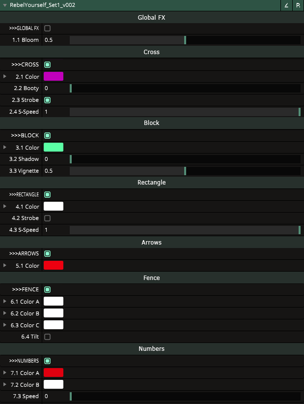

Ah... and.. I do have a feature wish for wire ;)
I would like a function to visually separate the value parameters which are shown in Resolume.
For example like this:
Best wishes
edwin

We are looking into offering a way to add a divider to the parameters and also a way to group them. So that is definitely on our roadmap.

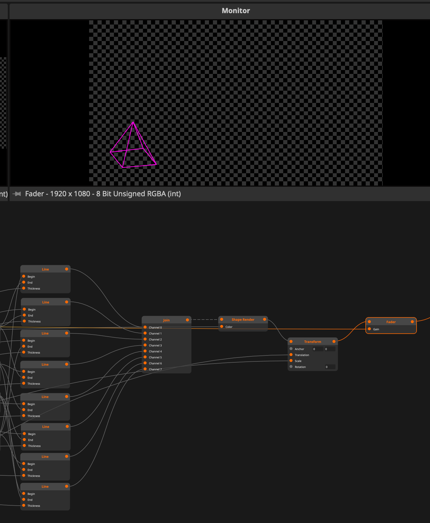

Regarding your patch. One obvious optimisation i see is the way you render the 3d pyramid, you render all the lines separately, best is to join all the lines using the join node and render all lines in one go with the Shape Render. A shape render can render multiple shapes at once. Now you need 8 shape render nodes and a video mixer. All those can be replaced by one Shape Render node.

Also i see quite a few Fader nodes, most of the time they just control the opacity.
Each fader node means an extra render pass, so best to combine them when possible or just set the opacity of the corresponding input in the video mixer. This will save quite quite a few render passes, moreover when the opacity is 0 for an input in the Video Mixer it will be skipped and is thus more performant.

edwin wrote: Sun Mar 06, 2022 19:11 best is to join all the lines using the join node and render all lines in one go with the Shape Render.
ah damn... this was an relic. I've needed every line to be in a different color while building the pyramid, so I can keep track of what I am doing. I'll change that.
edwin wrote: Sun Mar 06, 2022 21:00 Each fader node means an extra render pass,
Ah okay... didn't know that. Thank you edwin.

Could we also get those dividers to be collapsible like the internal Arena FX like Meta Shape, etc. That way we can have UI "sections" and if users don't want to use that section they can collapse it (having an option to default collapsed would be great too) <3
Yes that is what I meant with Grouping.

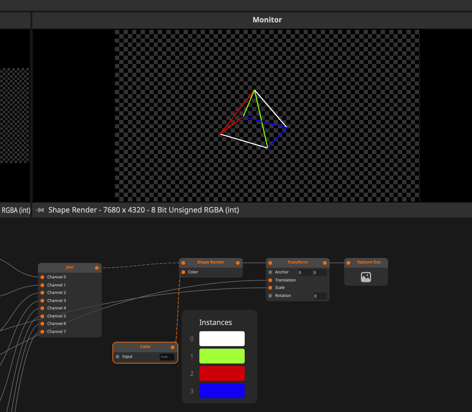

You can also send in an array of colors to one Shape Render node, array size does not need to match, you can provide 2 colors and it will alternate between them as well.

hmm i see, and how would I be able to identify which color belongs to which line node path..... sure I could try to remember it.... but I have a potato brain ;)

You can join multiple color in nodes to feed the shape render node with instanced colors. This way you have individual widgets for the colors and you can give them a name. Something like this:
