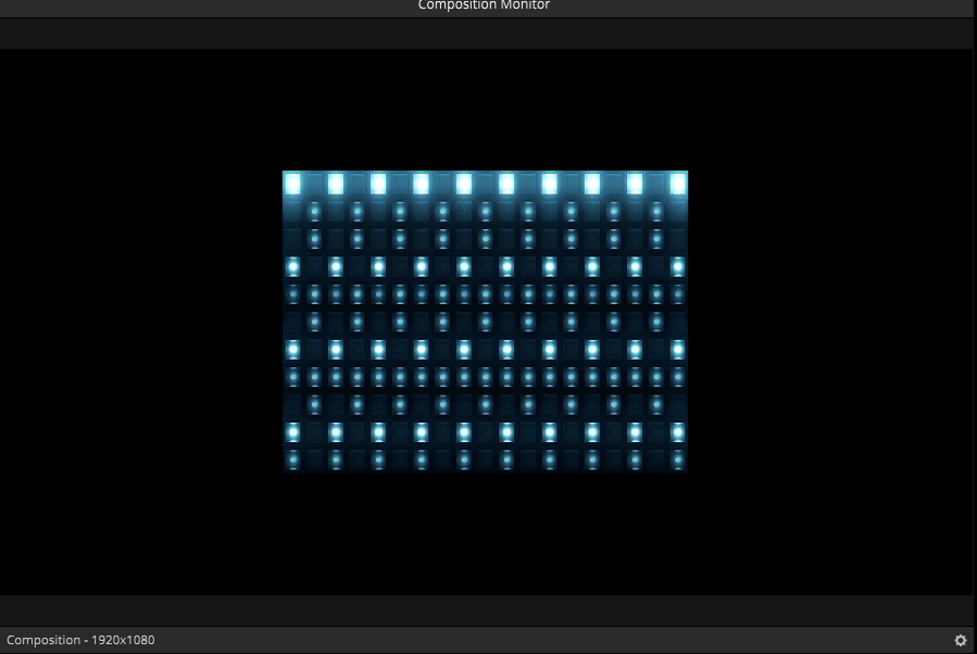

I have a png graphic (1920x1080) included in the patch which should functioning as an image frame.
Resolume should take everything and scale it into this frame. This seems to work fine with a comp size of 1920x1080...but with a comp size for example 5000x1080 the image stretches over the borders of the png frame when the Resolume layer properties are set to "fill" or "stretch"

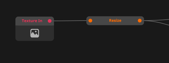

I may have figured it out myself.... I need to place a -resize- node (stretch) after the TextureIN which resizes the comp back to 1920x1080..And from that point...I can treat it like I want it...no matter what comp size is used.

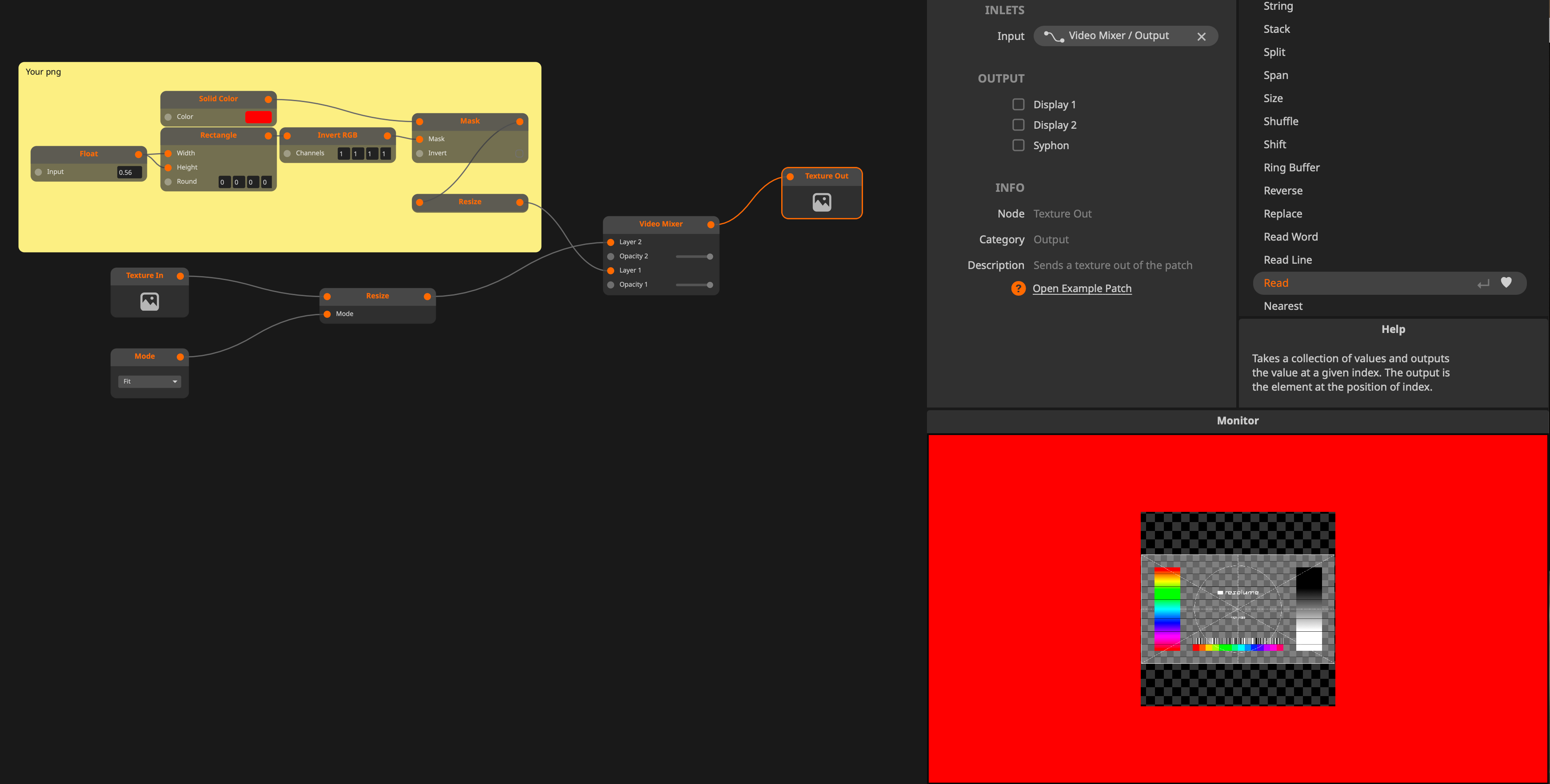

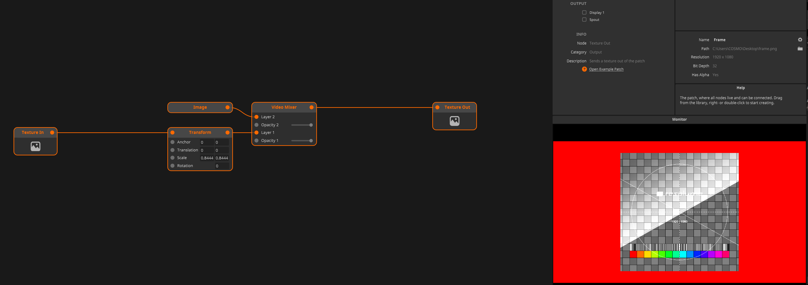

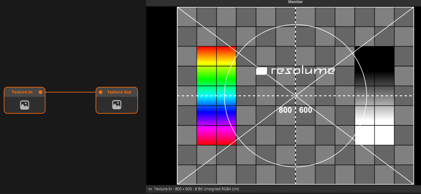

This should about do it I think:
--begin-wire-patch--
1449.3oc2Xs1ahaDE8uBxepUhwZd+Hey1XZWotsU6VUopl7Aiw.VqwFAC6lzU4+duyfSLI7HNcY2JsfDAlblW2yYN263OGj2TWWjaKap2Db0e+4fYqaVBegNLnYqc0VavMCCrMPKjgAKalVDby8CeDE6.ThgAk09F1CF+.XxiASbLXKy17gmfR8.J7ivfkwmJmZWzCbKJJmu3oSK9XaU+pC+DbjCGPcKP5S.pOX.MGa6JObdOwDelYl.Huo86NBL.GLLf5fUCjEzxmgVfOxr10kS1Z20TY8FaVc9teXuaUQvUA0aWNoXMz6OlUsEZfb+8CClzrsdpGUaf6JM8gf8UDFD5tM3JDkFRHbEVY3RkRw3LEvk2EbESHCkToQyjbpPoITALn4UYa1sLlByqRIMJpTfhoQTDOgjfzI7DD0PDiT5jDcpwspJVuADoAWg8iPS9Gf99wxoEMv+LuopYM76YvKYFF6axuGss6WWXtauZKt0tccAcZ21sdaUkaGunb5zhZWjrkwfHY1RWm9iccZvapC.bjCipSJsSKV4hLONQ4KZJyK5lkfeOyluXPbocvHOTXjlU07o85h+mccXS475rJGtcJCzNXcaE2e5f2sy78nOz7ChKzCT7IwJw3NzshfW.75hMMUasdl6zQkjsarfTGvuIa4ppx54mC8uTVWjsN335SgtSeZDd8IipC0ZAUy4Tll5Tg6TmFxqPcFahP7XBCoYiYnQ3T9nHYx3wZ4EQch6g7r0AtCXYssX99Ac7SjvcZ22Uro7eJ751iXGjUAhrkE01yF0KlY8x0xpp8vMooopCkc81BGllZKxOimQ3Y.ftc5y136Mk+Uy10CVUO+55SP1LhJTvkRFVKLdSmVpWqjgJEWJzTLyy2NeJhRDRzPSDClSMRcqMEgDRMZtjXHbr7bp.VBYDBL4FghTTJBONQHkBllo38WELEmSHpmoBNNukzrzyKNh66IGm9YKPLT7faGPvZ7fev84pgCFCGDF7yi9wKhYgKA1yLK3ZQHSn3ZH+ClHjsdETFMzIA.eBFkSIfz46Kuh1h6NhiA8PcW+EP8LAzp1BPOkSvu1TWbc83Rq6ippqqeuccAnqu1mKts6nlYy1TbtDXtHNv2yKNqSW7Vq0sZt.E.wMz9mhQjMkg3YLAxvlJPExYEhbProD3KcAPGHFHmu1m25DG.B1EsVRBVdv4OIMTHMT3zGUXTxGO.Rn3Pk.NSZ3FHP6c0OcnjOchDwgypHcVlBA48kzI4btgQ9RCkGTkDn9y1SqhCcqq0tM6yAw6PA25v+9l6eLBbtA7TY0ygk07JO0vuXoG5m47tN9duIQeqD6TjqP+J31TcZBhOlDiLXRDBrUSHX9HVLV8kxsStaU6TdzpalkUswUdS6vbZxk3IWxMO8PU6n2weuuopb5fD+nAHEWzCWGI7SkDe7mvzRE4wpedUmrjTNFNOknPZ7HH2FIAaRjhzQ5weqh9KxpqKp1bdBv+9lGJh40d2uCnp2TCaM6f28SwNlR9U6J06UEhio3bllu2AEi7UPUIwZvDLRNFEEEGgv.QwSzwwhDx2Vp57UgzeJxgzQCu375enQ+2n7tE8dY+bCG.V8kTITOJkdmweuqapuG6QPYrgbFVovZEGS6JOgHHuFiWSJAJqMJAYTbJBZJUPwpHBlsudhbIJq8vbfRr+EbCdNQKTlSjSb7CwP8EKenewgxgP84psjdwu9yKlgkvHGP1ZrLjJkJ35rRU2UbgZPCwfUhRoYzWfminJvhejDiLDRBJRqiIwoRlzD8Mx2n8Qa1OGA+ye8RbgHxtqhjkWZuibZs3dnnmC0wcWd10r9SWfavaKusvWBf4q2ypk5kGD3ZzgJifHk6c6VhVGpYZinye3L2tMMEtc6HlFoSSEHbZbDOIdDNJM8+imS6gOf1eCFi6aOksc8tH282+u.YL35F
--end-wire-patch--
Try replacing the nodes above the comment with your png.

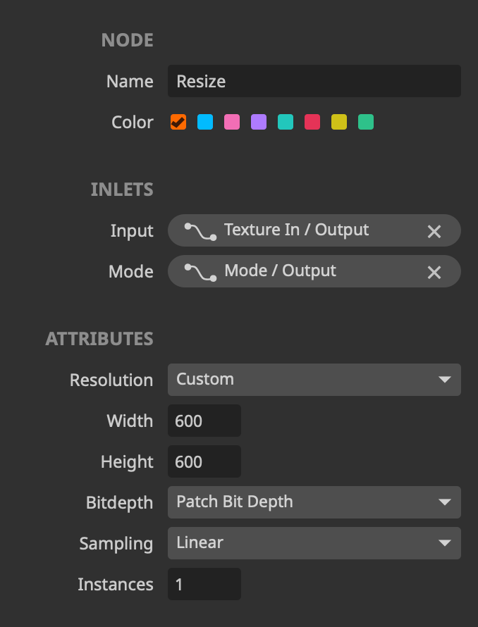

The resize on the texture in is set to the resolution you want to scale it to, and you can use the resize modes to set the scaling.

Zoltán wrote: Wed Aug 10, 2022 11:28 This should about do it I think:
Thank you very very much Zoltán for your extra effort.
I've tested your solution and it works for the texture scaling inside the frame - Great.
But when the composition resolution for example is 800x600...the frame is out of bounce ;)
Best wishes
cosmwoe
