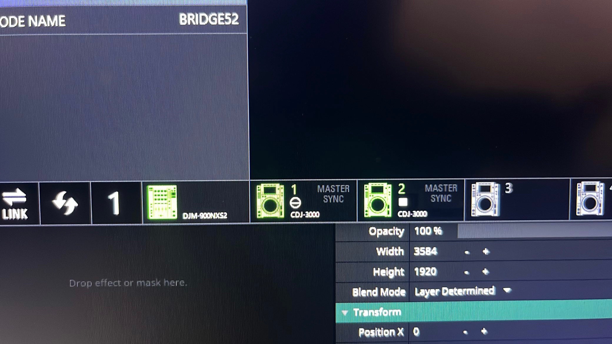

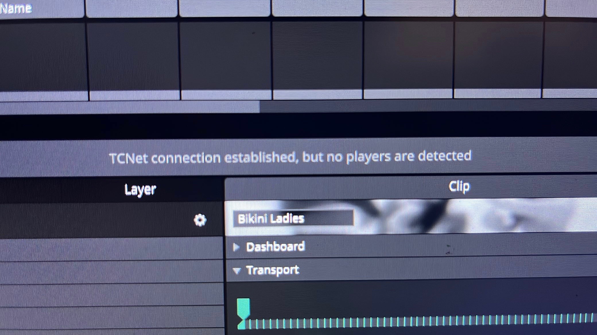

Hi guys
So I am using Resolume 7.13 CDJ 3000 with DJM 900NXS2 along with Pro DJ link all updated to latest versions.
Everything is running on the same network. Pro dj link is showing the players and the mixer but Resolume is not.
It says “TCNet connection is established but no players are detected”
Any idea what could be the issue?

Can you post some shots of the Resolume Preferences and the Pioneer TCNet interface settings?
Firewalls off?
Do you have any virtual network adapters enabled?

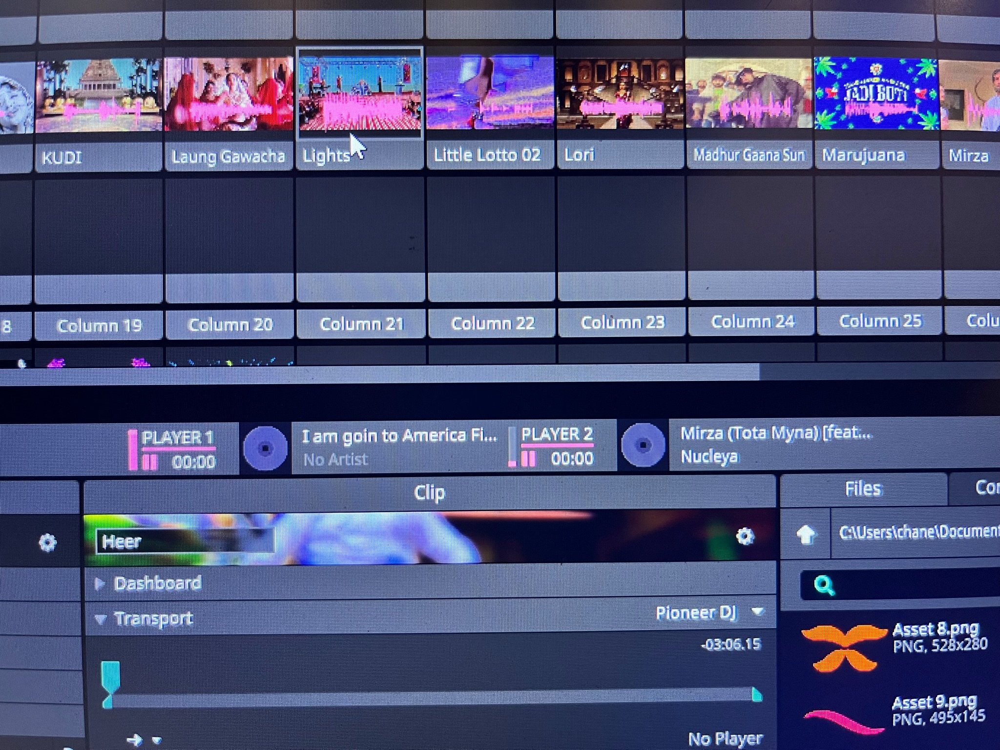

Hey
So somehow i managed to get it connected but now im facing another issue. So everything is working fine, only when i play the track on cdjs the resolume clip doesnt play. It loads when the track loads on the specified layer also the fader is reacting but the clip doesnt play
I have attached the image below

Hey so i manged to get the players show in resolume, but now im facing another issue. So when I load a track on cdj it triggers the clip in resolume also the fader is reacting but when i hit play on cdjs it doesnt play in resolume.

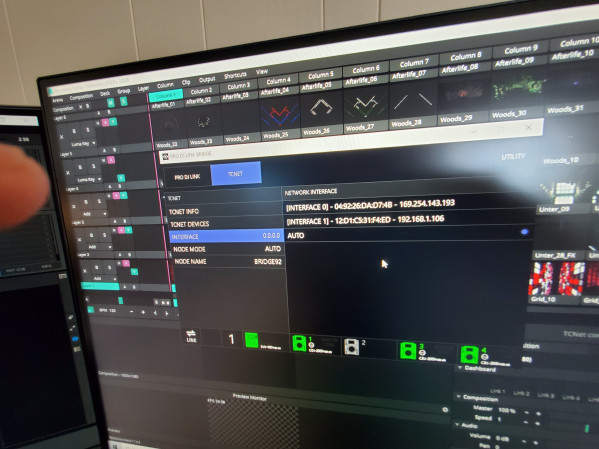

Zoltán wrote: Wed Aug 10, 2022 08:55 Can you post some shots of the Resolume Preferences and the Pioneer TCNet interface settings?
Firewalls off?
Posts: 7710
Re: Resolume not detecting Pioneer CDJ
Select the one with the 169.x.x.x. IP , and select the same interface in Resolume too.
Also set Tcnet node mode to Server.

Post by Surrealist TV »
I have Node set to server, the same ip selected in prodjlink and resolume, green decks on dj link but resolume says TCNet established but no players are detected.
