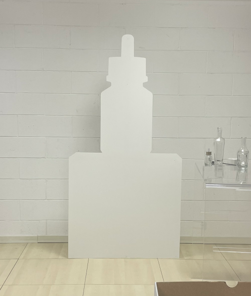

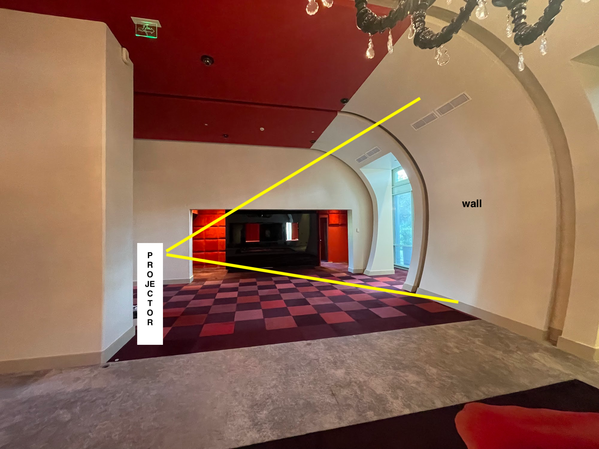

Each wall is slightly curved inside (See attached file A)

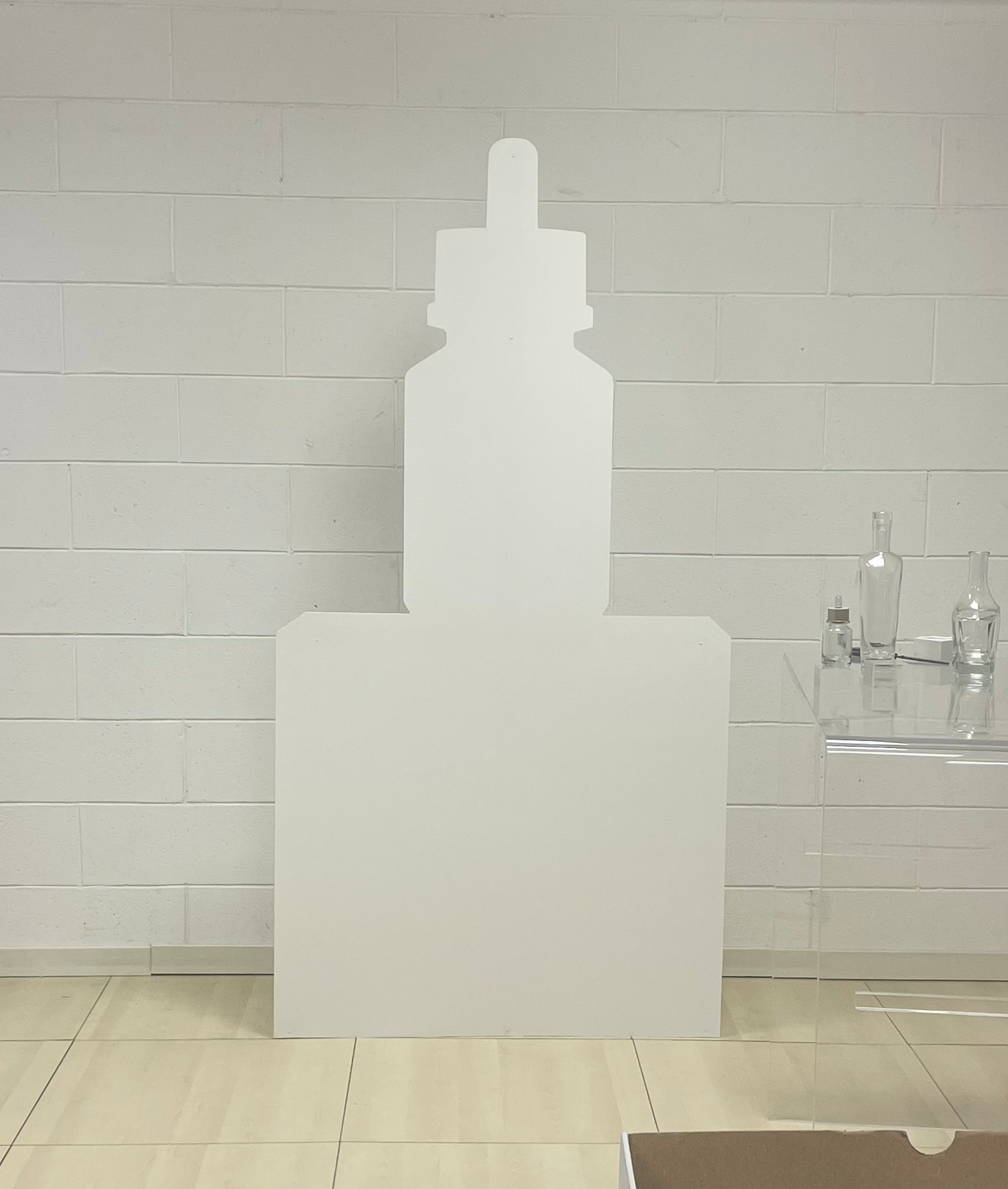

And we will have a physical shape on the front (See B)
We have on board a CGI artist not familiar with mapping.
I and others Resolume users have evaluated some solutions, but I'm always open to someone who maybe had similar projects.
We've been talking pros and cons about slices, mask, input mask, and polygon... but I'm not sure if giving the height and distance and lens of the projector to the animator can help, once on location adjust the position until it's perfect it's the best and fastest way to go.
Any Tip?

Posts: 7710
Re: Project over data path fx4 with slices/mask/???
I don't think the projector will be in a good position there if you expect people to walk there.
You can adjust for the wall curve in the output transformation, you probably need to curve the edges inside on your slices to correct for the distance/size increase.
https://resolume.com/support/en/output- ... er-warping
You'll have focus issues because of the different distances to the lens, but that can't really be fixed, so expect it to happen.
The whole thing will look really different from different view positions.

Zoltán wrote: Wed Sep 07, 2022 08:59 I don't think the projector will be in a good position there if you expect people to walk there.
I mentioned the focus issue to the client, and no one will pass there.
Thank you, Zoltan.
