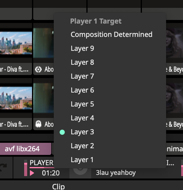

I'm not having luck with the assignment of a clip to the pioneer player determined.
No matter what I am setting the deck to, my first deck is going to layer 1 and the second deck, layer 2.
I want to assign them to 4 & 5 so that I can have other footage underneath.
Latest Resolume, MacOs 12.6
Pioneer ProLink Bridge 1.13 doesn't work on Mac M1 12.6 Using 1.10 instead. everything else seems to work except the target.
Thanks in advance.

Pioneer player determined will use the layer you set after right clicking the player
You'd also need to set the Clip target via the clip menu to pioneer determined, or the Composition Target and leave the clips on Composition determined
Bridge 1.10 won't have all the features Resolume needs, you'd need the one released in June.
Works fine for me on Ventura, make sure Firewalls are disabled.

Thank you. This is exactly what I'm doing so I'll chalk that up to Pioneer then with version 1.10. Unfortunately, 1.13 doesn't work for me on the M1 Mac. And can't really get it working on my Windows 10 machine. (ProLinkBridge works but Resolume doesn't see the timecode changing :-) )
