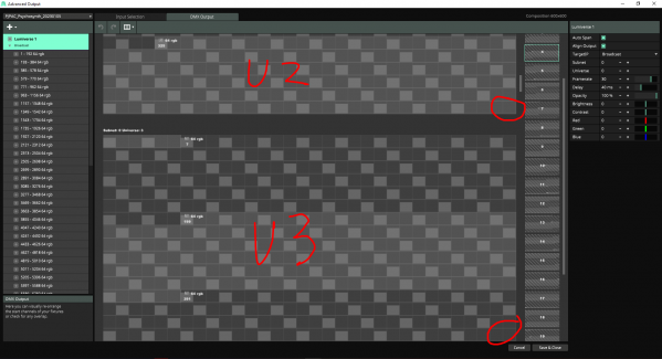

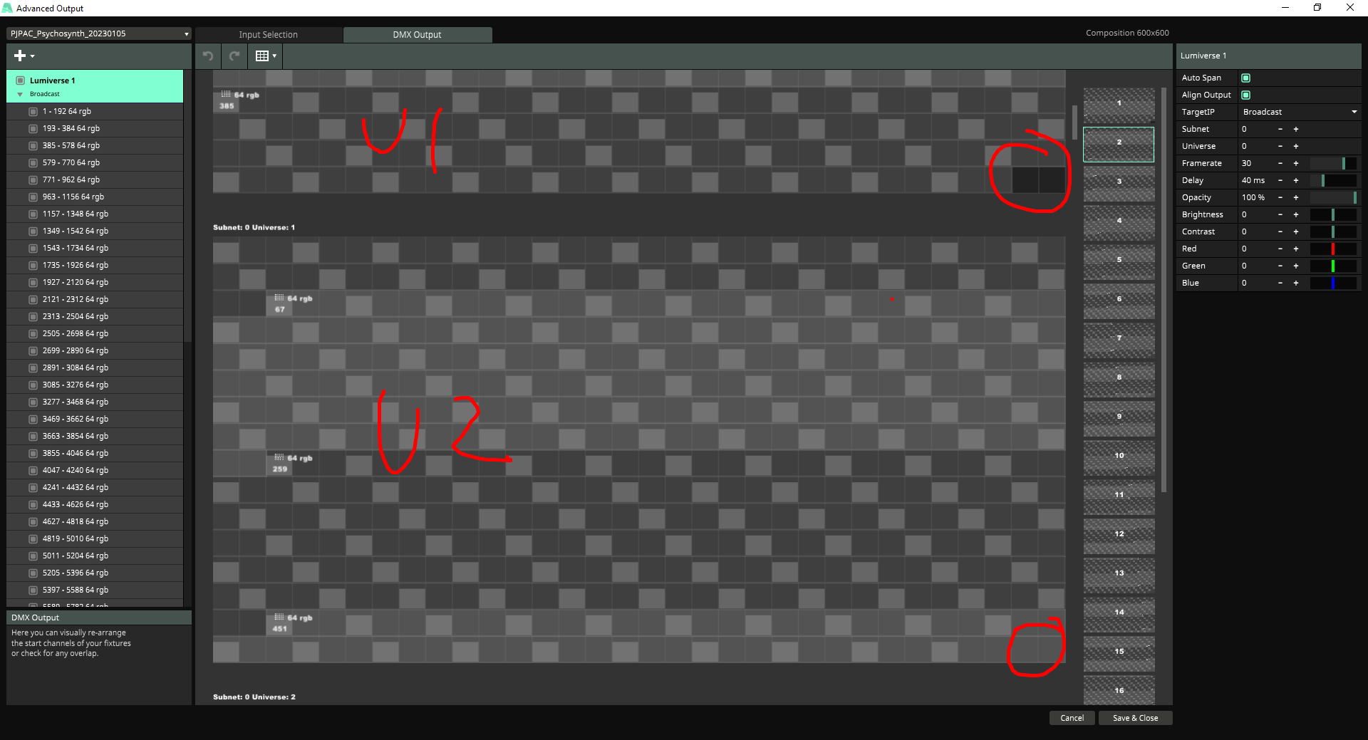

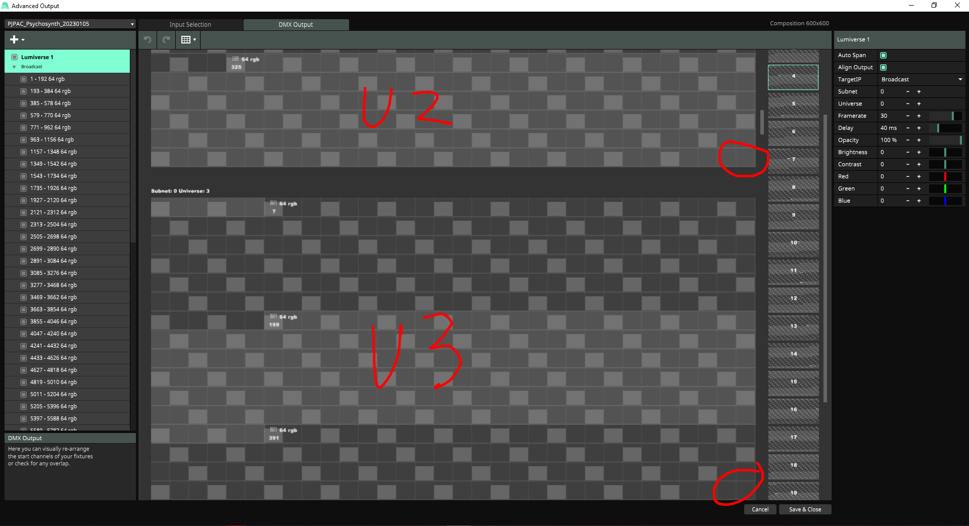

Arena 7.13.2 rev17774 23 September 2022
Windows 10 19044.2364
As I later found out when I was working on pixel mapping, Resolume uses the Auto Span + Align output feature to handle overlapping fixtures across Universes. This is usually accomplish by skipping channels 511 and 512 for each universe, and it does this for all of the universes. However in the DMX Output UI, only the extra 511 and 512 channels for the first Universe was indicated with a darker black, and the others were just greyed out like the rest of the active universes, this is caused me some confusion and i had to count the active universes to finally understand that it has been excluded. Would be great if they were darkened as well.
