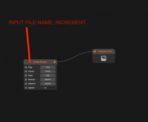

I am still on the search for the best and easiest way to simply play a series of videos in a folder.
Imagine there is a folder called "Weekday" and another called "Weekend".
Now imagine I create a Resolume file for each.
Then, imagine that when Resolume "Weekday" launches it looks at the "Weekday" folder and then plays all of the videos in it in a loop, one after another. Same for "Weekend".
Now here is the sauce. I can then drag and drop new video files into the folder and the next time Resolume "Weekday" launches it re-looks at the folder and puts the new files in there and removes the old ones. Or rather it just only and always plays whatever it finds in there.
I took a look at Wire, which is cool, but I didn't see any patches for files or file names, etc. Just video player. See screenshot. I could totally be missing this...
I have written this in Processing but it is buggy and won't do 4k60. Same with Quartz Composer but it's a dinosaur with memory leaks...
I am looking into how to do this in MadMapper... Nothing yet though...
But.... I would really prefer doing it in Resolume.
Any ideas on how to make this happen?
As always, thanks for the great product!
