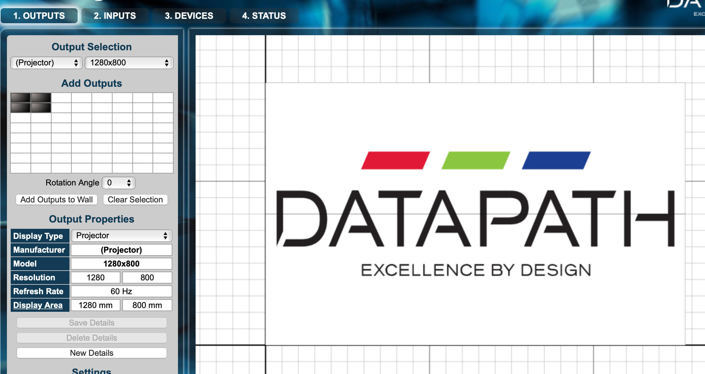

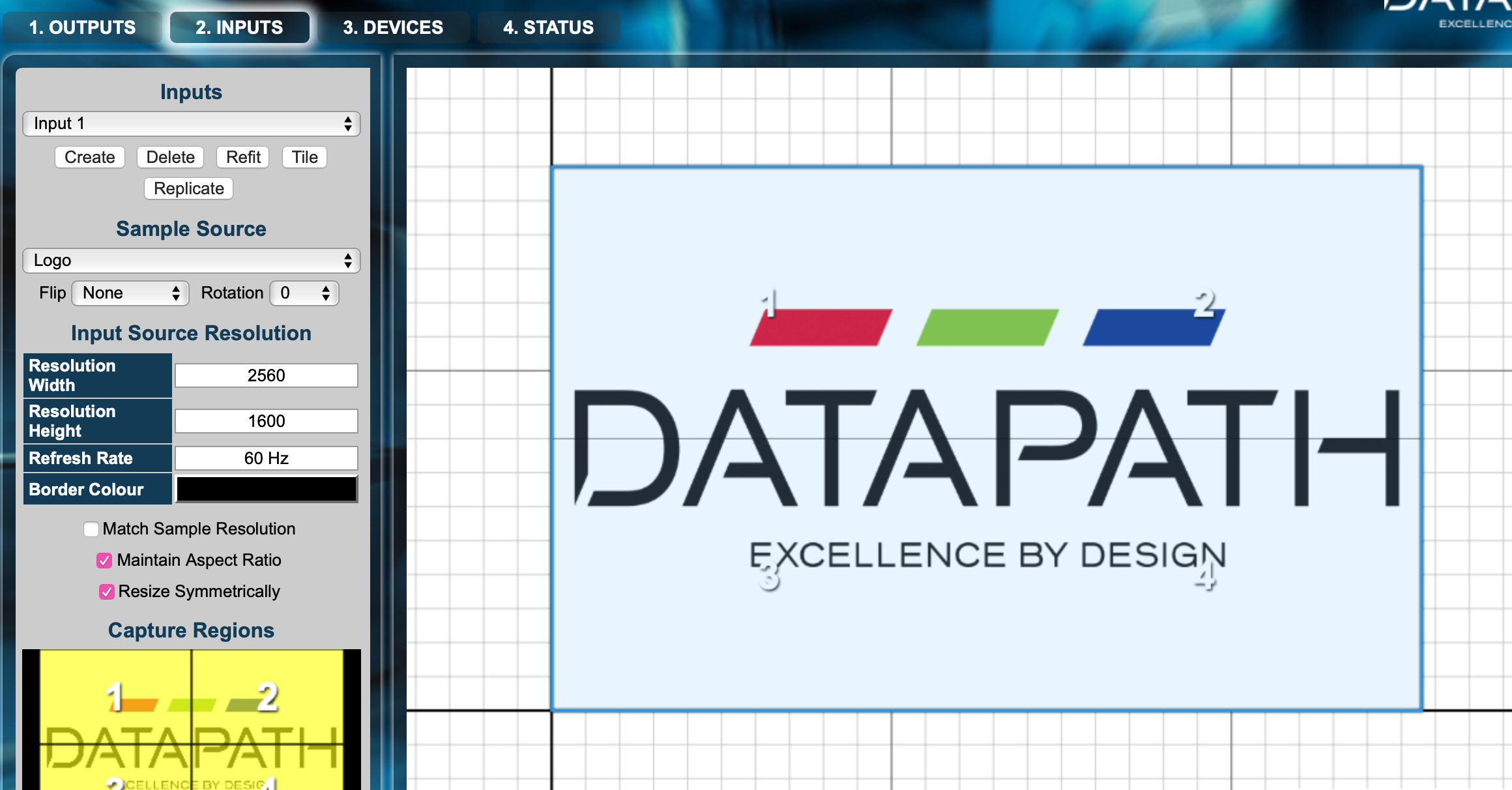

I assume you want four equal sized outputs of 1280 x 800 and 2560 x 1600 input (4x1280x800 split into equal quarters).

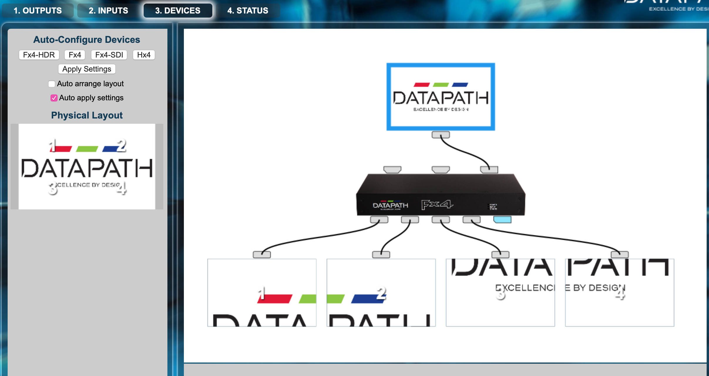

Add four projectors at the resolution you want, click on four cells, add outputs to wall. Create Input at desired overall resolution: Configure device, apply settings: Save your layout.
Repeat for 2nd and 3rd FX4's one by one, by loading the same .wdl file that you just saved.
