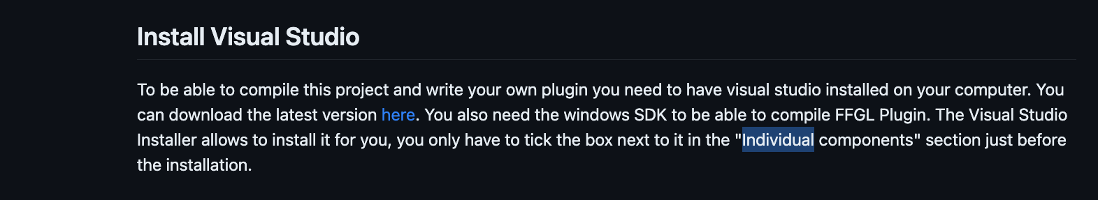

Posts: 7771
Re: Cannot build example FFGL plugins
The MSVCRTD.lib missing means that you need to install an additional package for visual studio.
In the wiki it says you need to install the Windows SDK.
https://github.com/resolume/ffgl/wiki/1.--Installation

Hm, I did do this already. . . Although, this is my first dive into coding, so probably an Id-10T error :lol:
