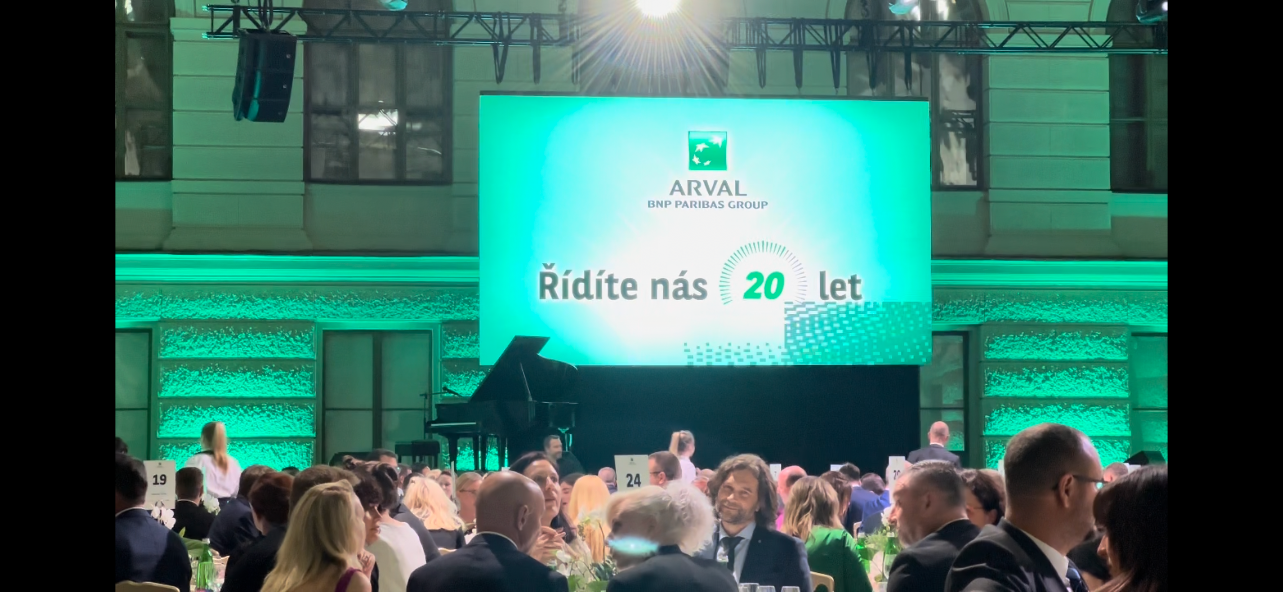

Led screen flickering in random frequency. Its looks like in picture sometimes its bigger. I think that the issue start after latest windows update.
Windows 11 latest update
RTX 3080ti lates gaming drivers
Resolume Arena 7.13.2
Only arena do this.
I try change cables and led procesor.
On MB Pro everything works fine without flickering.
So It must be windows and arena issue.

No it isn't a hardware issue on the led wall for sure because when windows is extended and left as is without resolume running it doesn't happen. Will take a video this happens next time , but you can refer the picture above posted on this thread.
Re: Led screen output glitch
Going off your picture, it looks like LED hardware issue. Did you try resending the config files to the panels?

Interesting, as I've built well over 600 LED shows this year alone, all using Resolume, and have yet to have this issue (or have I ever). in regards to the OP, the way the panels have repeating pixel info, shows that it's a rconfig issue. If it was an issue with a single programs output, wouldn't the entire output be glitchy and not just a small corner?
For your video, what is your system specs and what is the signal flow from your system to your LED hardware all the way to your panels? (I like the ceiling LED, I've done a few gigs with a very similar size and setup :) )
