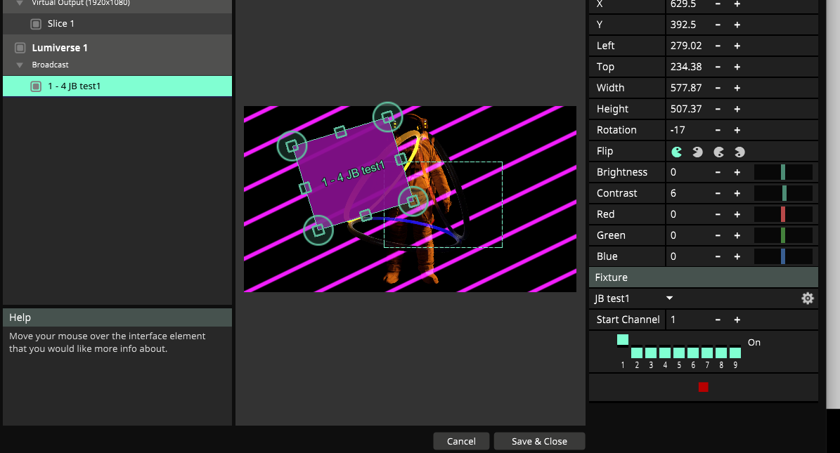

However, my problem is the basic plain understanding of how to really setup my very first simple LED light, like just a plain stage LED spot, not even a LED panel. So what I have done is to set a channel on the LED spotlight (here on the spotlight Cameo CLPFLAT1RGBWIRWH, I can choose a channel and I chose "001" (as I dont think I can choose an interval on the fixture) , I have found the fixture menu in resolume arena and added A LED fixture with 4 channels, rgbw (without really understanding what to choose) and then I opened the output advanced, specified the same IP as on the Showtech NET adaptor and then to tried to reach AND START my spotlight by also playing content recommended in tutorials (a moving line). I would easily pay any of you 20 euro for a 10 min video meeting resulting in me being successfull activating my first spotlight slash fixture. I dont have time sitting failing for more than these already lost days behind me as I need to prepare so so many things as my debut "Ai Accident" gig quickly is approaching (making projector masking movies in my beloved davinchi resolve and building full size mechanical robots from modified H&M mannequins just being a few things). Plese help!
Disclaimer: Is the fail due to that I am in the trial version of resolume ? If I managed to start my LED fixtures, my plan is to buy the full program directly.
Details: There is a red lamp under the fixture down to the right that is flashing. And also my attempted fixture setup entitled 1-4 JB test looks active when I run the moving lines (as it flashes) I added an attachment here if of interest.

This one?
Képernyőfotó 2023-10-31 - 12.17.48.png (20.89 KiB) Viewed 7722 times
It's a white only fixture.
I'd do L type fixture in Resolume and set the par to 1 channel mode.

Ok, use RGB Resolume fixture and the 3 channel mode then
https://www.adamhall.com/shop/ag-en/dow ... 1781916432
Resolume indeed is designed towards video, but DMX control is just numbers.
You can make a simple DMX controller out of Resolume using greyscale controls mapped to L Fixtures to convert the brightness to a number.
Here is a Wire patch which can help: https://palffyzoltan.hu/?url=programs&a=dmxhelperwire
