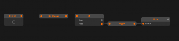

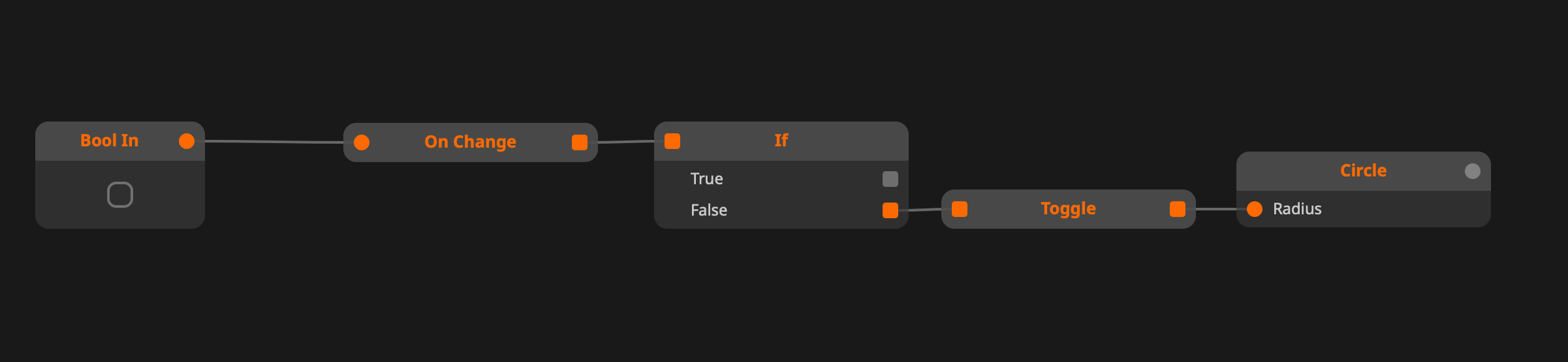

I think the easiest way of doing that would probably be the if node. Something like this.

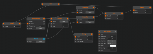

Thanks for your replies, but I still don't get it. I've come up with a simple example for my problem:
--begin-wire-patch--
1502.3ocuXs0iiZCE9uREOGh7M.y71jaR8gtUZ6JUotZzJC3jwsbIKXlcSWM+26w.I.CDByNiZhThw53i8478ctX9gUXVZpLTqxRKrt6y+vZedVBL.uvRmqNbPla8.LLClB0YpmWbQRX5rR8wRM5hjjEVpz5Y5HHYnfzQEjNTP1nBxFJHbtkohfXYzsNjtipR2gB5zHXO47FJGrG4xB4bjq0O9Pix+87H3469L7bhTKrt6GVhR8iYvbVVKrBEZ4gr7SV2kVFGuvJRdLN6ThLU+IQ9AXOA4CxEogOVKepHQBi9SUtDd5IYdA.vFgRD+sQmvwJQkZFg4KrNJzlEhd9YilKByUG0UxaTUjp3Xr3zGp0HLgJB1V0dk47Z4uOfxEt6sco781LFUXKjHtsifIjAXbjWHAVSrJTlVH2ohaTRyDsZMQnhqGkANGUpH9czxvFK6qkhXkFbgTB2wsBrxhK0MK+Qo5vivtgQb.f9lJRaVmOAAqrP7j789znerLIH8hQWl2L3IYZTMpCBkJ+t9CYQxeMx5NX8ovvBi1QU7CMPiBJ00SoRKzv4p9A8oilikJEXM.LAZUDWJa14frxznh91raGSF36e25NGNZIh5fcbIvDfWi4iV5hnDLhw7IXtmCnqvXQQ81CmPKOOWeOhqi85M701rstt1bXI1TDFug4R7Qtq65lvUZHK7ef09DPqxLL8r3JyeO7wUfPUSUYa5pMpNDq0FOGJcwFMAHFLSKx6J293LgtUJZkHxiWWBayo6r1u09Ah9nJBBLfP3NPwCWXHqAmttZYW.9u7jpPEXBHz4kRPC32YTkhFfpTF5UCl61.+v7P6r8244XucC2iSb874nsuUv7bp5ViKHKKt0x1KhKLdl84xuVJSCOcc3xr8yiabErxbz.LpCl8aRcdVZVhbRTiLD0fi125eR+V6YvRBg3ZSzcc4G6HEjGunt.7Tf7kETKRqUZ9qU809kyRiespGOW0qyhklLgxqiIPFDje8GfMw3DG93TUNY.SkS3KOm3AuDOSt5p6c1ZybWaFsy0lRW63duytU6XrtbUxOAWsoYgqarW7fSISOxWCwnKrNFqnOxLFv1EMZ4uaMU7lj6R++h6NJpOR9IlKdIARs.+6iYny0dnL5RtuqGT3tpfz0I.2ucK0lsxei8pUabrcueCyLXyJJ5slrZ.AnetpJW5DvaGWUKD8gL8j.D6sBPSGLWYAUBOqxLKplL+XVr3baSuRH2gO.x8IMw4N.HO23b1psPbNmZpIQ31XHteGAi8oaV8tGmOdIIsJQN6.89tsEWKveXaCajPq2SxPbFxPBTZ39AFe70wGS1p8YocqVV.5H8PG1w84JwqidjKiJ6UPXjPjtMdaKBpFNvSRZWzmMMguvzV9C8WaBzM7sLwNhmKMt+mldqVfenpwvSwxo7LeTdnLVjaMNImPF1NMzhseCO2kL+5YaIagFo2gWY6iv2aud6t0LO1F5ZjWWdN8mfmCWF5Pp4Fj2BTuHHrc2T3fSGaLjIidN.A.pzoKlZjAt67Lp3NETgLD3XUprAPtZ+i0W0KAtncEs+EBx5yRVzvTfymQ2M95oVBB91cI233XNKGyJTuHO6.FKn1JFanHVNcywEGEgFWysTV+RXlTDmCHVzqa4Fj9E9fWXeWP5V3bXL73goimmXQa1sKoaZSW9I39x+xGgaPeiaZ4NLoYjLTk.ryaTw7Lo+4EuqEh6zz9LS0Bm8j+RlmIKlUM9YeueN4RdJleUdJOLiynSkkxg6PrYLGlM2WBMcgEDVnTPhbPu0pwmgkakneNcm25xtQ9ow6hqk52utcelyPjokd9GmSNcclo2666.Xj9snT.fcPN9bL.YTbSK1t97kLOWWNywCYl85vsqeDylI7w17HlzlfETFIzWfI342iMhDDre+Ma95m70s7wp2Dv0czMsFTlW6VgGKUlcMDVdd0aeE7T0upD32+My7tbqRhJiqeY4lM1PVMVrIEJ0xzrtocLS1ECNBYR+OPoyvAC
--end-wire-patch--
The Equal & Not nodes stop the metronome when the counter reaches 0. The "Reset" Trigger (blue) resets the counter and also updates the display. But it also restarts the metronome, which is not intended. So how can I make the counter reset and update the number shown, but without restarting the metronome?

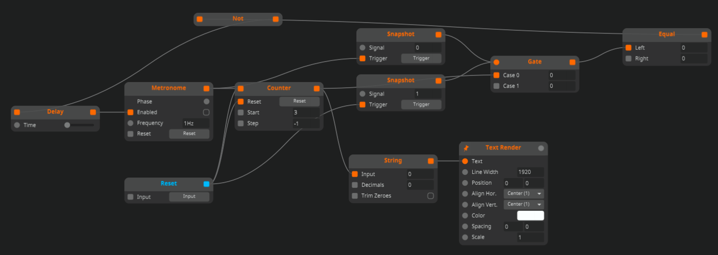

Maybe there is a smarter way to do this, but I sometimes add some snapshot nodes in between to define certain criteria:
Re: Filter data
Thanks a lot, I'll have a close look at the Snapshot node!
