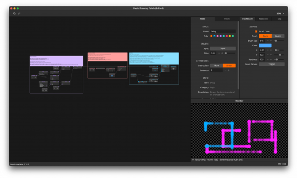

We had an user on the Slack Community asking about the drawing I did for the Wire Release video.
I'll do a video later on how to set this up using OSC, but I wanted to make a little basic drawing patch to get anybody interested in doing some freehand VJ'ing started.
WIRE PATCH (7.18)
Basic Drawing Patch.wire
(32.43 KiB) Downloaded 1936 times
INSTALLER (7.18)
Basic Drawing Patch.wired
(20.59 KiB) Downloaded 1856 times

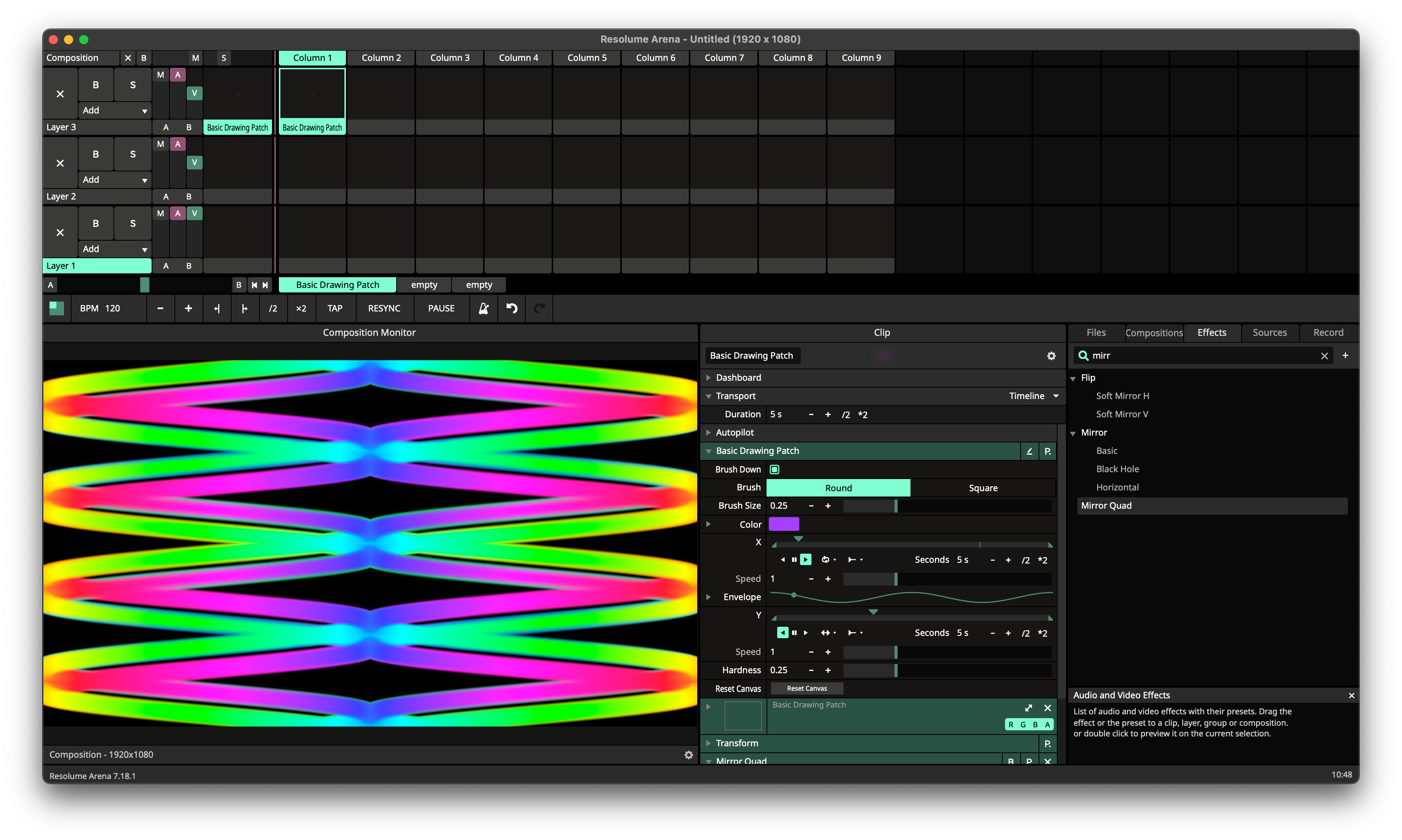

The Installer is just here for people who are browsing this forum, do not own Wire, but do want to use the "plugin". To install : simply open the file and hit install. It should be in your sources tab.

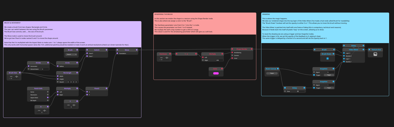

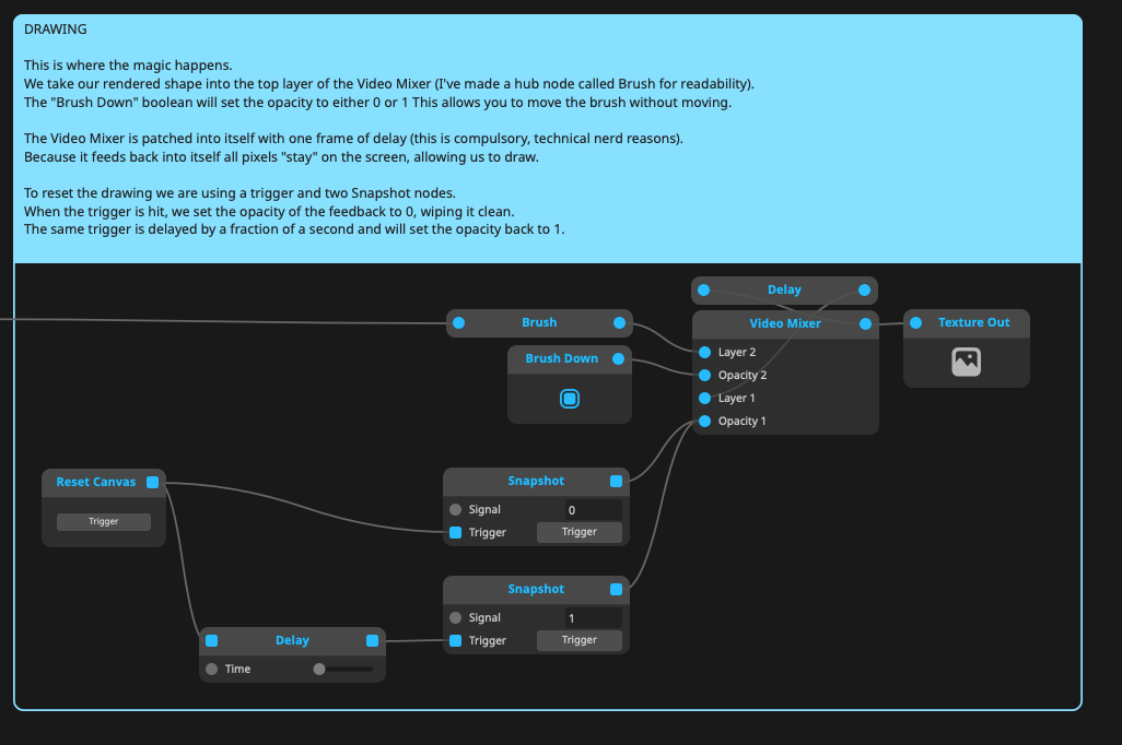

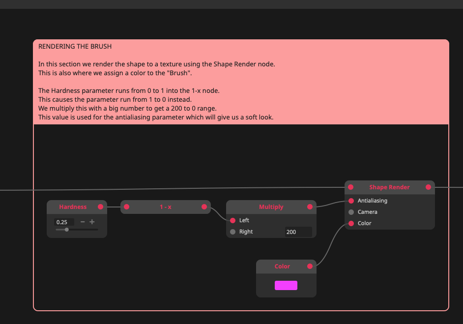

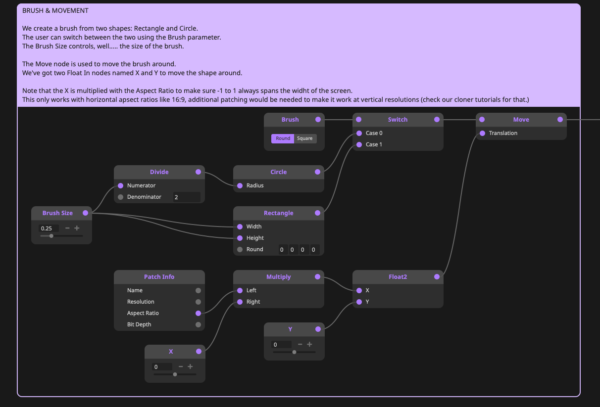

Here are some screenshots of the patch. You might be able to recreate it on your current version.

I have since been able to successfully install the plugin as a source in Resolume AND renewed my license to the latest version of Wire which means I can be sure to have the resources to explore the patch in Wire and follow your instructions.

Before I try to edit the drawing patch in Wire I had a play with it in Resolume by using sliders for the X and Y controls just to see what it's like and it's really exciting! :)
