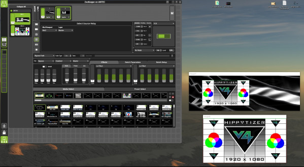

With a hippo, just take the layer, switch media player to relay, select the source from any layer or mix (group/slice), set geometry as you wish (auto fill, 1:1 pixel etc etc) and that's it. You have latency free copy of any part of the config, that you can correctly scale and position, which has the scaling anchored to the center of that signal just like in any other contents that can be faded in or out, positioned etc etc completely independently as part of the programming or show.

OK now I'm getting what you want to do and what the problem was.... See your point... It would nice if the video router could route slices, screens and/or outputs as well.... But I think i found a workaround for you though. Hope this is a solution for you, maybe....

Yep already tried this!tijnisfijn wrote: Tue Nov 14, 2023 02:06 OK now I'm getting what you want to do and what the problem was.... See your point... It would nice if the video router could route slices, screens and/or outputs as well.... But I think i found a workaround for you though. Hope this is a solution for you, maybe....![]()
This is exactly the end result I am looking for and have tried with Spout and NDI.
NDI has inherent latency built into it so not a perfect solution.
Spout is zero latency but there is a noticeable stutter to other contents playing when I load and clear the spout clip.
