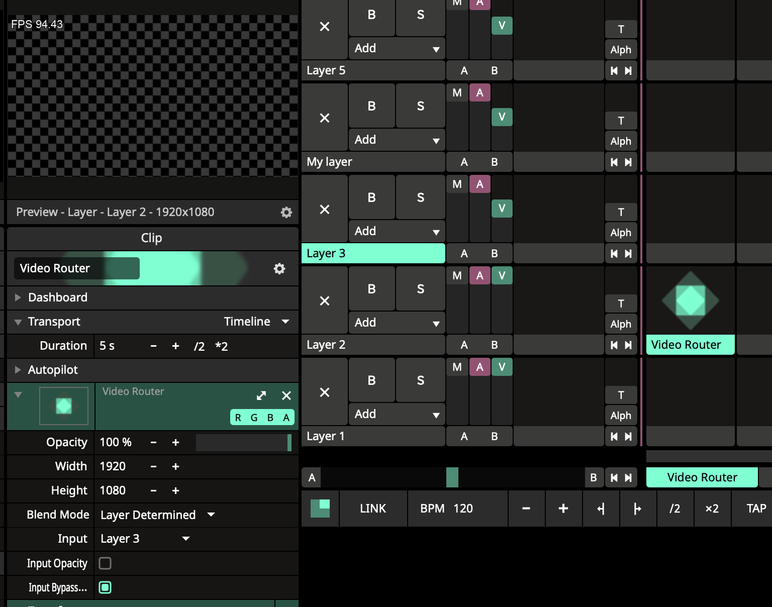

For example, here is my file before inserting a new layer:
As you can see, I have selected 'My layer' as the input for the Video Router.
This is what happens when I insert a layer below 'My layer'
You can see that the input has changed. This is unintended behaviour and not within my power to modify, as far as I'm aware.
My request would be to be able to reference a layer uniquely, instead of by its index.
Thanks for your time

Oooh is that what you ment yeah ok i get it now. I thought you ment select the layer for example to get it to show in the layer panel and then if you drag it around the number updates automatically.
Yeah that looks logical that you might want that when selecting it in a router somewhere so +1 from me.
