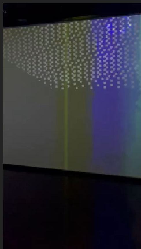

Hi i have a pc that is playing through a 4080 ti graphic card 2 clips 1920X1200 ( rendered from unreal engine ) to two different outputs in 1920X1200 projectors and playing it with resolume 7.13
The clips are 9 minutes long and the weight i 10 giga.
Sometimes i have a short glitch ( seems like a graphic card issue to me) in different points of the play.
i see the error even on the preview on the pc in resolume.
The things i thought about are:
-some masses near the cable ( actually the are shielded so should not be the problem )
- nvidia drivers to riinstall
- re-export the files from unreal, maybe in the export there occurred a problem
Thanks in advance

Looks related to viewtopic.php?t=22600, for some users it helped to set the power management mode to "Prefer Maximum Performance" in Nvidia settings, there is also an older driver version mentioned in that thread that seems to fix the problem for most users.
