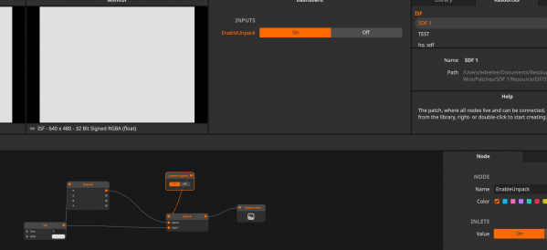

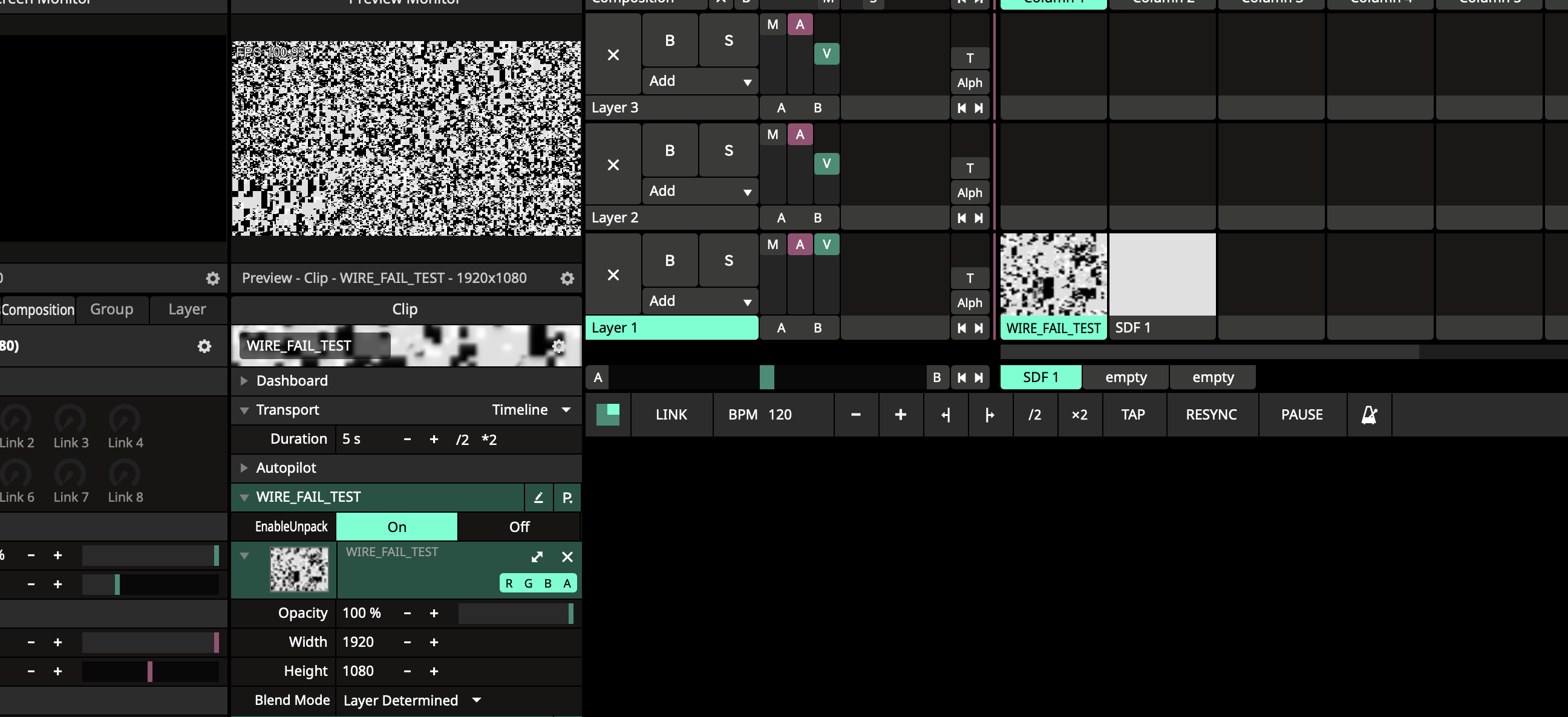

Found a bug with Wire that causes an unusable glitch texture only in Arena when trying to unpack a float texture in a Wire patch.
Here you can see the same patch viewed in both Arena and Wire:
I have attached the minimal reproducable wire patch for reference:
SDF 1.wire
(37.01 KiB) Downloaded 536 times

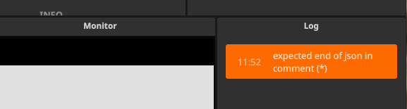

I still get an error when opening the patch
Képernyőfotó 2024-01-14 - 11.52.51.png (10.22 KiB) Viewed 37652 times

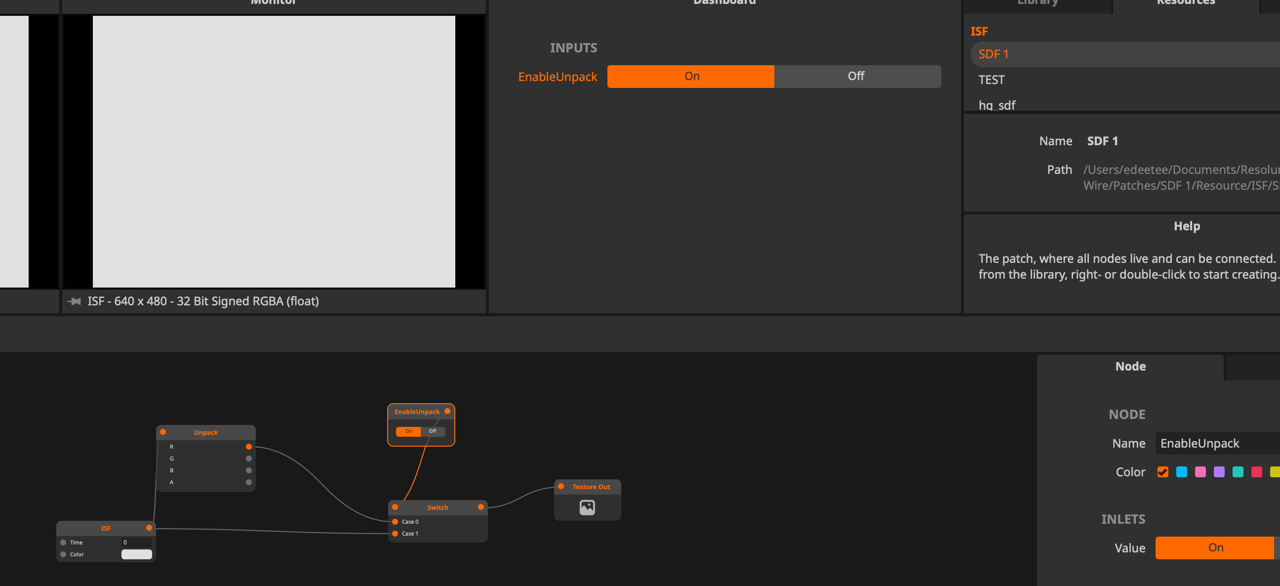

But, if I change the ISF color format in the node panel fro 32 bit float to int, I don't see the glitches any more.
Does the ISF code supposed to be generating float color format output?

It makes sense that it works if you set the isf to write as an 8bit fixed. The error I found is when unpacking a float specifically. I made this minimal example so that you can see that the error occurs.
I have work arounds as mentioned above (using another isf to pack etc). I was just making this post so that you are aware of the bug :)
Have a good day!
Posts: 7800
Re: [Wire\Arena] Error with unpacking a float texture
If I set the ISF output format to something integer, then the glitches go away for me, so it's probably indeed related to the float type unpack.
