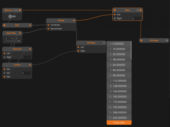

Hello!
I don't seem to get any output if using span in conjunction with the audio spectrum. Is this a limitation or is it reproduceable for others as well?
Test patch follows. With it running in Resolume connected to an audio source, this bounces. Swap the Y input of the lines with the span and it stops. I can't read an index to output to text either, so debugging is a bit difficult:

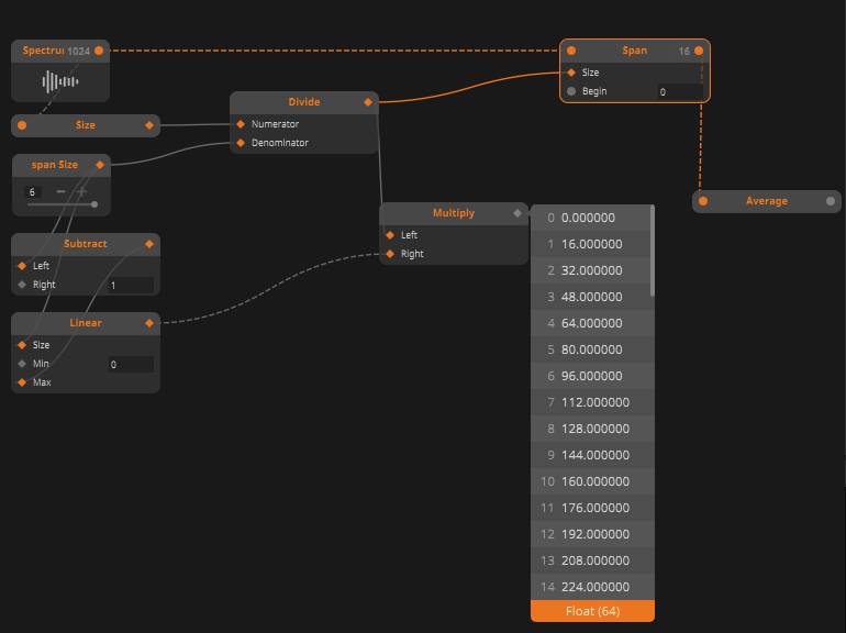

On the topic of spans; is there a way to average several spans without defining the spans separately? It seems the Begin port of the Span node can't have collection inputs.

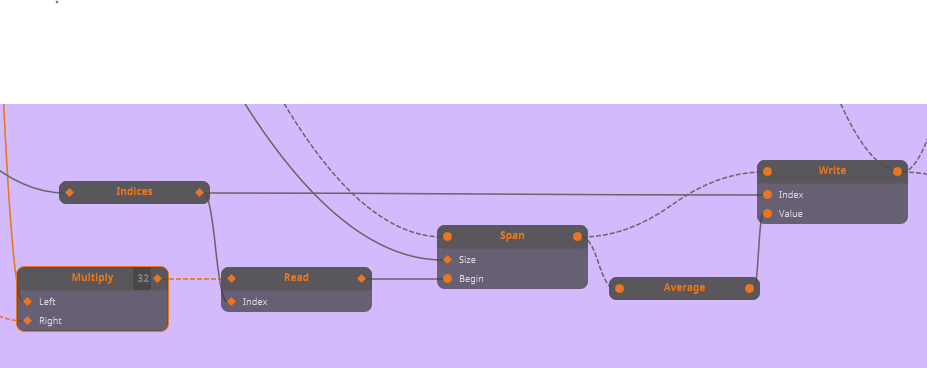

EDIT:
There is a way to do it using Write to make a new collection from read values input to the Begin port, but it feels a bit wonky.
Posts: 7808
Re: Audio spectrum, span not working?
If you can create the separate spans, Join them together, and average the Joined output.

Thank you, it can be done using read/write which I think is a bit more flexible than hard-coded as you can change the span size/amount on the fly:
It just seems a bit less straight forward than being able to do collection inputs to the Size and Begin ports. Does it also matter efficiency wise, or is it same-same?

Previously posted solution just seemingly worked, after checking with a wave generator it just displays the channels in the span, and not the average of the span.
