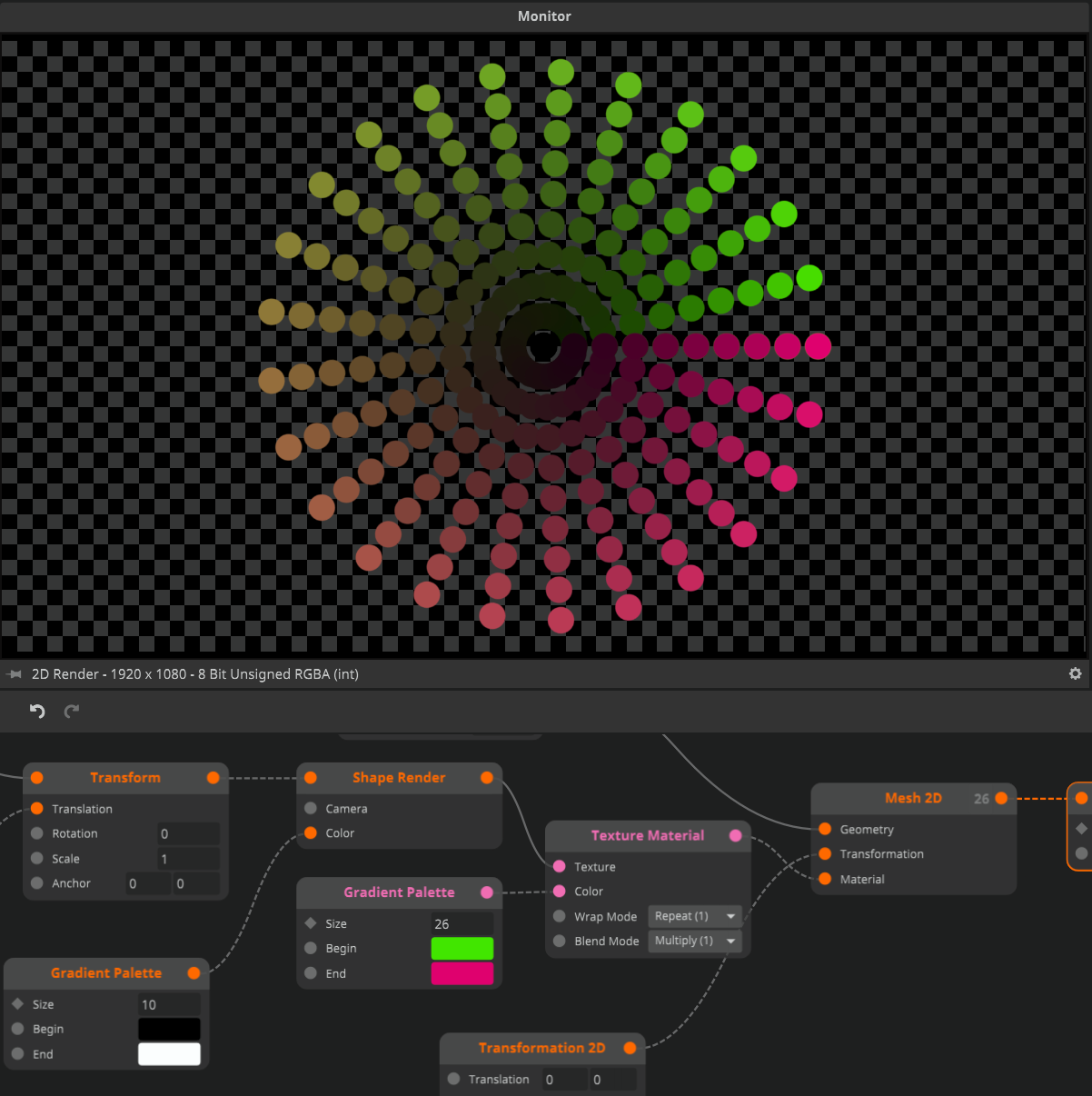

Hi I have a basic pattern created with a linear pattern patched into a transform translation which is then patched to a 2D Mesh. When I apply a gradient to the shape render it applies to each line of circles from the center. This makes sense.
How could I do this so that colors change per line? i.e. line 1 is blue, line 2 is red and so on.

Try this:
