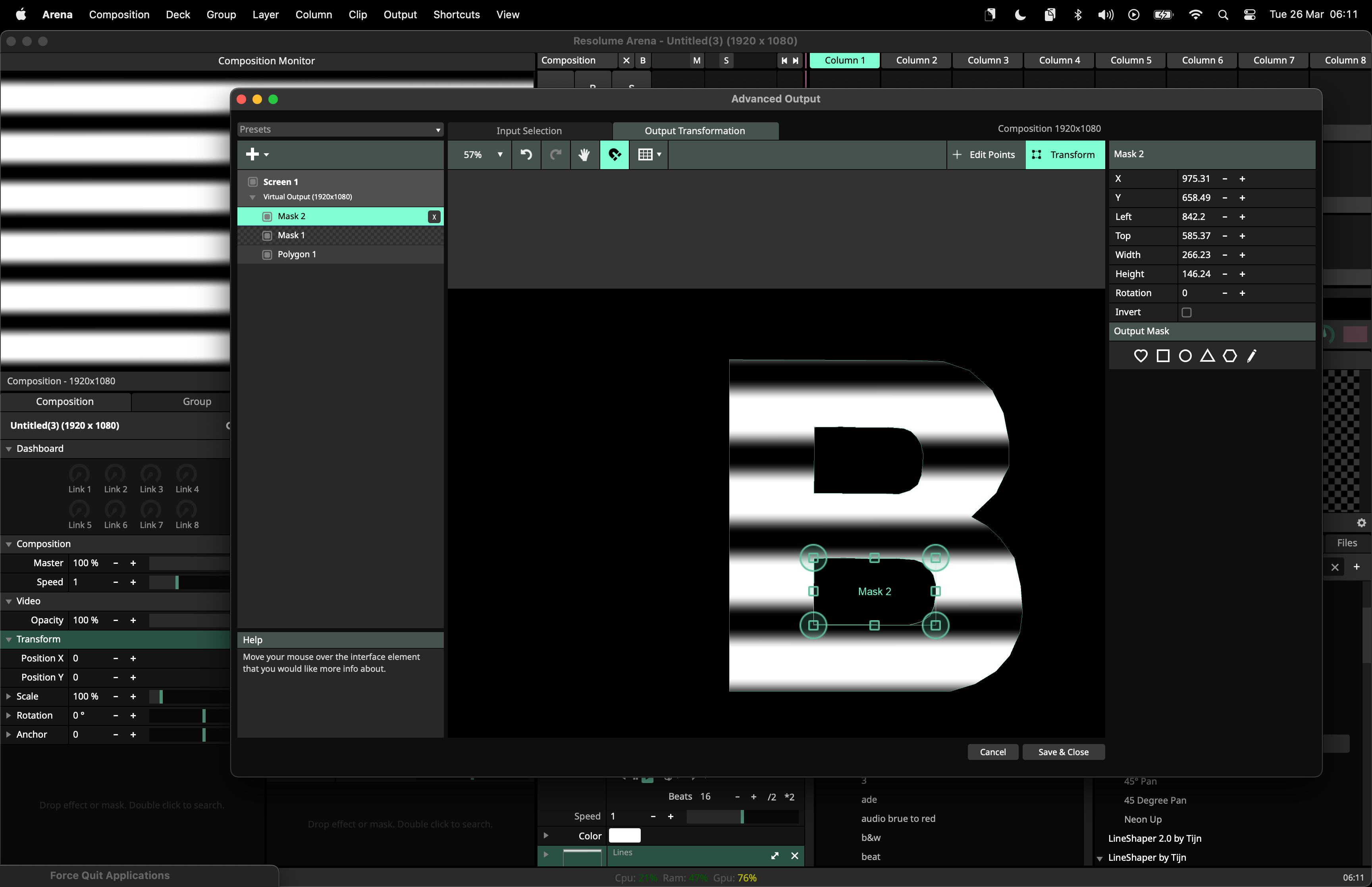

I would make some masks of the letter, just as a PNG and put them on your top layer (or the top of your b letter group). And set the top layer as mask all layer underneath.
or you could use a polygon mask instead of a slice to cut out the outline and then use two polygon masks on top of it to match at the inner parts and make sure that the masks are not on invert and on top of the polygon. See pict...
hope that helps you out...

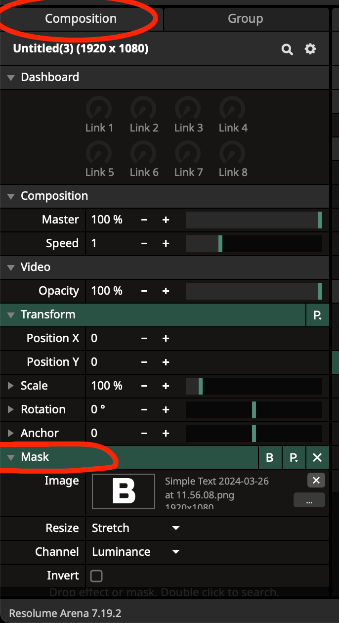

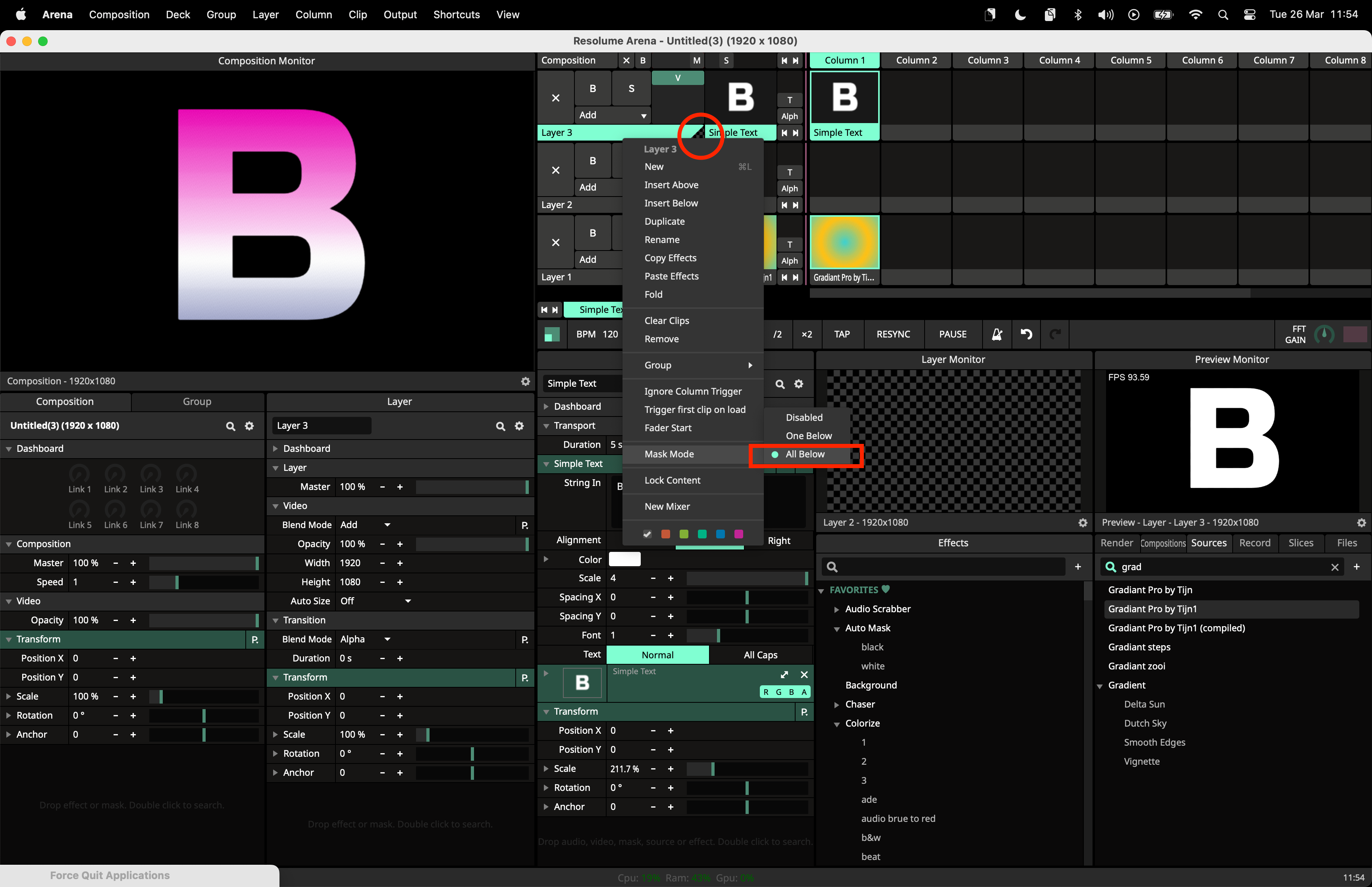

Well, actually, there are multiple ways of doing this, but what I meant is putting the PNG on the top layer. "right - Click" on that layers name and pick "mask all below" (if a layer is in Mask mode, it will get this tiny triangle next to the layer name, see pict) or you could even put a mask fx on the composition and load you mask in there....
