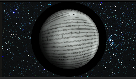

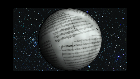

Can I adjust image scale mask? Here is a situation: I have 1 layer with sphere and image mask (circle), 2 layer with background and the same mask as in 1st layer. When I change the scale 1st layer there is black halo around sphere, however when I adjust scale that is perfectly fitted to sphere I loose background on the edges of the screen. Is there any solution?
I use Avenue 7.13

Can you put the BG on layer 1 and the sphere on layer 2?
You could also use a Circle source or vignette as a source in layer 2 and then set the blend mode to mask.

The fastest and simple method was to make a new picture mask with smaller circle.

For the next time I made you a simple plug-in here you go....
Keep the stars on layer one and the moon on layer two and drop in the plugin on layer two that will definitely do the trick.
