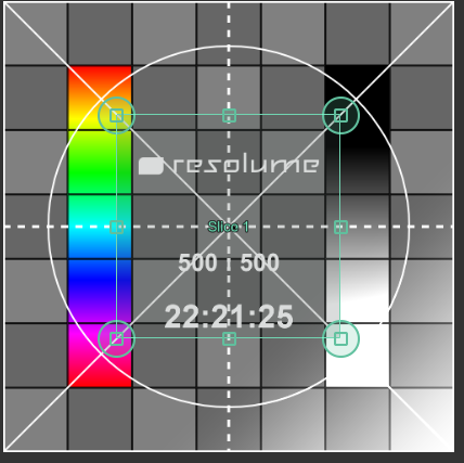

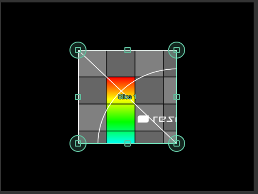

everything works except the output mapping.
in the input window, if I move slice to any position on the screen, the output remains docked at the top left.

Sounds like this machine does not meet the minimum system requirements, I guess it has only an integrated Intel graphics card and no dedicated Nvidia or AMD gfx?
https://resolume.com/support/en/tech-specs
