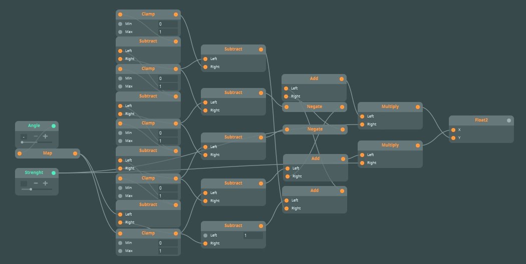

Hey there, what is a nice and clean way to convert from a float (-180/180) to two floats X and Y.
Some effect like UV en Displacment have two Float in, but i like to control them the Angle an Strength independent. I made a way to make it work, but a cleaner way would be nice and more repeatable between patches.
*The last note in the chain is Float2
Angel to Y and X
Angel to Y and X

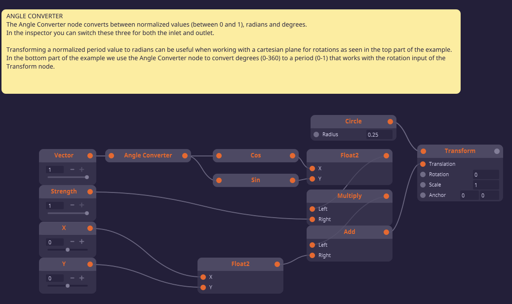

Found a solution in the example from the Angle converter.
The math version, with sin and cos
You can use this to control you vector and strength, i add x and y so you can control the Anchor of the rotation.
But to control a Displacement or UV effect you don't need them.

From version 7.19 there is this "from polar" node this will do the same thing but much easier. Have a look at this patch.

Thanks, that is real clean!
