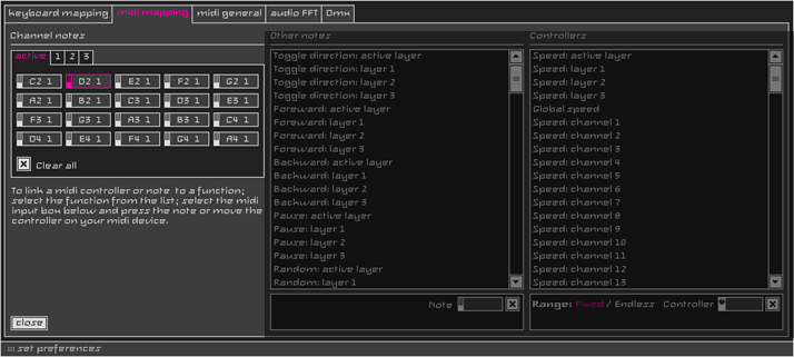

So far the only trouble I have is with the 1234 grid thing of clips, I only seem to be able to control it with the keyboard, not with midi notes.

Basically, my main question is how do I activate a certain clip? Is it just MIDI notes from C1 onwards?

go to midi mapping in the preferences window.
onl the left you see a grid that reprsents the channels and has the caption 'channel notes'. Click on one of the little blocks in the grid to set it to midi learn mode, press a note on your keyboard or send a signal from ableton and voila that note corresponds to the channel you selected.
