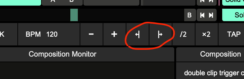

The composition speed slider for timeline playback can be used to speed up or slow down playback. It's the slider on top left with the S on it.
For BPM synced clips, the transport controls has nudge buttons.
Transition time can be set up in the layer transition controls, you can enable that in the View menu.
Setting different transtitions per clip is not possible currently, but you can set up midi or keyboard shortcuts to set the time quickly.
