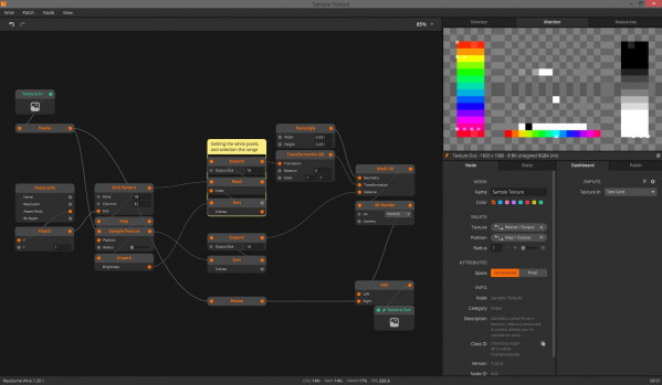

Hey folks,

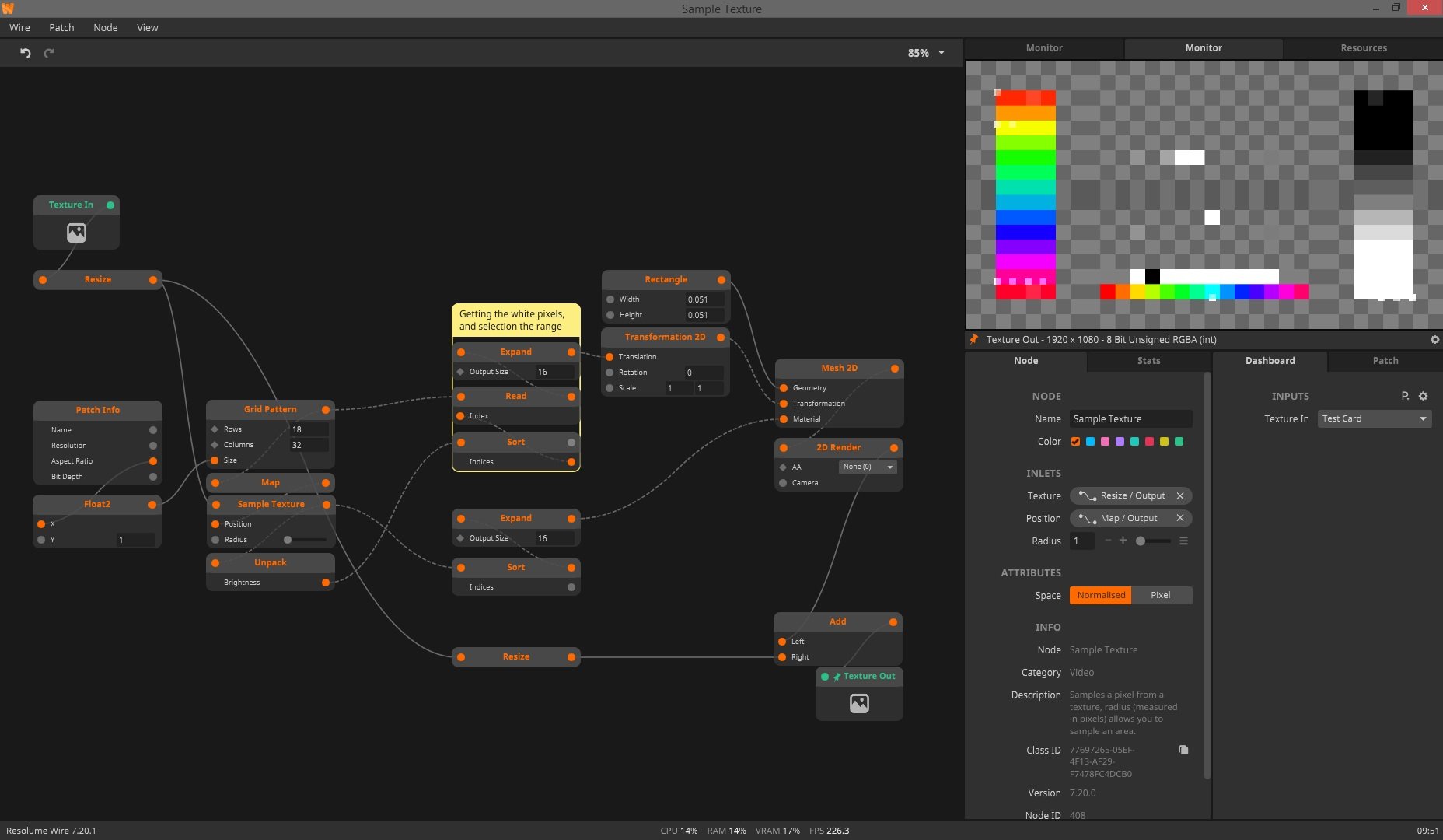

I was playing around with the sample texture node to get the location of white pixels.
In writing this post, i figured out the buggnes that stumped me.
The coordinate system of the Grid note does not correspondent with the normal space of the Sample Texture node.
So i used the map node to correct that.
So here is the working patch instead, have fun dumping memes on you white pixels.
