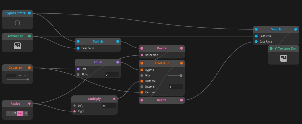

Hey folks,
to keep the fps flowing here are three tips.
- bypass every inactive node (Purple)
- use two Switch to bypass a big group of nodes. The first switch to dumps a empty texture in the sequential nodes. The second bypass the texture to the rest of you patch. (Cyan)
- you do not always need the full resolution/colour depth, to render pretty stuff (blur and sample texture) (Pink)
Have fun!
Optimalisation.wire
(220.21 KiB) Downloaded 2167 times

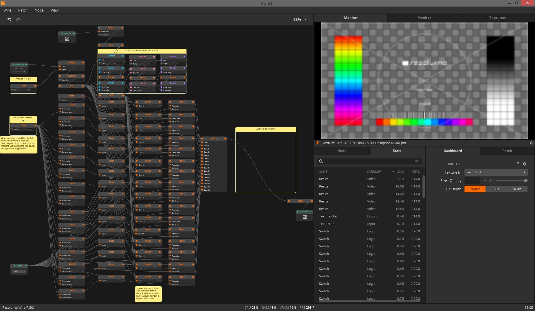

Hi everyone,
i made another patch to speed up render times. This one lets you downsample in 16 discrete steps.
In the patch are a few comments to get you going.
(bug?)
The step size that handles the resizing steps is now 1.175, and it also works at 1.125, other steps need to be found.
Other steps give clipped video when using effects after them, this stops when changing the bit depth, but returns when changing the size-quality.
I haven not test this patch at strange resolutions.
Downsampling also affects al the relative value, so small values at 1920px are big at 240px.
Have Fun!
Switch.wire
(344.01 KiB) Downloaded 1712 times
