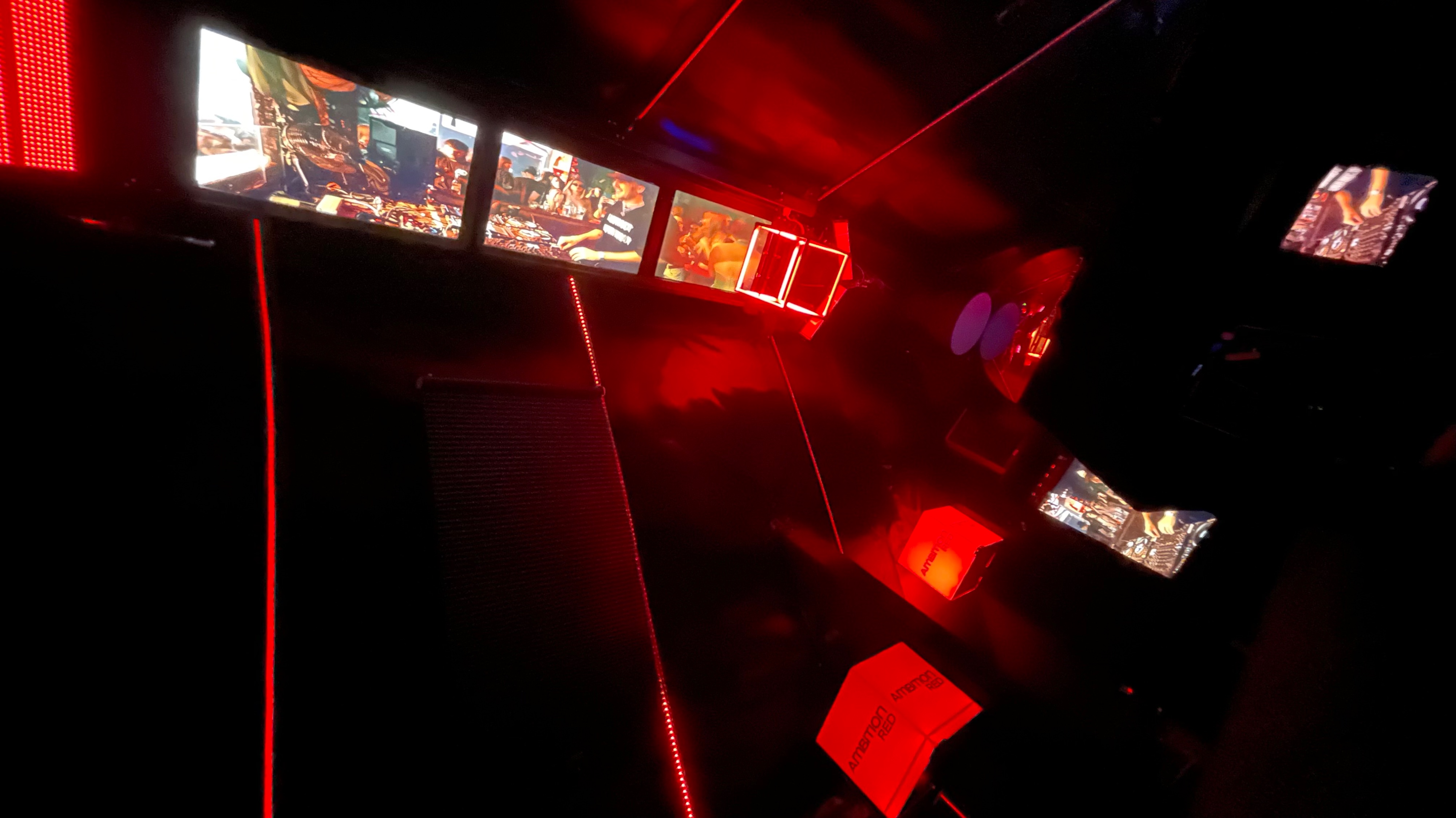

In short I try to connect led panels as hobby vi to Resolume to replace normal screens.
as a note I am just an hobby VJ so I am willing to spend to much money for this, but not go full in. The cheapest to get a mid quality solution is my goal.
Right now I am using Resolume with 3 screens and and matrix splitter to get the output on my ceiling as seen in the picture. While the screens were a cheap solution to learn Resolume, the outcome is ok but due the angle not enough visible.

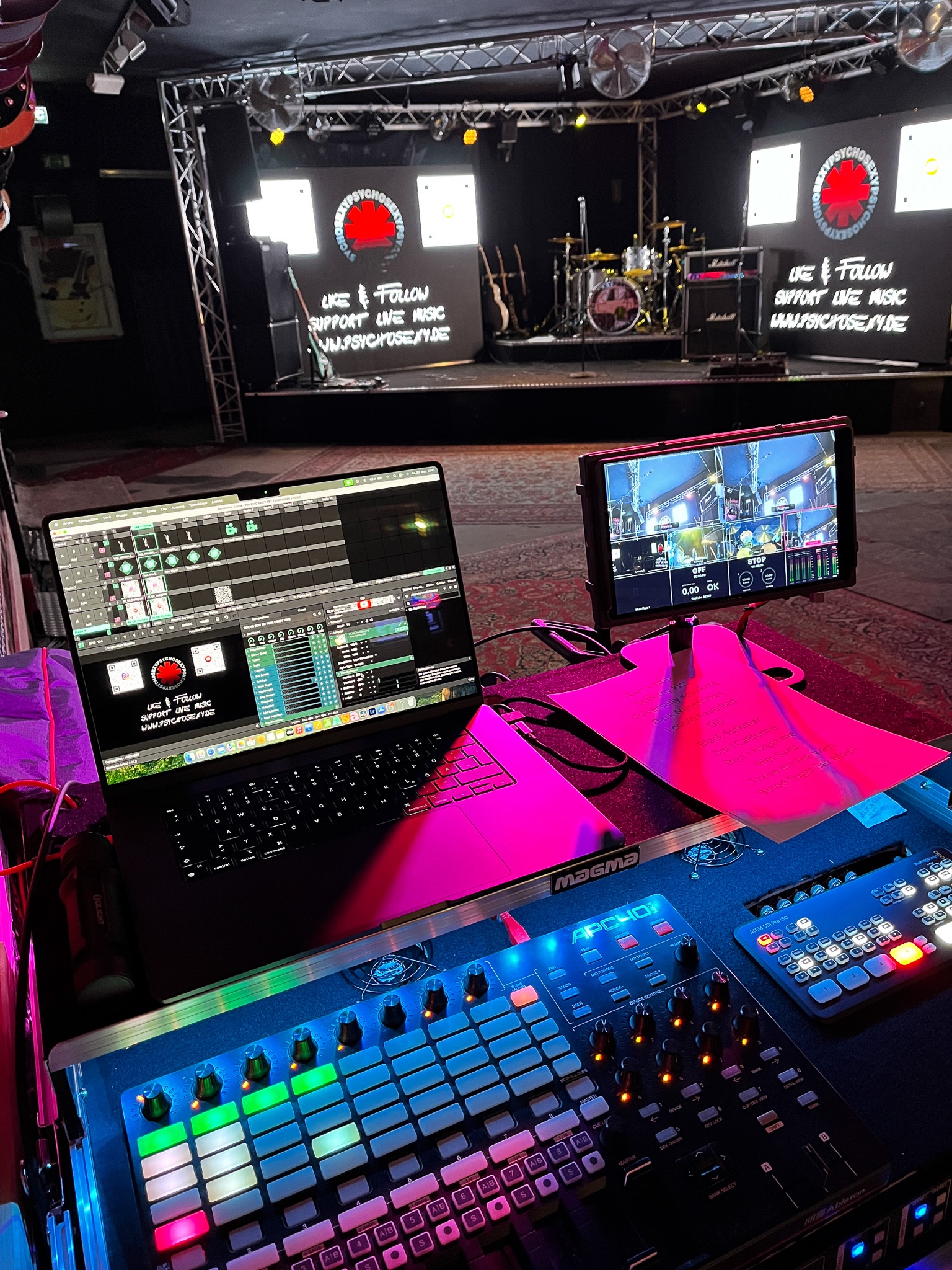

Hey Milian,
we use Novastar stuff in our LiveBand. Our LED-Wall (5,0x2,5m) is build by 0,5x1,0m panels and each panel exists out of 0,25x0,25m "mini-panels". Everything is running with 3,91mm Pixlpitch.
We use the Novastar VX400s-N LED Controller with 4 LAN Ports.
Our Controller works only with Novastar Receiving Cards. Novastar makes that clear on their homepage.
Tipps:
When calibrating the novastar controller with LCT make sure your wiring. Otherwise you have to reset the receiving cards. The Novastar software is not that easy, the MAC OS Version (Smart LCT) is much easier, but will not work with all controllers.
Your topology is right.
We use the advanced output only when we re running a divided LED Wall.
Regards Rene
