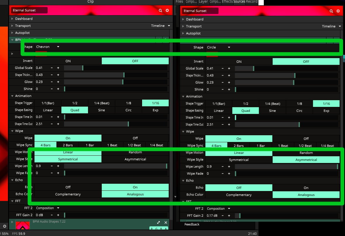

Here's the changes applied to one of the clips in Resolume. The second one shows the setting of the original preset
I must add that this is not even related to the preset with the changed name.

This problem is actually pretty bad.
Even changing the thumbnail for the Wire patch from Wire will change the settings of clips already in Resolume.

cat
Posts: 184
Re: Strange Wire to Resolume behaviour.
Post by cat »
Is it the patch just resetting to default(last saved values) if you apply the preset does it look the same as the previously? (ie the preset doesn't get re-loaded on update)
