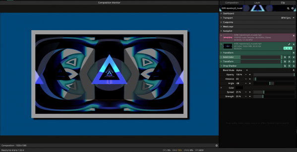

Use layer or clip transform to make the image smaller, and add Solid color effect with show image enabled afer transform.

This is a nice step and I tried it but it only solves partially the question: the solid colour fills the remaining of the layer to the edges of the display, no matter the size of the layer; the solid colour now covers completely the lower (background) layer. I wonder how could I confine the solid colour to a thinner (or thicker) band around the layer's edge so to reveal the background layer.

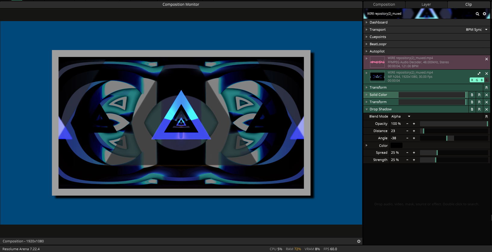

Put a second transform after the solid colour and resize with that.
It worked! Thanks both for the advice!
