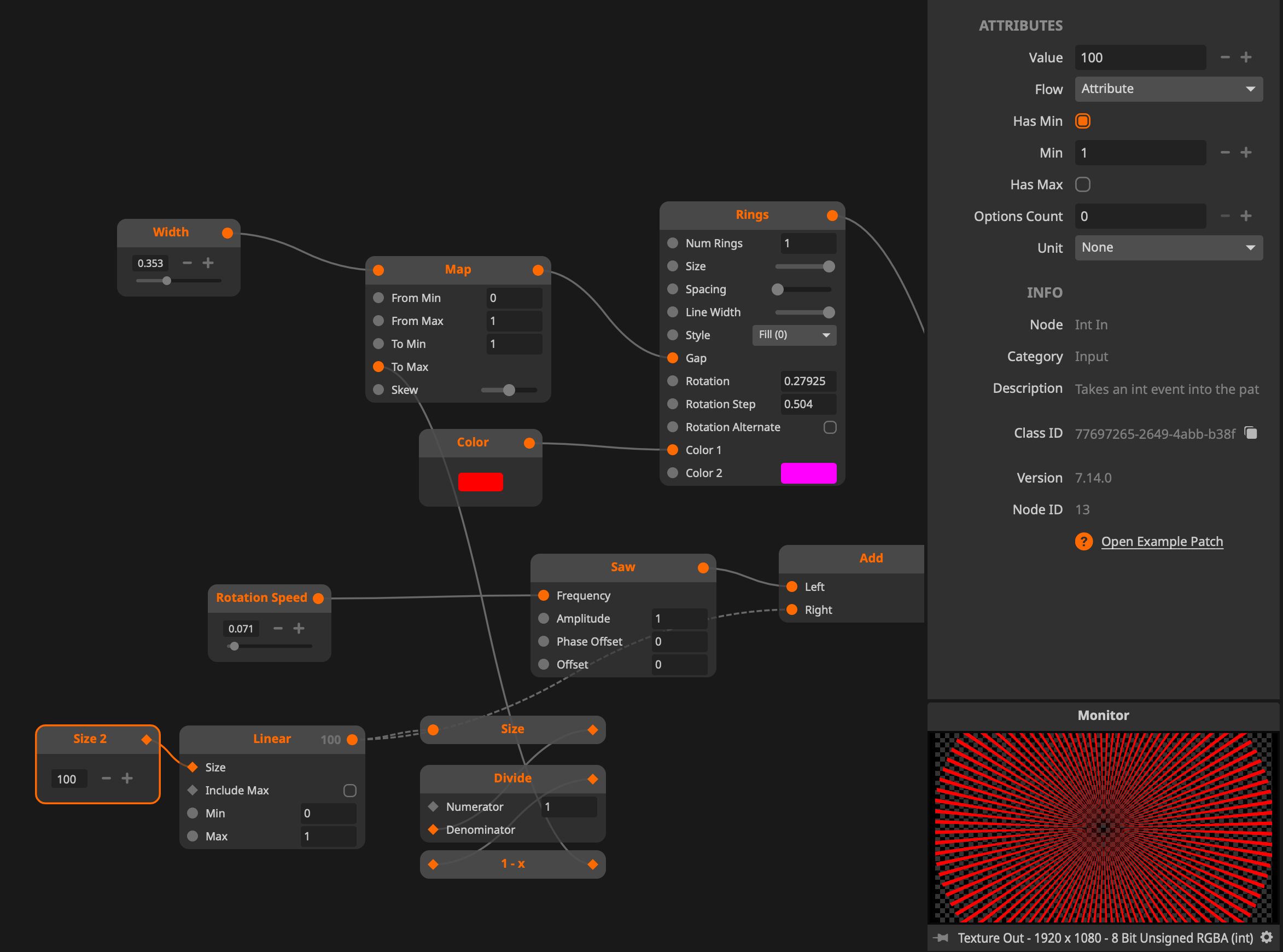

You can change the size via an attribute, but this is not realtime, so not really dynamic.
We're looking into dynamic instancing and this will come with some future update, but can't give any ETA at this stage.

You can also use the size of the linear to calculate the ray width,
something like this: This could be a bit easier for the user to keep the gaps

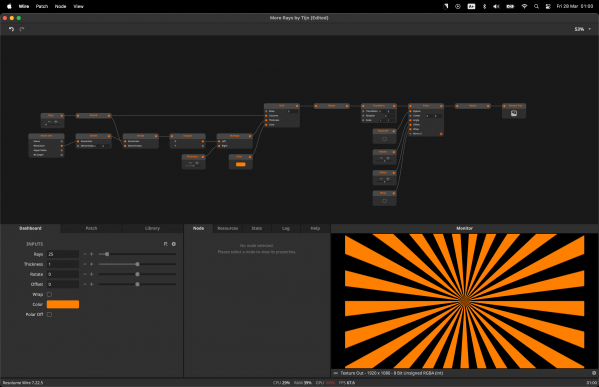

Well, I think in this case, you could do it differently... If you use a grid node, you can make it dynamic. Take a look at this patch. The result is the same, but with a very different approach.
have fun... hope it helps you out.
