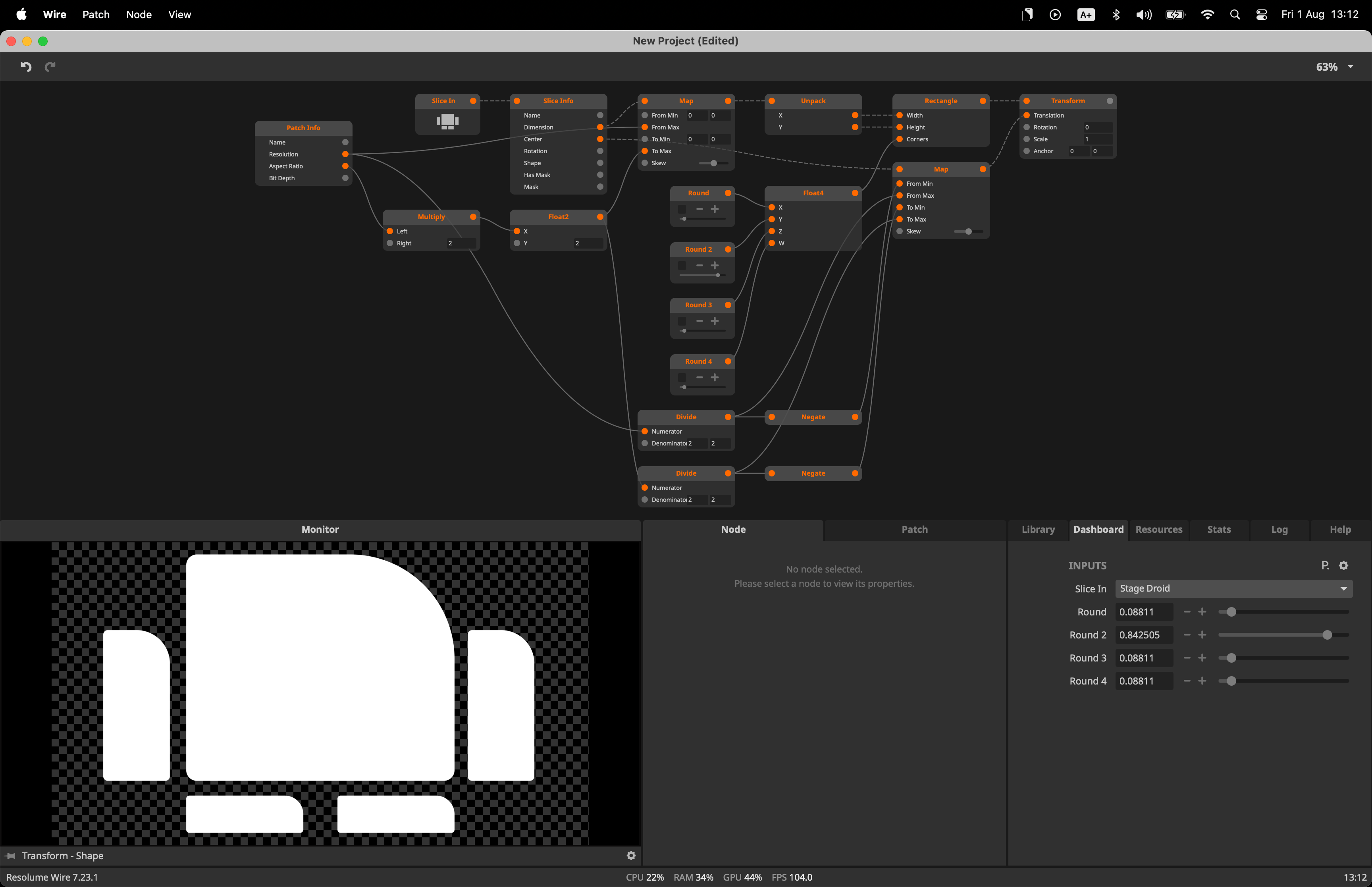

How to make a custom slice into an arc shape and freely control its four corners?

check out this subject viewtopic.php?t=30188 I think that will help you out

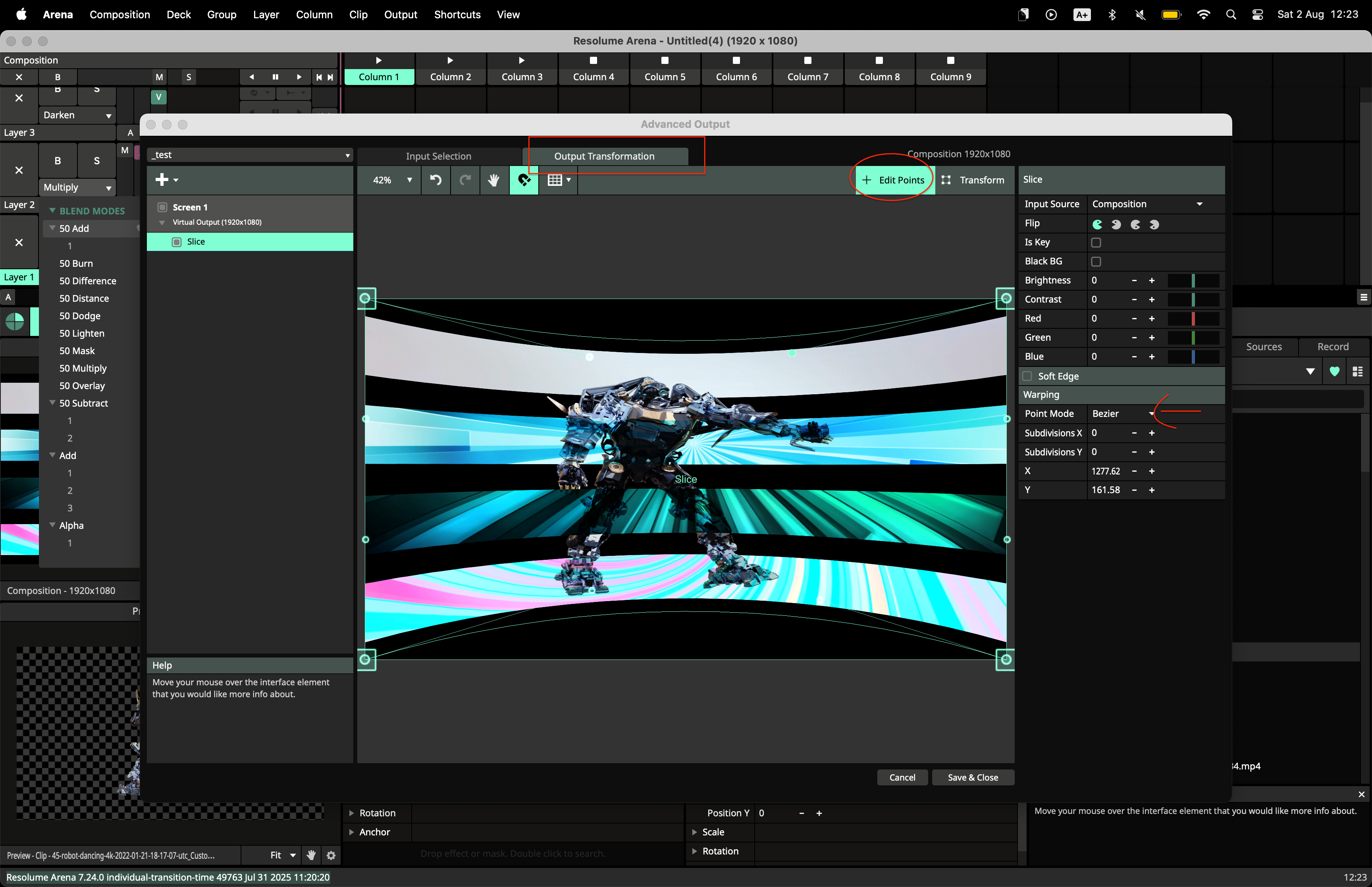

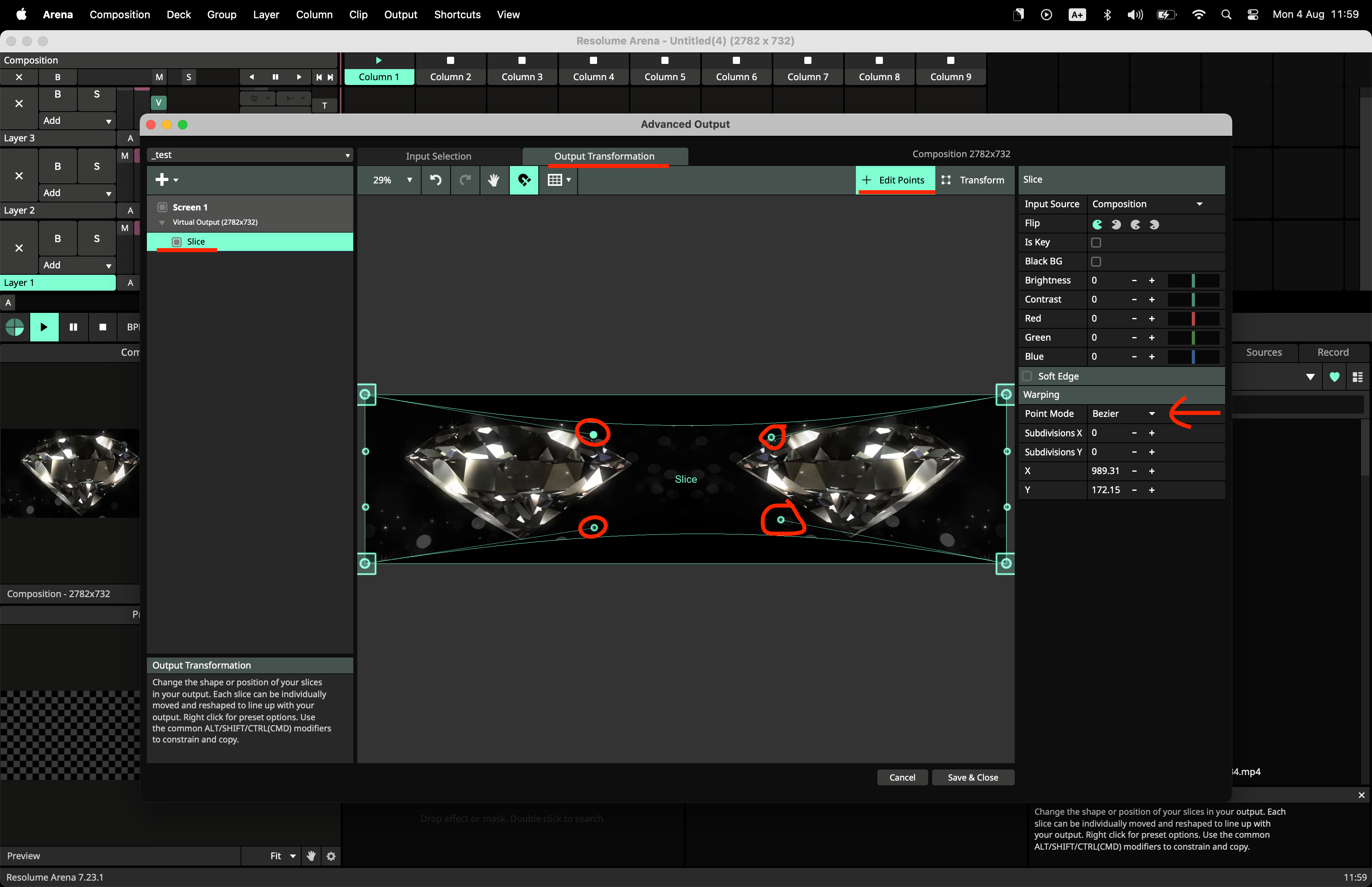

Sorry, I completely misunderstood what you meant. I think that this is something you don't need to do in wire, but you can do that in the advanced output from Arena. Look at the included picture, you can see it's really easy to change the shape of your output. This is something that's not easily done in Wire. In wire you would just make your content or generator or something and Arena is the one that make sure it will fit on your screen correctly.

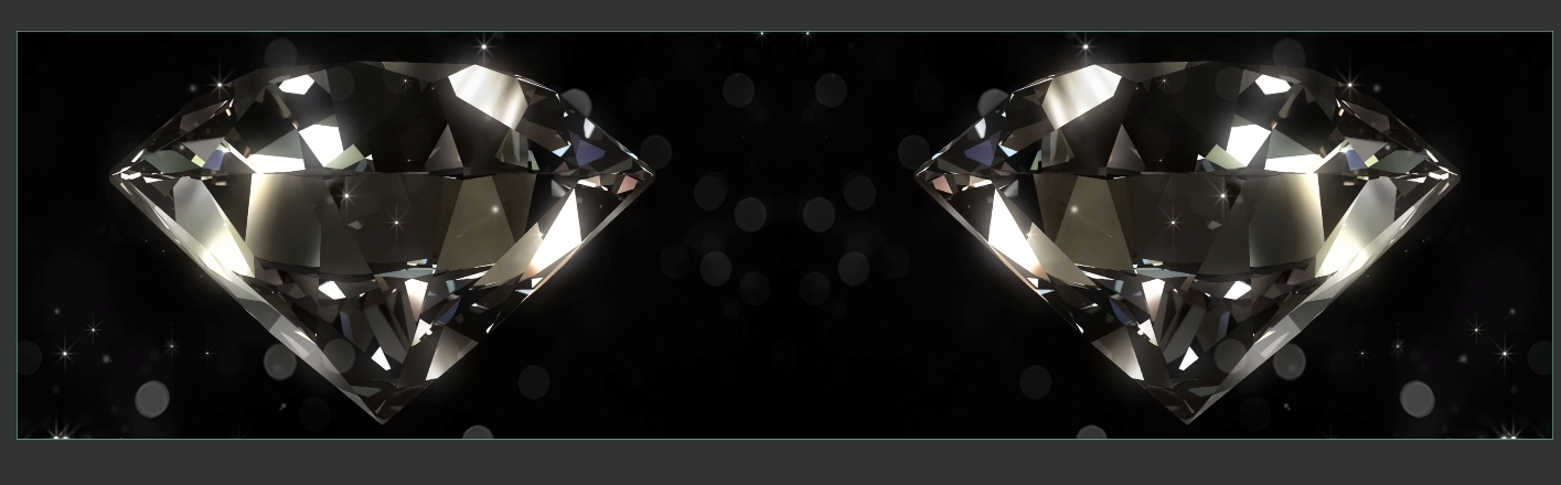

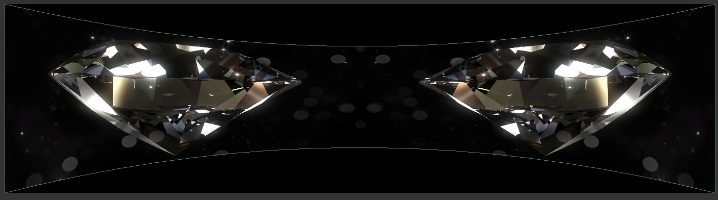

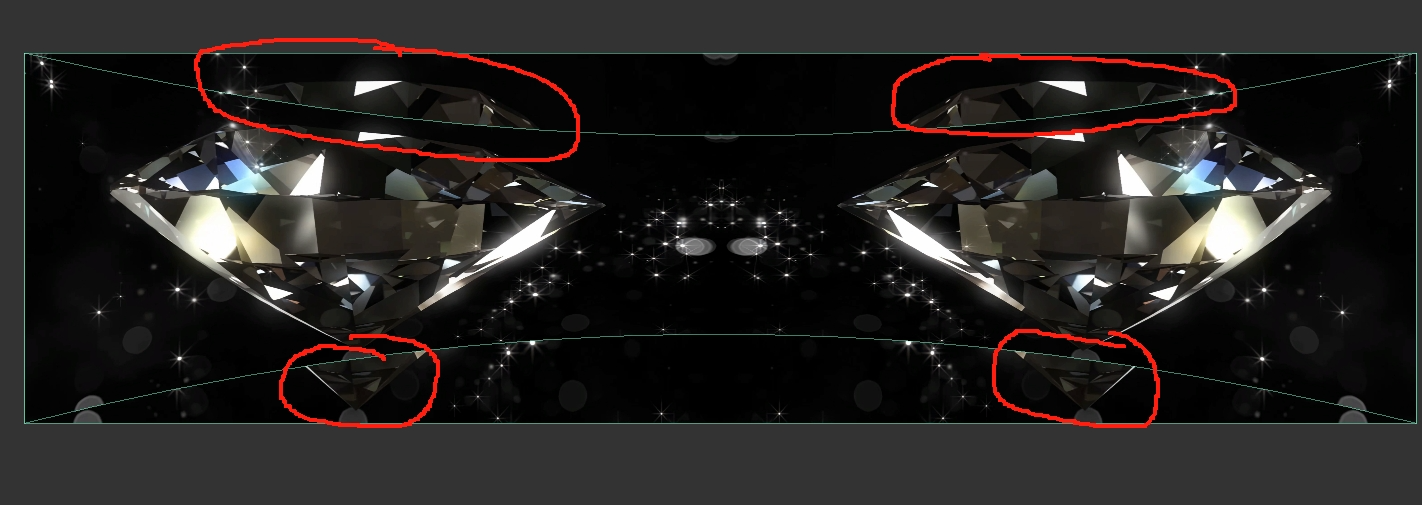

It's okay, maybe I didn't express myself clearly.If I change the output, it will cause deformation and stretching. I need a 1:1 curved screen material without stretching. I hope the output can also achieve the curved screen effect in the picture, the output is the same as the input and not stretched, just want to create a pseudo 3D effect, or realize the curved screen effect in Arena! Is there a way to achieve this in Arena?

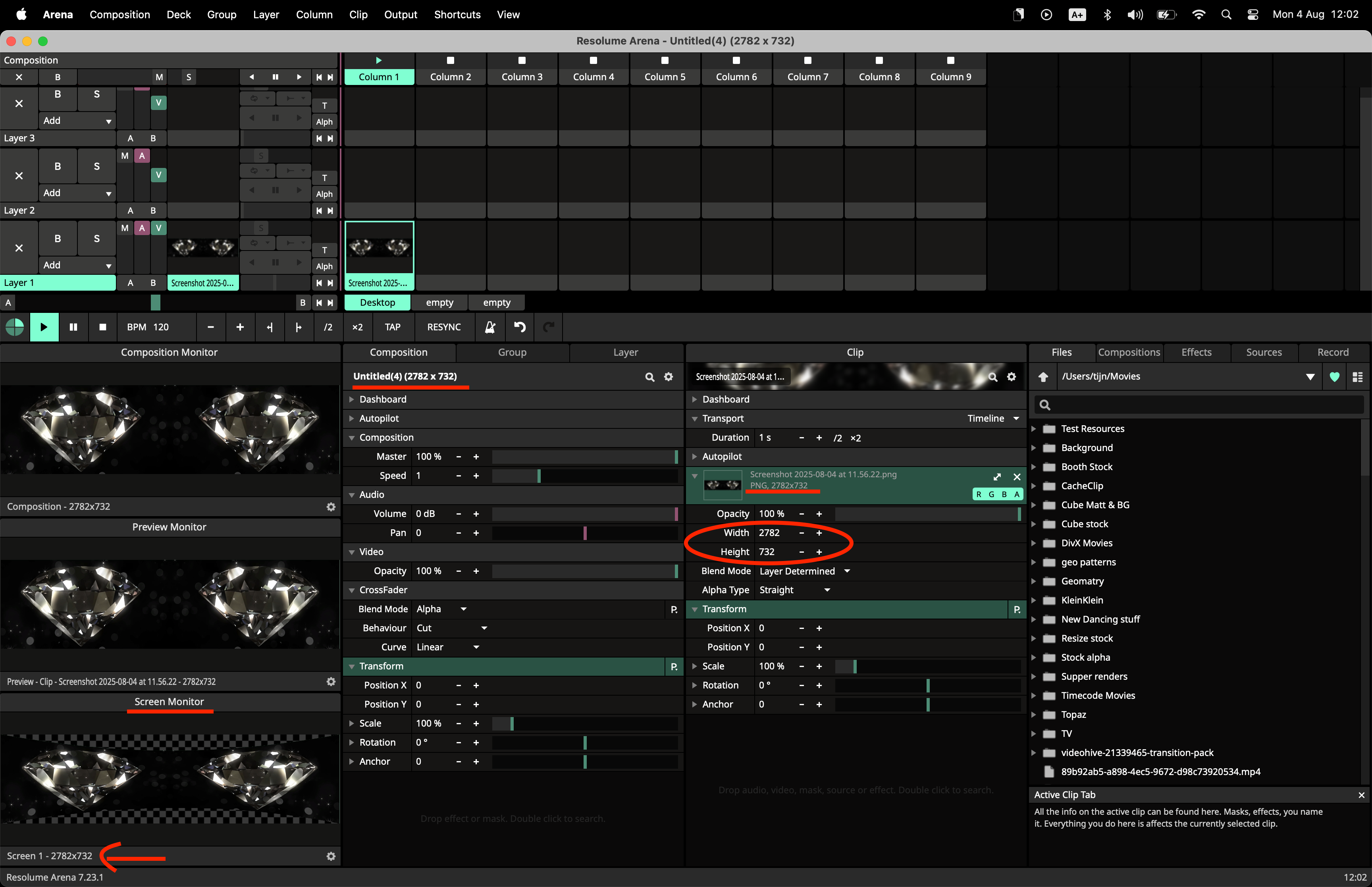

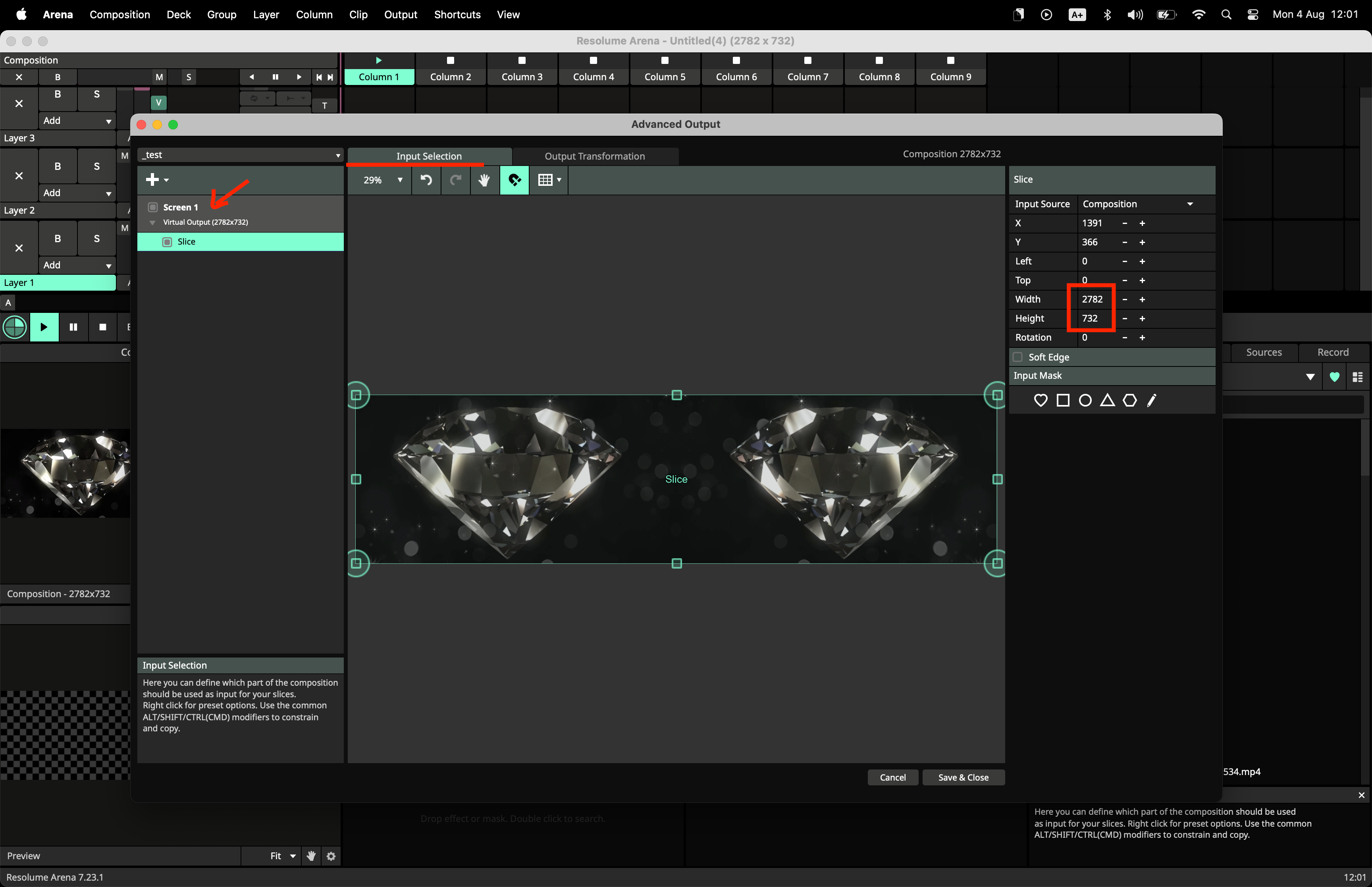

ok i've copied your image. that gives me a composition for the example of 2782x732. So i change my composition to that size. in the Advanced output make one screen and one slice. Make sure they have the same resolution as the composition, then go to the output tap, select "edit points", on the right side change the piont mode from linear to bezier. Now, all corners will get these extra bezier points that you can pick up so you can transform your output to fit your physical screen.. thats it you can now still play all you content "normally" only the output will be "warped" to fit you screen.
hope that helps
