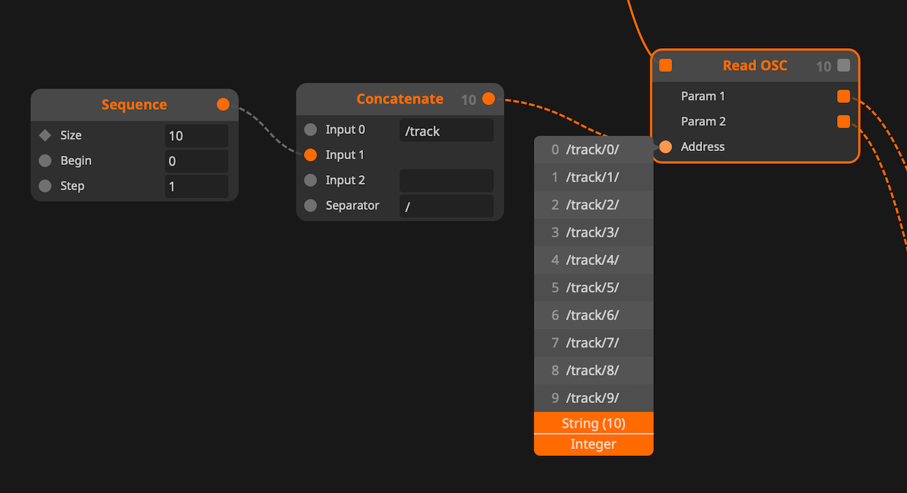

Instancing is great. ... but hard with incoming data.
Included a simple patch where incoming data is moving two simple circles on the screen.
What if the incoming data grows to more items, then instancing would be the way to go.
OSC data is
/track/0/ 45 56
/track/1/ 56 3
/track/2/ 10 67
and so on... the 0 to 2 should control a certain index. How?

Re: OSC data controlling instances
@zoltan sorry, I forgot to thank you, THANK YOU!
this saves a us a lot of time
Just report a crash when changing the parameter count, but also wonder how to get individual instance of the trigger output, get trigger 3 or 4 from the collection of triggers
You can use the Read node to pull an item from a collection by index number.
