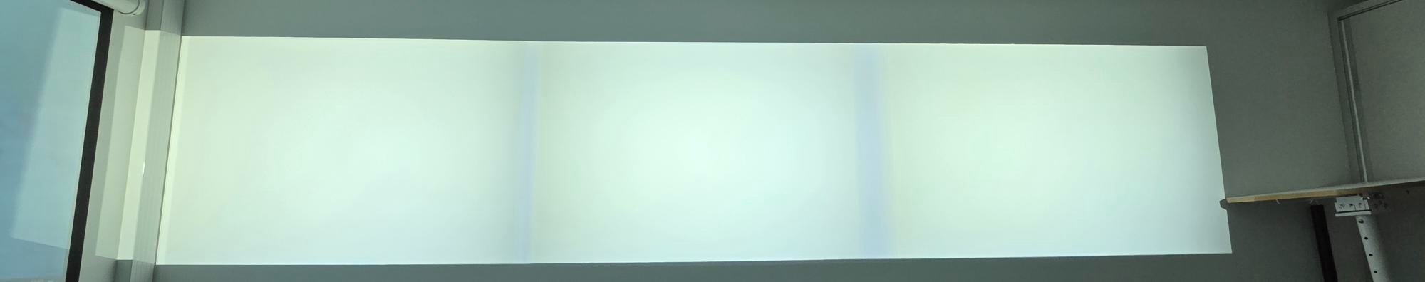

I'm having trouble using soft edge I can't get a satisfactory result where the seam between the screens isn't visible. I'm using 3 projectors for an experiment at my company with a 5760x1080 composition.

are dynamic contrast and image enhancements disabled in the projectors?
